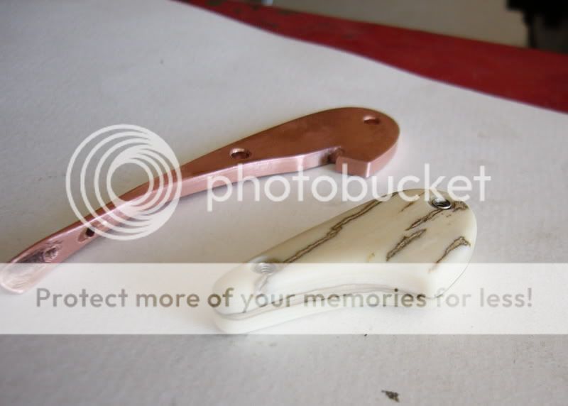

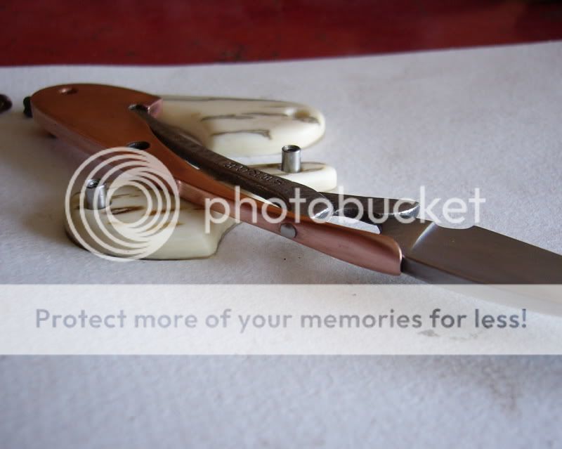

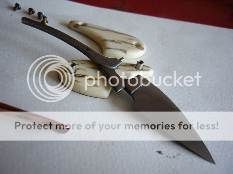

I now pick out the handle material, mammoth ivory.
Holes drilled.
Ivory trimmed.

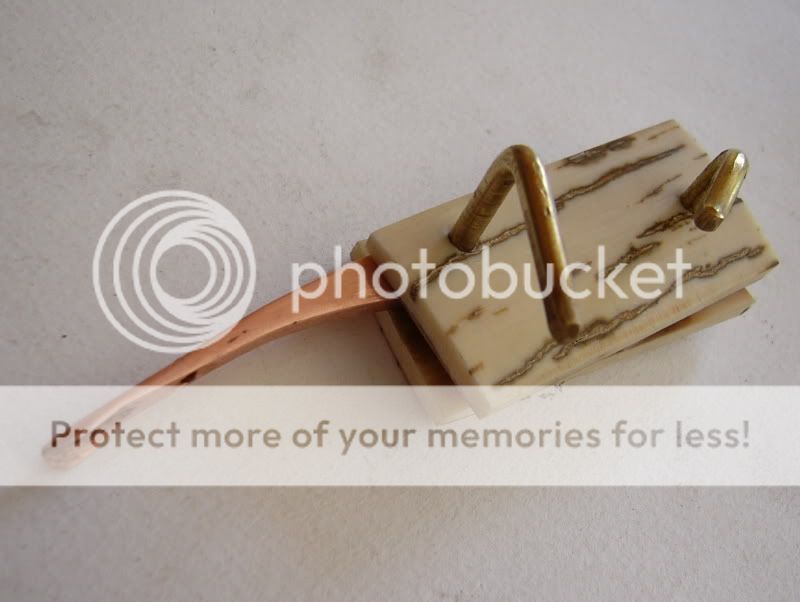

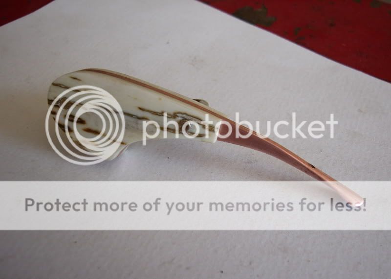

I begin to contour the ivory.
Ivory is sanded to 600 grit.

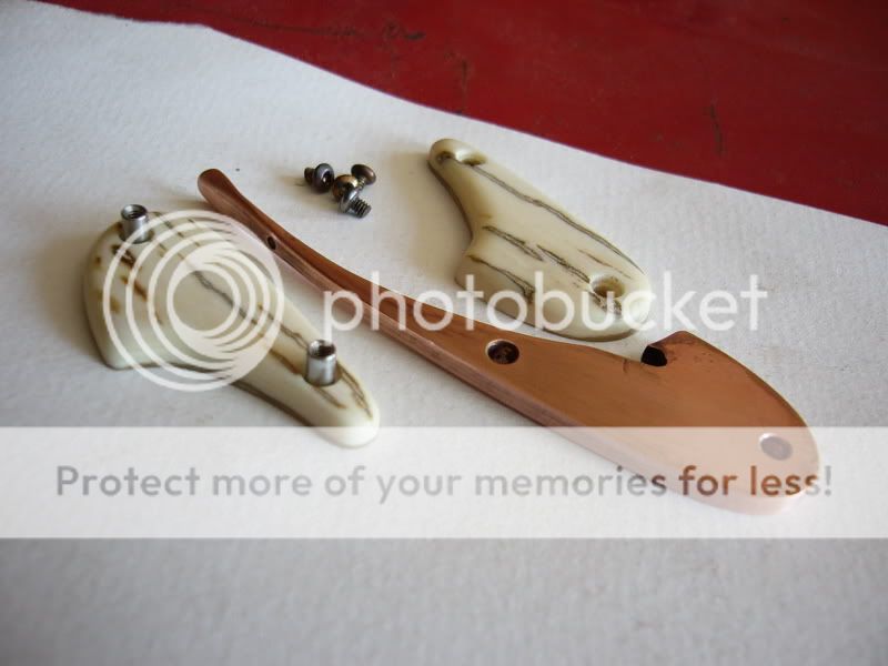

Top handle piece ready for assembly.

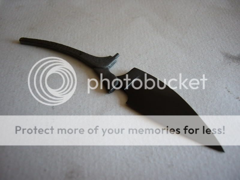

Back to finishing the blade, etched.
And buffed (blade is dark because of poor lighting).

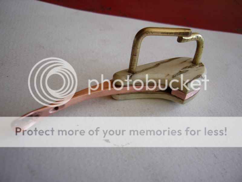

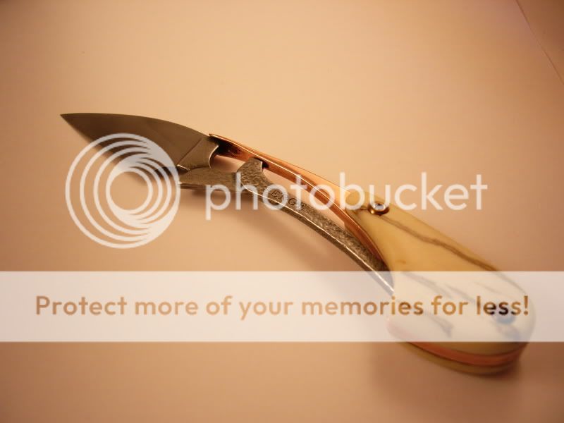

The "rod" has been trimmed and peined over the copper to hold the knife together. Along with the heavy friction fit of the tang of the blade, it's held very firmly together.

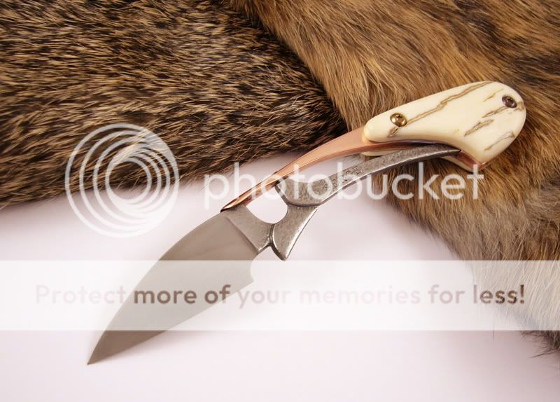

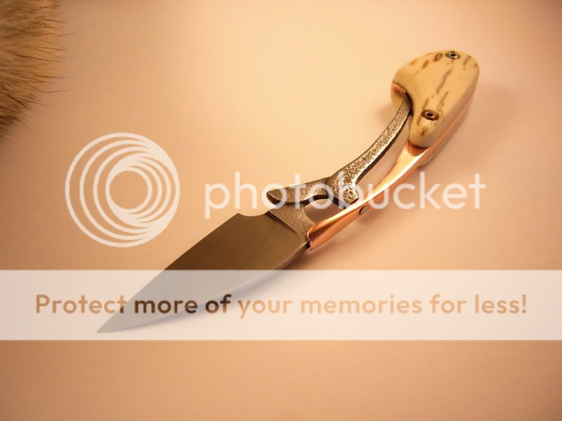

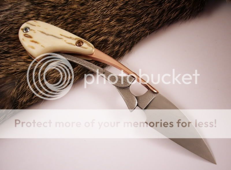

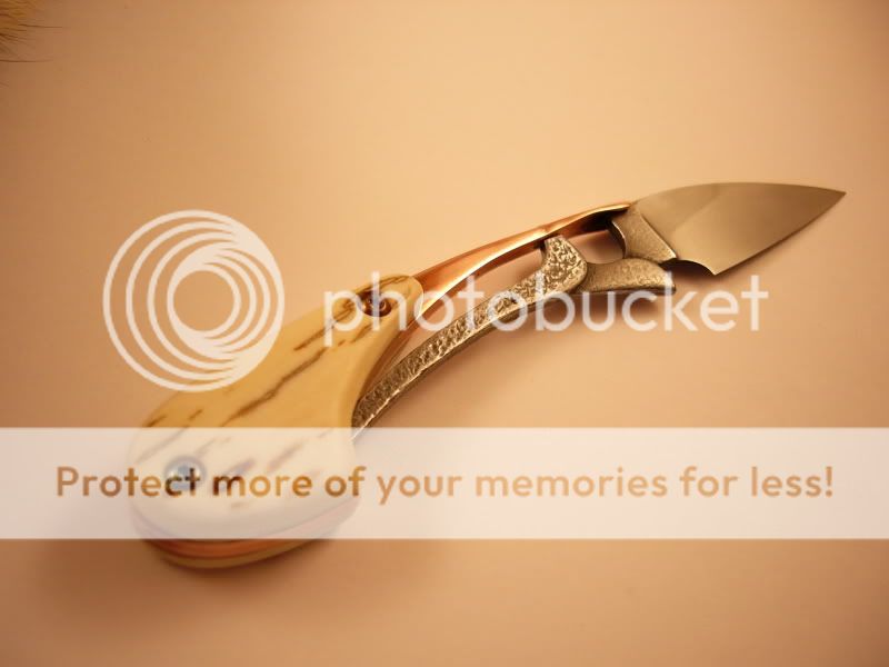

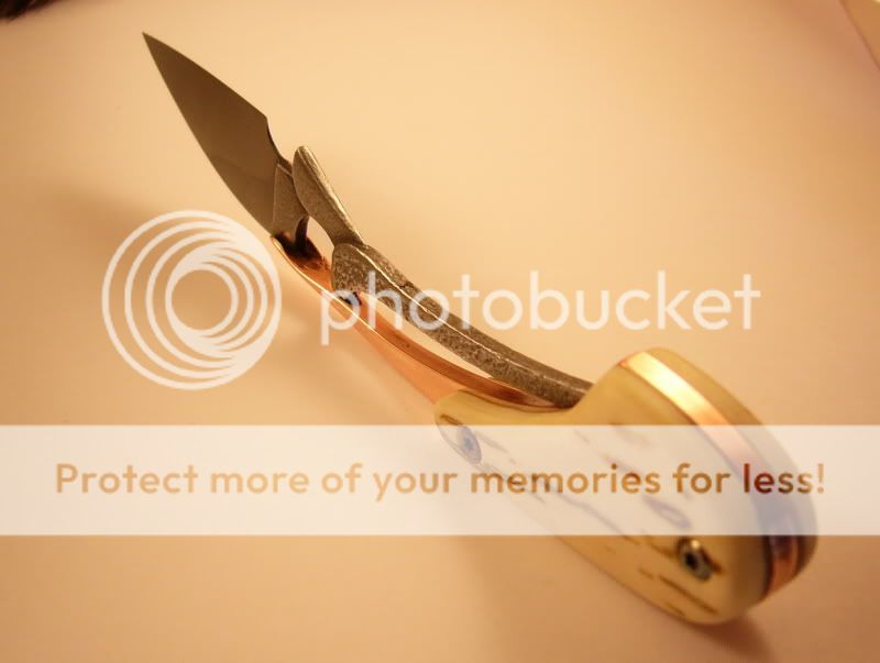

After alot of final polishing, fitting and cleaning up the knife is done!
I hope you guys enjoyed watching this knife being made, as for me I'm VERY happy its finally done. I will be making a stand for this one tomorrow and will post it up here when it's done. The handle screws still need to be heat colored again to a bronze hue. Thanks for looking!
