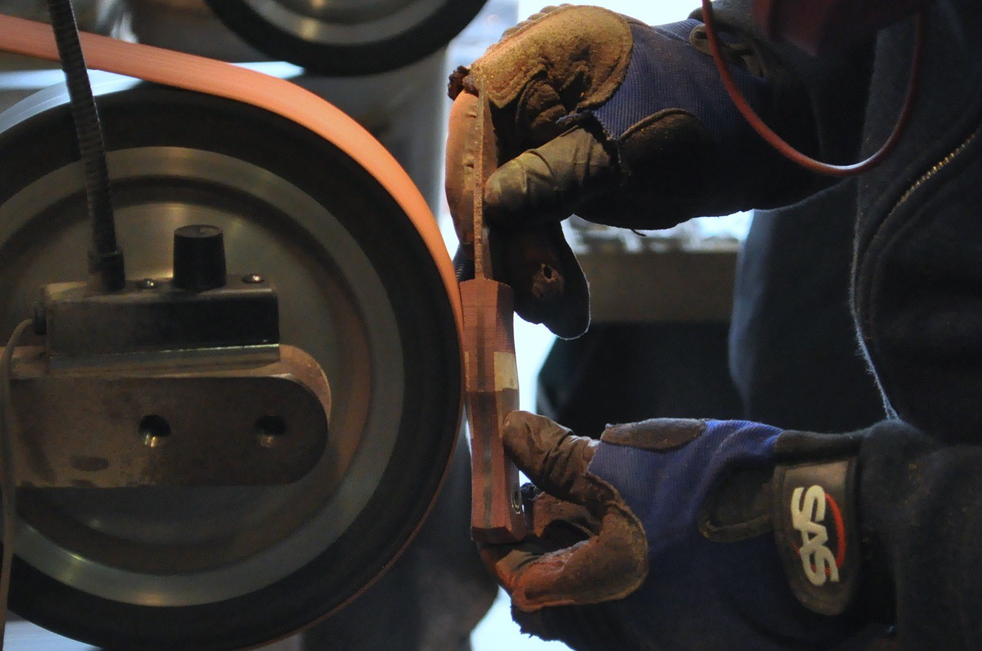

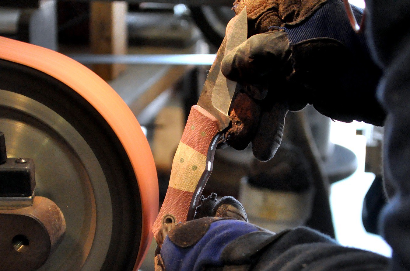

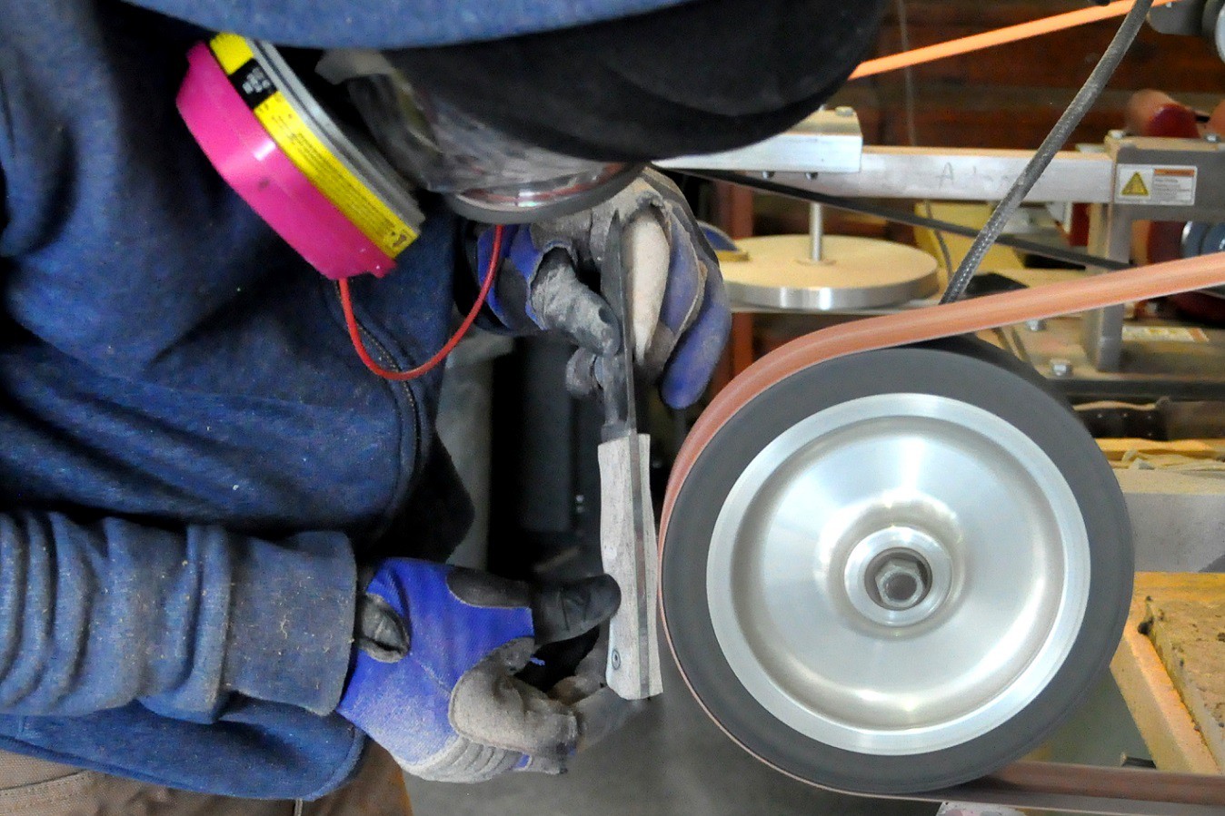

I think this article happened during my sabatical from BF. Thought y'all might like to hear my thoughts and reasons WRT handle shaping.
Could you also talk a little about how you sand and finish the handles. I still struggle with the final stages to get them clean and even. Turning me on to the Pops superwheels helped a whole lot, but I'm still missing something. Pops superwheels.
Thanks!
-- Blaine
WRT micartas, any dry or fuzzy section means you left scratches. Be sure the color and texture are even before progressing. I use scalloped j flex belts up to 600. Then I hand sand at 400 and 600. Then onto the super wheel (ultra fine) and white and pink buff. When you buff start w blade parallel to ground, the turn it vertical and go over that handle again with each buffing compound.
I guess I just need to spend more time sanding, then more time on the wheels, and then buff, buff, buff. - Or maybe do more birchbark handles...
Thanks for the info.

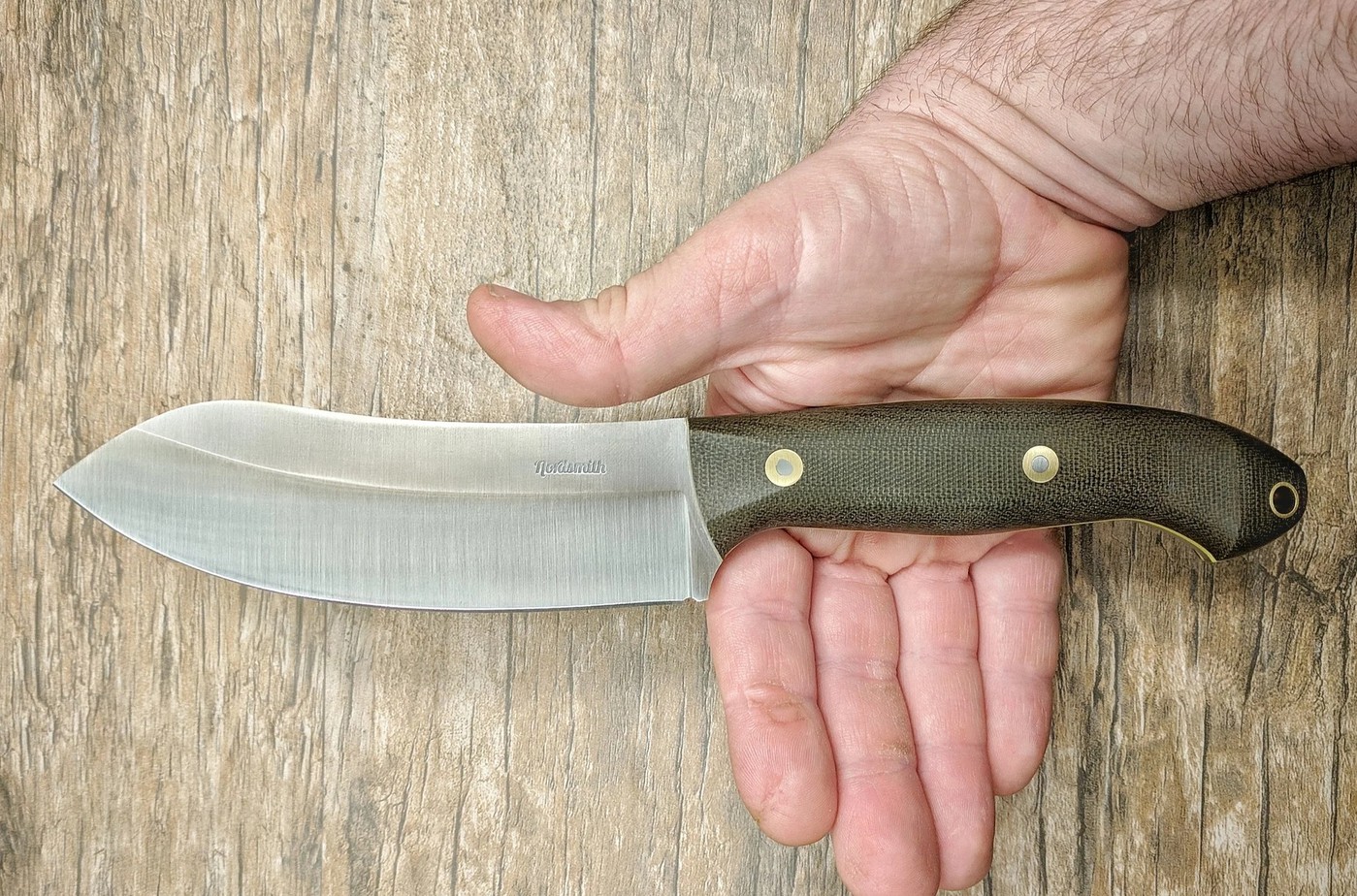

From an experienced buyer’s perspective, I have a slightly more nuanced opinion on handle shapes that work for me in both a practical and aesthetic sense.
I totally get your dislike of rounded broomstick shaped handles that contribute nothing in the way of grip security, indexing, or aesthetic beauty. What it does provide on the positive side is more usable handle length and no hot spots.
What I dislike are pommel shapes designed primarily for aesthetic distinctiveness when it either limits usable handle length on the bottom or incorporates sharp edges or points on the pommel that poke me in the side while actively hiking on uneven terrain.
Usable handle length for a comfortable four finger grip is my top priority when considering buying a knife. I made that point ten years ago when I made that post here showing that the Patch, with a more simple pommel shape, has more usable handle length than the Bushcrafter Jr. with a birds beak pommel despite similar overall length. My opinion of the importance of this feature has only gotten stronger since then.

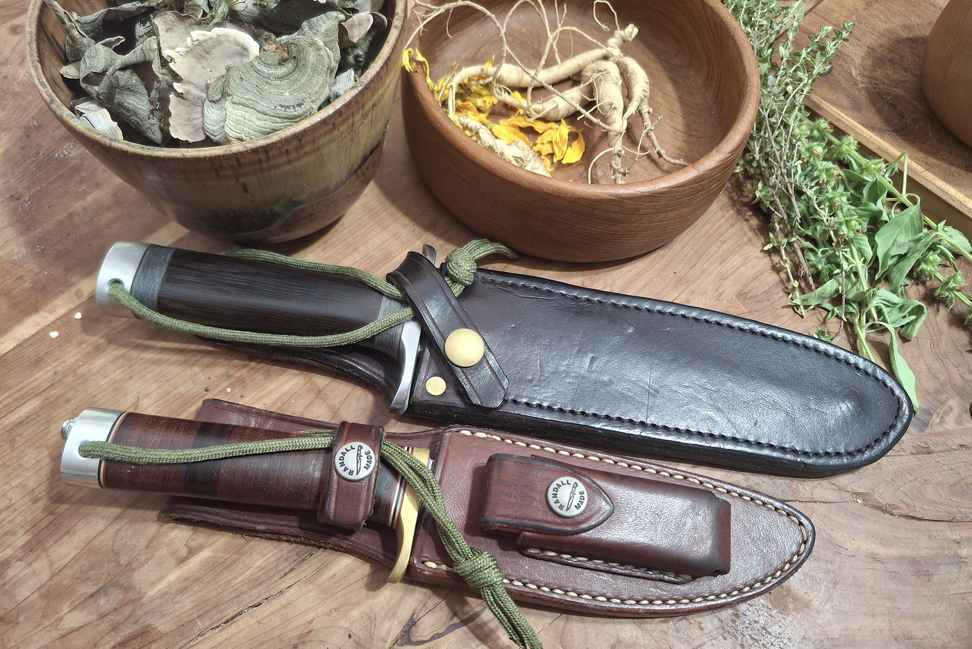

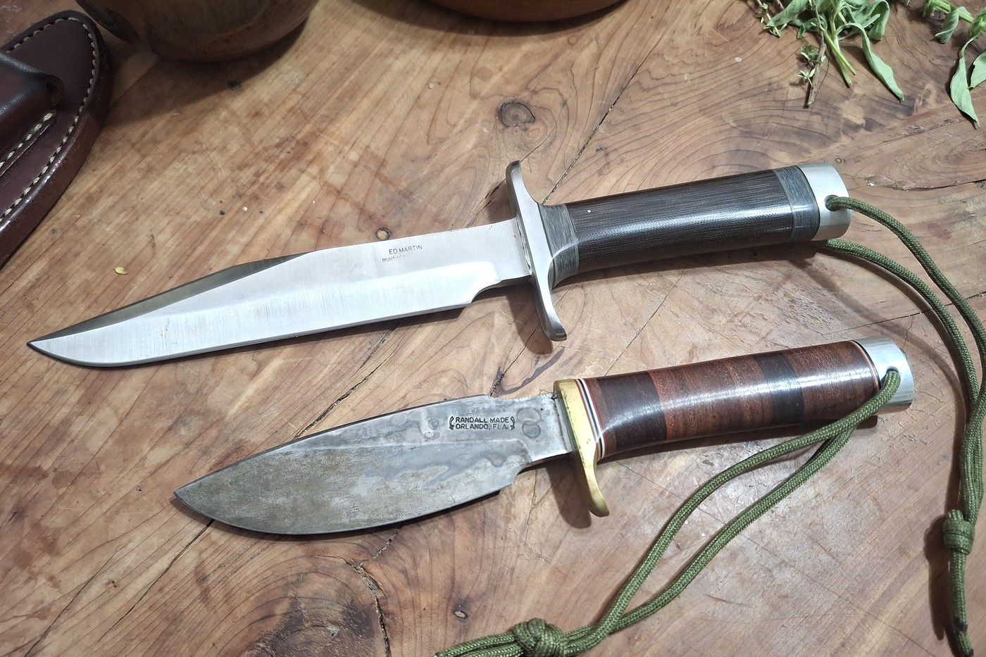

I guess I'm the odd guy out here when it comes to handles. I can deal with almost any style of pommel as long as it clears my hand on a larger knife and isn't painful to use.
After years of T&E for TK Magazine, and years of R&D for RMJ Tactical and TOPS Knives, ... and testing stuff at Ethan's, I am far more concerned with the execution of the guard end of the handle than the pommel end. I just can't deal with an exposed entegral guard that my forefinger rubs on when doing tip work, or that my pinkie impacts in overhand thrusts.
But then I'm also not a "Bushcrafter" per se, I'm into fieldcraft and have mostly studied it from a soldier's perspective since my dad started training me to live off the land when I was 9 and 10, and started training me in other military type maneuvers and endeavors from 11-13 when he had an accident at work that ended our training. I'm also not overly fond of multi-fit or universal fit pouch sheaths. Another reason I like guards is that I prefer sheaths with retention made specifically for the knife. Either with retention straps or that snap in, for the knives I field in deeper darker places.
The two knives I field the most these days are a Randall #11-5. and an EMK Ranger, heavily influenced by the Randall #14. I carry Ed''s Ranger more than any lately since I'm usually in some pretty deep woods for a while and never know what world I'll come out in. A lot of crazy stuff going on around here regarding trafficking.
