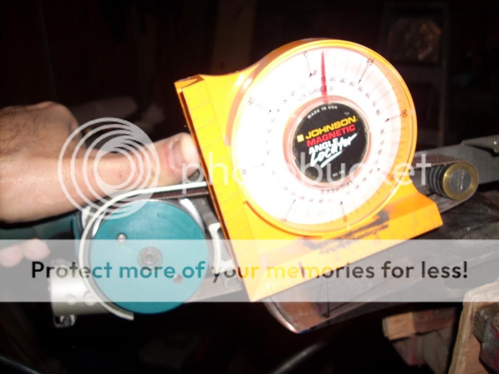

Marking the guide hole.I use the Measurement from the toe for both sides.
Making sure the hole is in the right spot. Should follow edge.
not done Yet.
Dude, it looks like you're plotting hyperspace jumps! those are gonna come out very cool. What grit are you using on those nifty belt sanders?
Primary 12 per side(Might go to 10) , Rolled edge 17 per side, Main face 8 per side. Needs a final polish and hone the edges.

Very cool, man! Keep us posted on how it comes along. And tell us more about your little jig and grinding arrangement! Very interesting, as well as that edge guide plate thingy.

Would love to get my hands on one of those forest service sharpening guides.

Would love to get my hands on one of those forest service sharpening guides. Not sure if GSA still has them(Will check),I have had that one for years.

I found them in the GSA catalog. Just not sure how to get ahold of them???!! Minimum order of 10 it looks like.
I found the gauge. Did a Google search for it. It was $30+ ea. No returns or exchanges. I'm thinking NOT!
The handtool sharpening gauge is available from the General Services Administration, item number: NSN 5210-01-324-2776, NFES 0510.

where did you get the bevel guide?? i don't know that i've ever seen one.

Bevel guide is US Forest Service issue.
