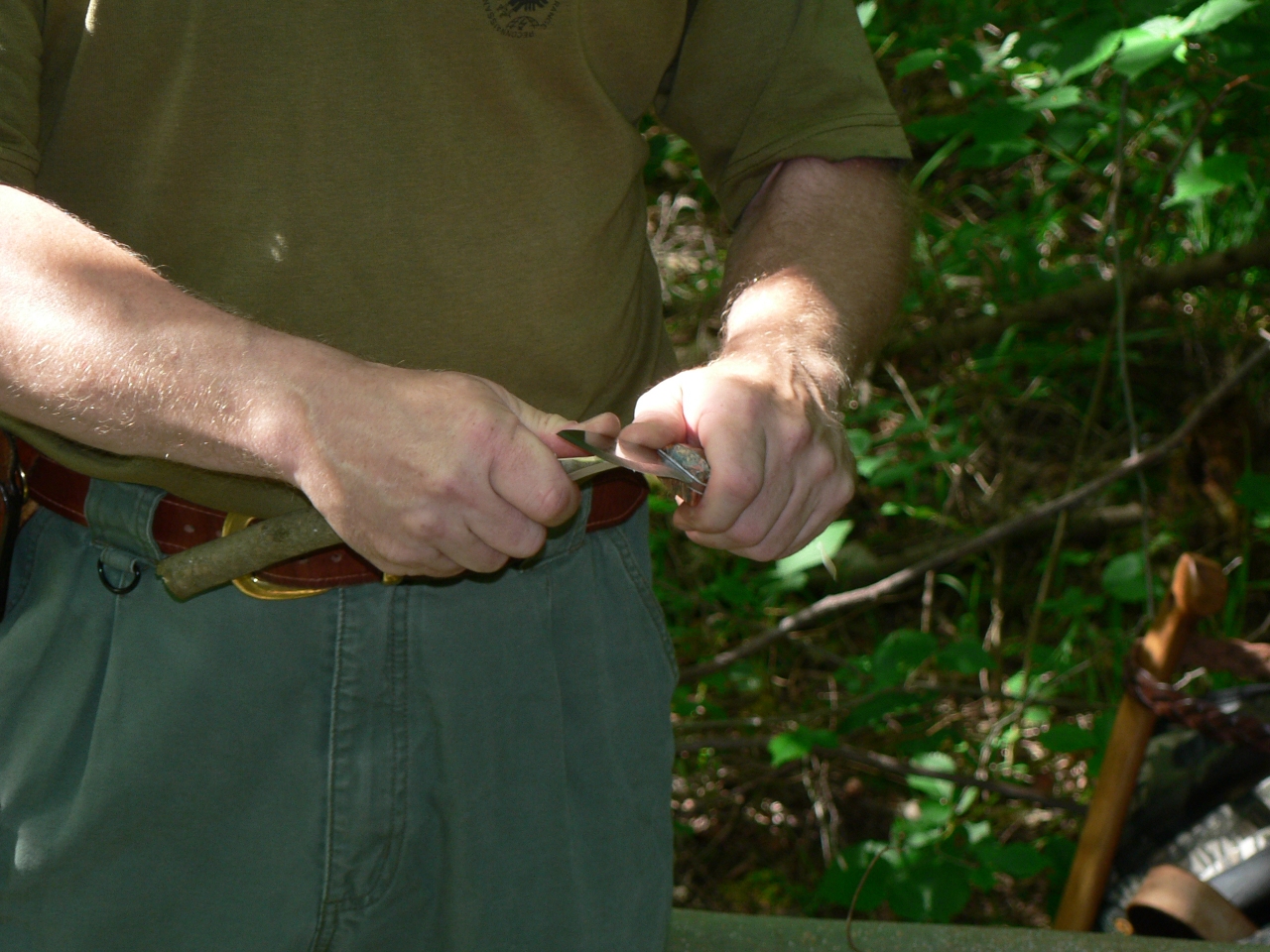

The first job was to fell an ash tree about 4-5 inches in diameter (with permission of course!) which was achieved using the saw. Next a wooden 'spud' or chisel was carved to hep remove the bark. This picture shows Steve Charlton the instructor using his Bernie Garland knife to carve the spud (I used my CR):

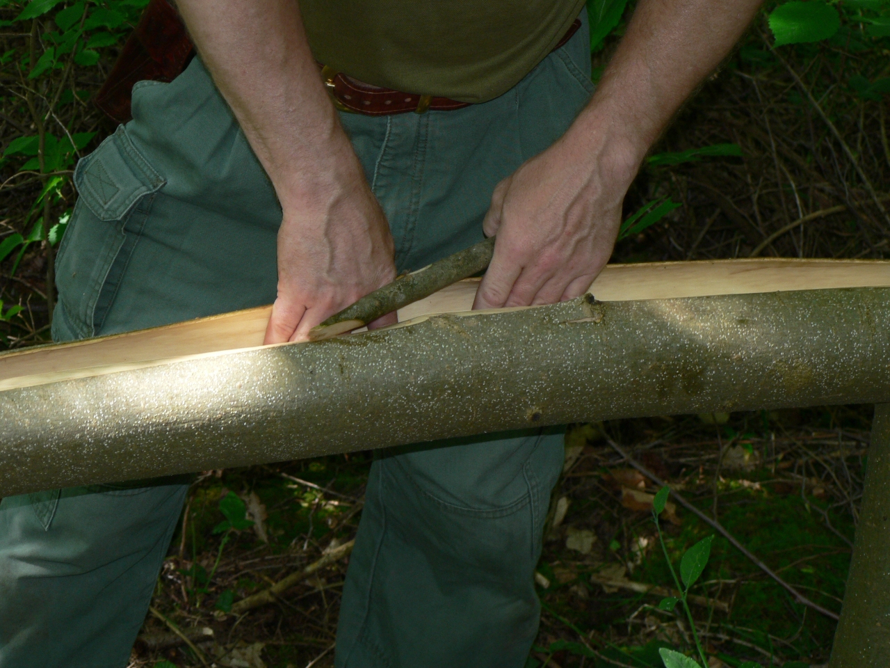

The spud was then used to remove the bark, along with the fingers!

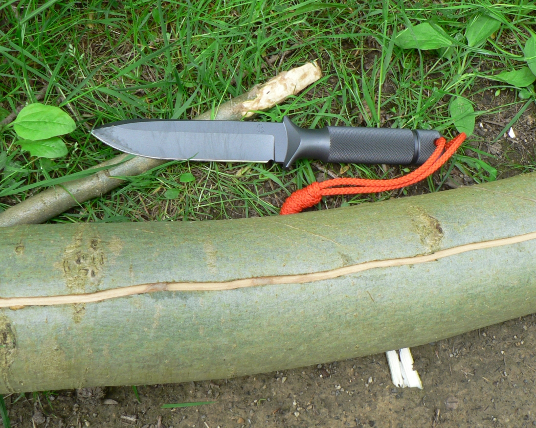

Here's the tree I was using and the slit bark:

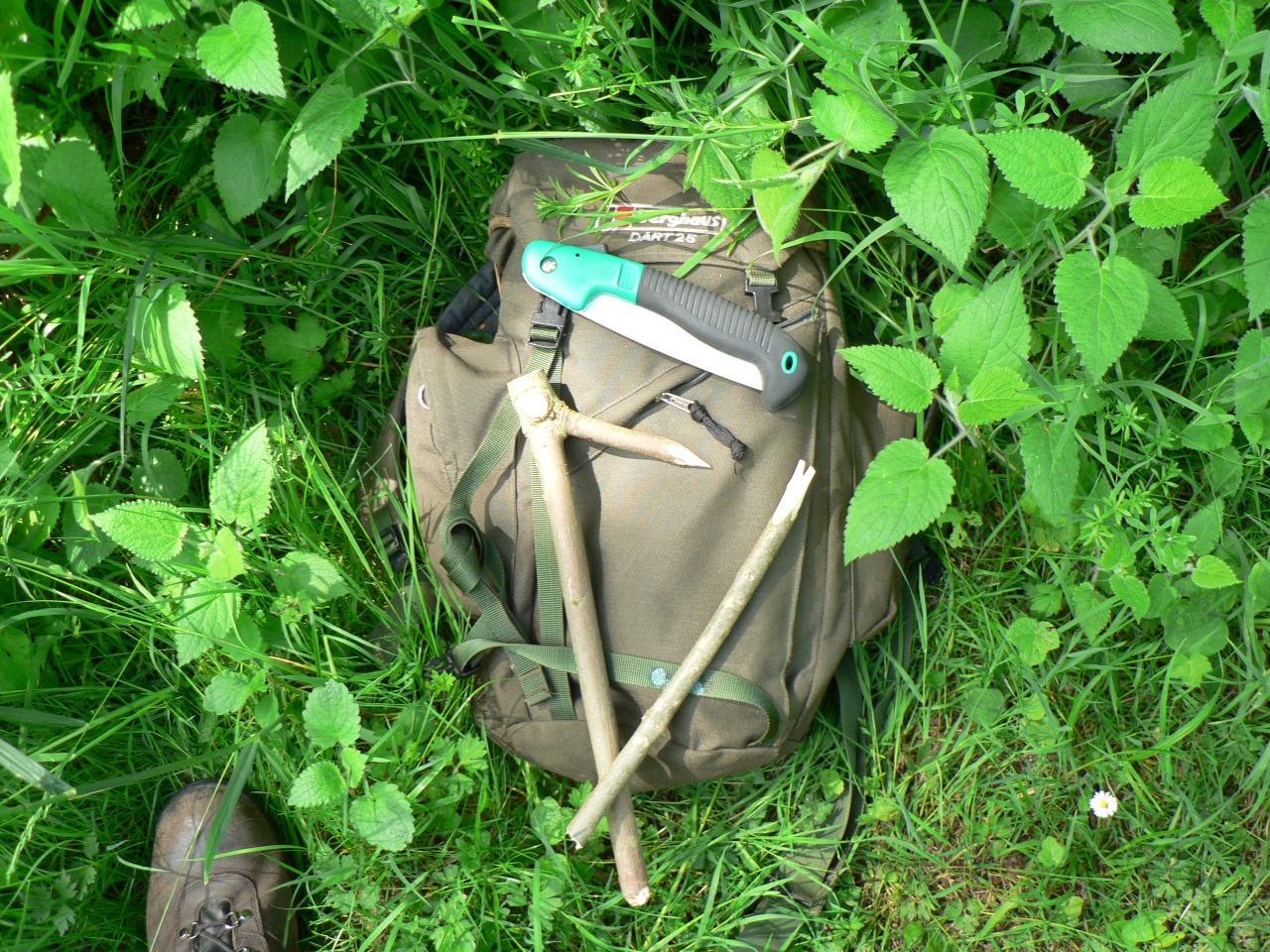

We then made digging sticks and 'brakes' (sticks with 'V' shaped notches) to dig up and strip spruce roots:

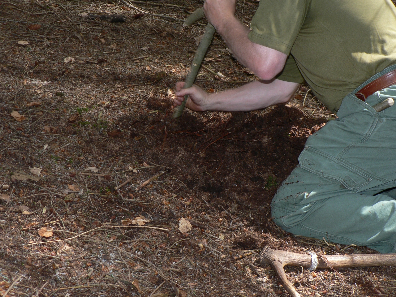

Here's Steve using a digging stick and antler pick to loosen the soil above the spruce roots:

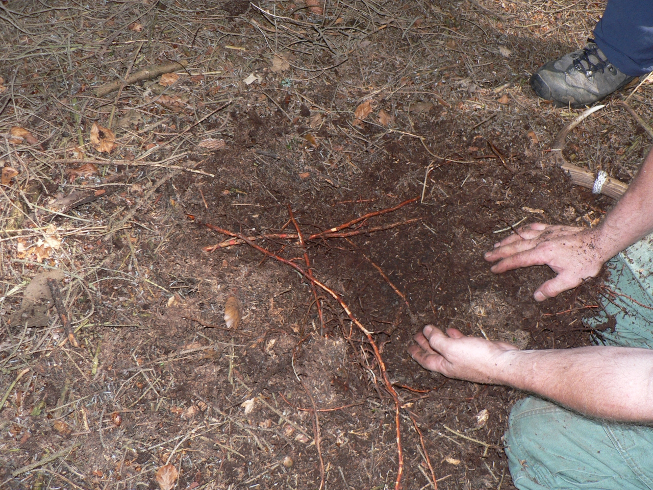

Here are some exposed roots:

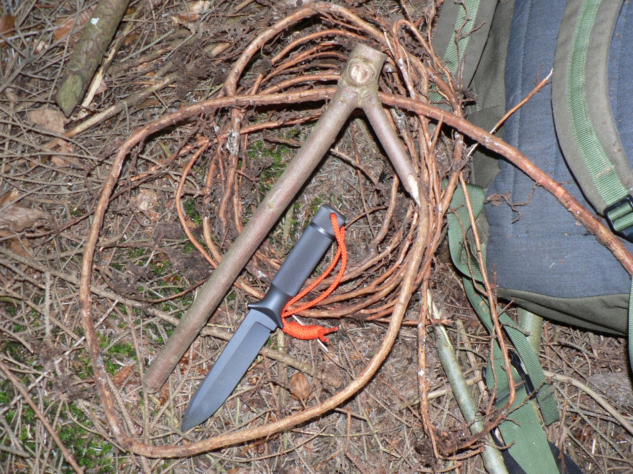

Here are the roots I dug up (a bit thick) with gratuitous CR pic:
The thick roots need splitting which is slow going if you are not used to it. The trick of bending one side back more sharply to correct run offs does work but it is hard on the fingers! I ended up sticking with overly thick roots due to time limitations.

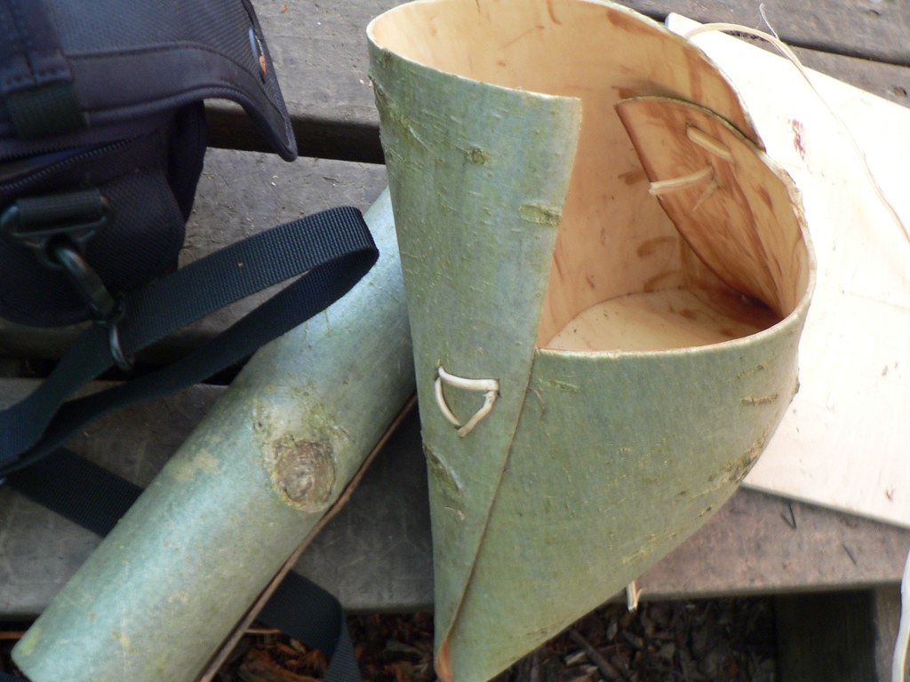

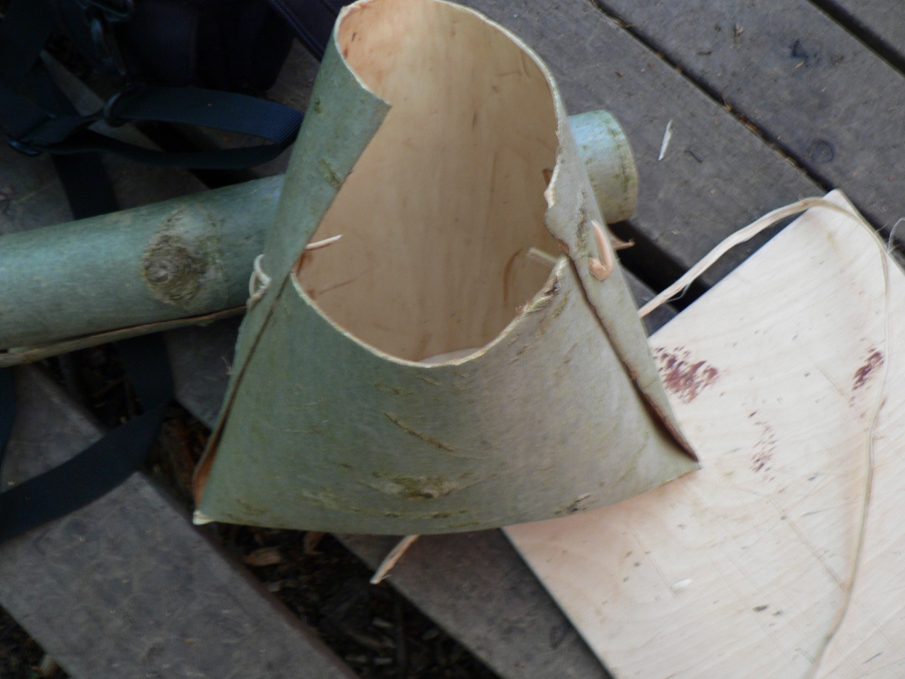

The Bark is then spread flat and an oval scored on the outside. The bark is then folded and stiched at the sides. I used my LM Core's awl for the scoring and piercing:
continued below.

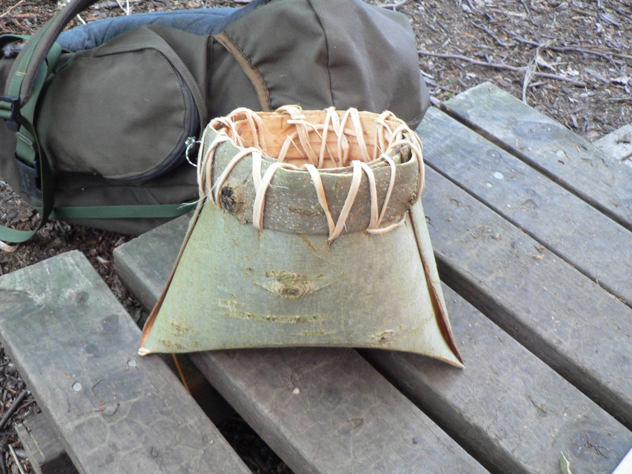

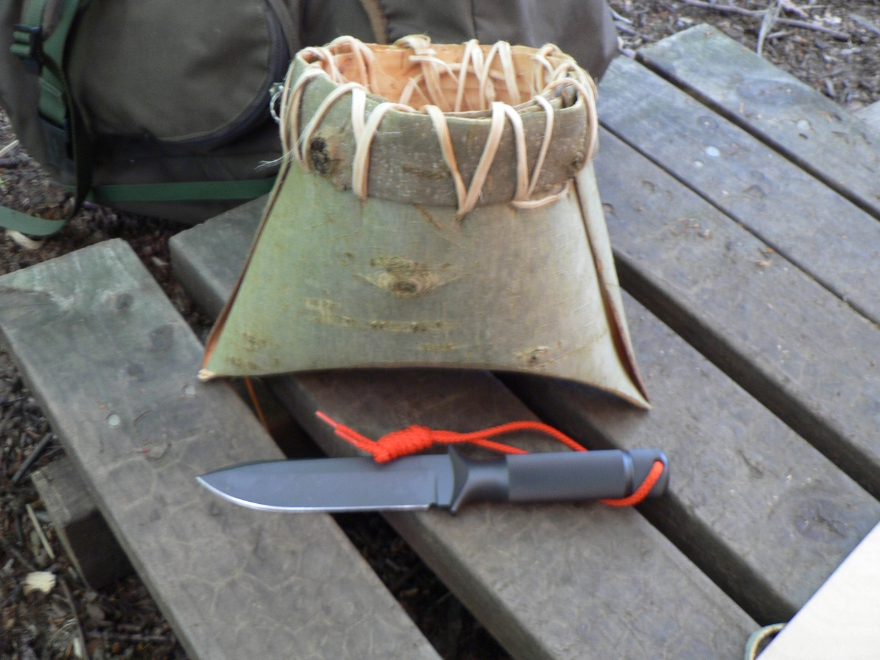

The top is trimmed and some strips of bark are sewn over the rim. The roots were really too thick but the concept is proved! A propper awl is better than the LM Core as well but it will do the job:
Better picture:
I finished off by stitching the sides (sorry no photo - I've not got round to taking one of the finished basket but will do so).

very cool basket there, even considering your limitations (time, thick roots, etc)

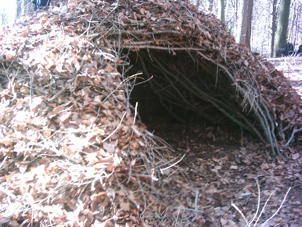

I'm glad people like the pictures - I've got some more photo's of a leaf debris shelter from an earlier course that I'll post in another thread.

Really nice pics. I like the debris shelter but I would rather not spend the night in one unless I absolutely had to. Too many creepy crawlies in the leaves and on the ground. I would much rather make a swamp bed with fresh cut pine boughs as bedding and insulation. IMO, I agree with DOC, too much emphises is placed on gear and knives instead of skill and technique. I would really like to see more threads like this.

...Really nice pics. I like the debris shelter but I would rather not spend the night in one unless I absolutely had to. Too many creepy crawlies in the leaves and on the ground....
Agreed. I am not to fond on having creatures crawling over me at night. If you really need to... then anything goes! I guess that in winter and subzero conditions there won't be many creepe crwlies there though.

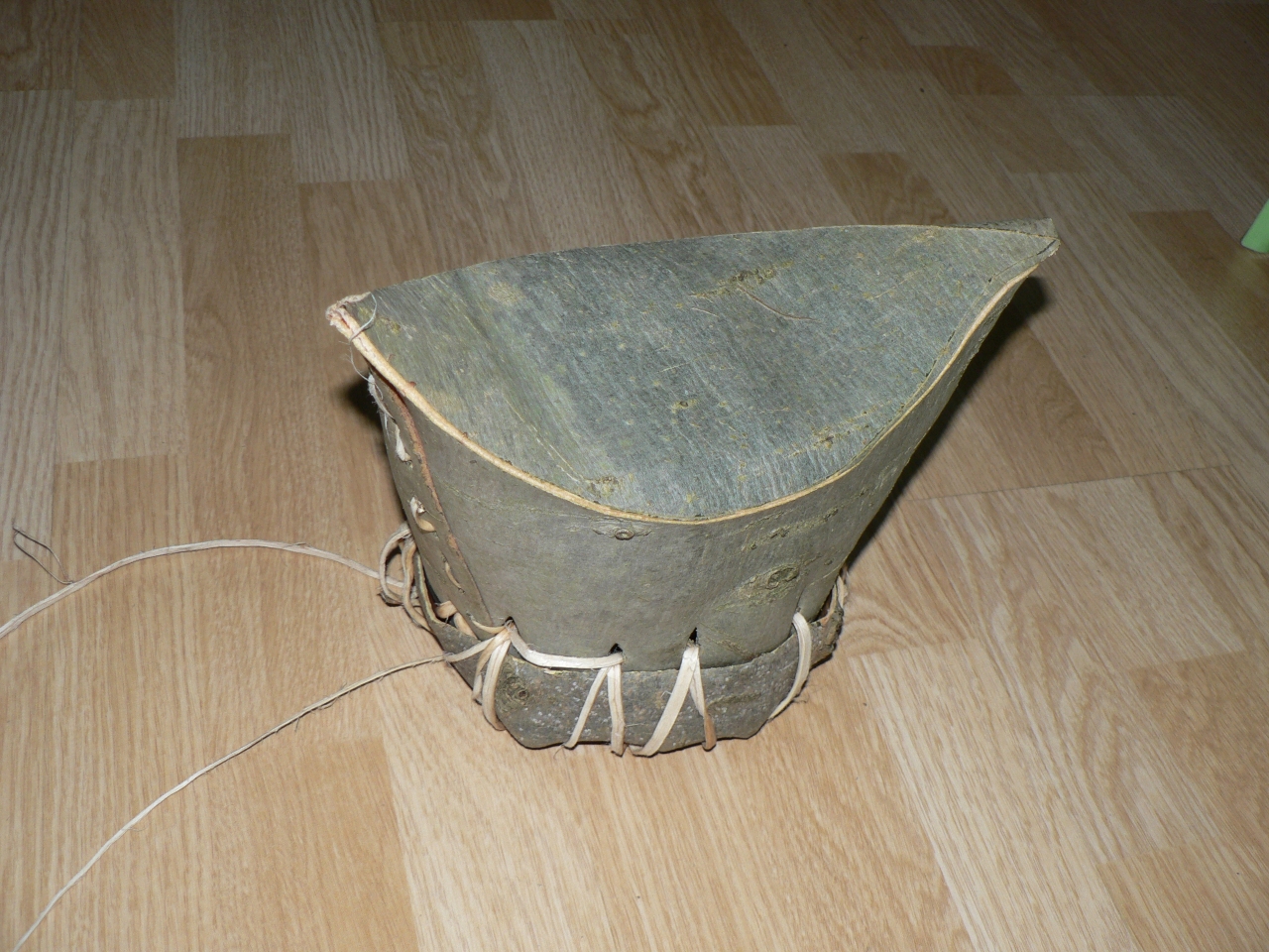

Thanks markwood, nice job. Looks like a very handy and durable container. How long did it take, or maybe better yet how long would it take to make another, now that you know what you're doing? And would you please explain about "scoring the oval", I don't see what the purpose of that was?

Blue sky:

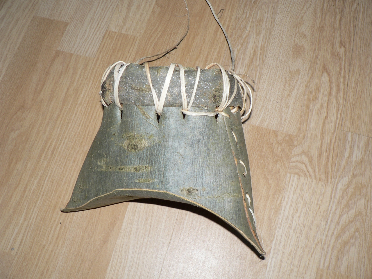

The oval is scored from one side to the other of the sheet either side of the centre line. As the sides are brought together and overlapped the bark assumes a kind of 'thunderbirds' hat shape. I'll take a picture of the bottom so you can see.
It didn't take that long to make the container - reckon with the materials to hand it could easily be done in an hour or so, quicker with practice. The bugger is getting the bark and the roots!

Regarding the shelter - beech leeves are pretty inedible even for insects so there are very few in the covering. A good thickness - a foot or so, including a lot of the gunky rotten stuff, should keep out the rain.
The purpose of the 'oval' is to increase the inside area of the bottom of the basket as compared to a simple folded bottom. It also gives it a concave profile (as you can see in Mark's bottom picture), so if you're gathering berries, for example, and the basket is fastened diagonally around you, Baldric style, the concave base of the basket will rest on your bent knee allowing you to gather berries with both hands! :D
Doc
The oval, it's clear now. Thanks for the explanations and pics.:thumbup:
