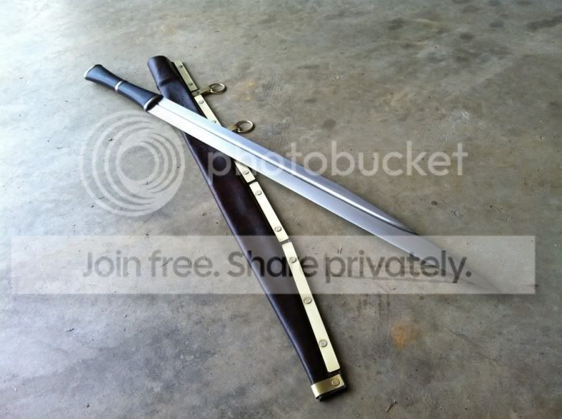

Are you talking about something like this:
Or more like this:

There are 2 distinct types of sword-knives called langseax, that were distinctly different weapons. One was the single-edged sword, with sword fittings, these were of largely Scandinavian origin. The back/spine of the blade is straight or nearly so. These often had a 'sabre grind' geometry, and had distal taper. The Germanic 'continental' langseax (also found in Britain) did not have sword fittings (no guard, no pommel, I've yet to find one with any sign of even a guard-plate or bolster), and there is good reason to believe they had straight handles approximately 9" long (I've only seen 2 surviving handles). The blade edge was almost straight, with the back of the blade curving down to the edge, or 'brokeback' with the spine being straight for approximately 2/3 the length then angling down to the edge, what could be called in modern terminology a clip-point (but never with a false edge). The blade usually is widest at the clip/break, getting slightly more narrow at the tang/blade junction. The blade geometry for the continental type would be a full-flat grind or slightly convex. The spines were quite thick, one specimen I know of is slightly over 3/8" at the spine. I've had it verified that these typically did not have distal taper to the blades, in fact some get thicker... with the long light-weight handles these typically had, they would handle more like an ax than a rapier.
The seax police have spoken... :)
The simple European/Germanic langseax is what I was referring to. I doubt anyone would have time to make a pattern welded, engraved, and fancy fitted Nordic style in the seven weeks remaining until Ashokan. That is what I meant by making them simple. Your description of the Germanic style is good to know. I had seen reproductions with some taper.
As I said, the participants can make them in pretty much any way they wish and it will qualify as a Langseax for this challenge.
