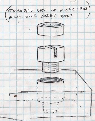

What if I want mosaic pins on my knife?
No problem! What I do then is use customized corby bolts hidden under "caps" made of mosaic pin... here's how it works:
That way you get the cool look without sacrificing mechanical strength. I don't stock a lot of mosaic pins; there are simply too many different ones for me to inventory them all. If you request them, I'll send you links to a couple suppliers and let you pick out the ones you prefer.

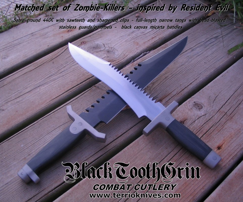

Im just curious, whats the biggest knife you have made?
What can i say i like em big :D

There is a THK prototype in the works that will dwarf both those knives above... not necessarily in size or weight, but in performance.
Stay tuned for updates. ;)
those are badass man!! Cant wait to see the new one!!
It's gonna be pretty cool, I think. It will involve a compound grind... full-flat near the handle for whittling and stuff, and convex
near the the tip with a slightly thicker edge for heavy chopping. The challenge is to build it stout enough for serious work, but balance it so that it doesn't tire you out in use.

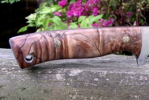

Is there a stabilized wood, or other wood (desert iron or something) that you would recommend aesthetically for a handle. Or does that "weaken" the "survival" aspect of the knife?
For knife handles, there is nothing more pleasing to my eye than highly figured wood. Many species like desert ironwood, curly/birdseye maple, crotch walnut and cocobolo are both beautiful and quite strong/stable. Burls and spalted woods of various types absolutely must be professionally stabilized for use on a knife. They're just not very strong in their natural state.
It's important to remember that figured wood (stabilized or not) is a natural material with voids and grain structures that do not lend themselves to ultimate durability. They also require a reasonable amount of care and can darken over time and with exposure.
If maximum durability and very low maintenance is a priority, my choice is G10 every time.
When a client's desire for beauty, good durabilty and moderate maintence is tempered with an understanding that I cannot absolutely guarantee that such a handle will not shrink/swell with the passage of time or break apart under heavy impact, I can and do use quality hardwoods with confidence.
