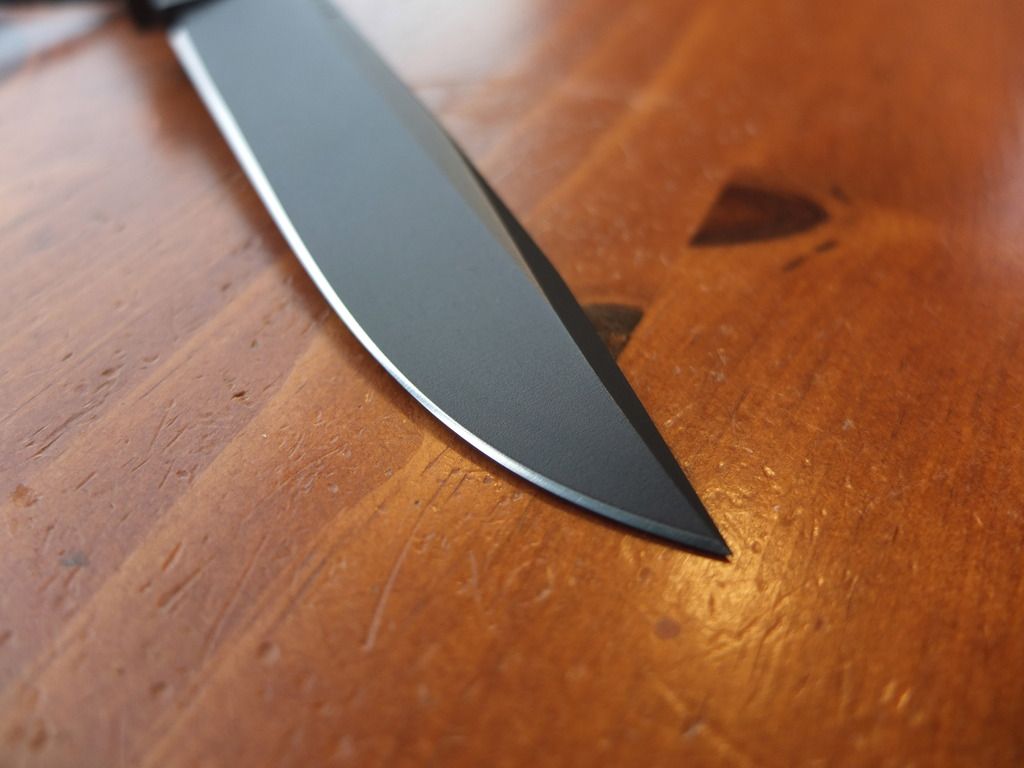

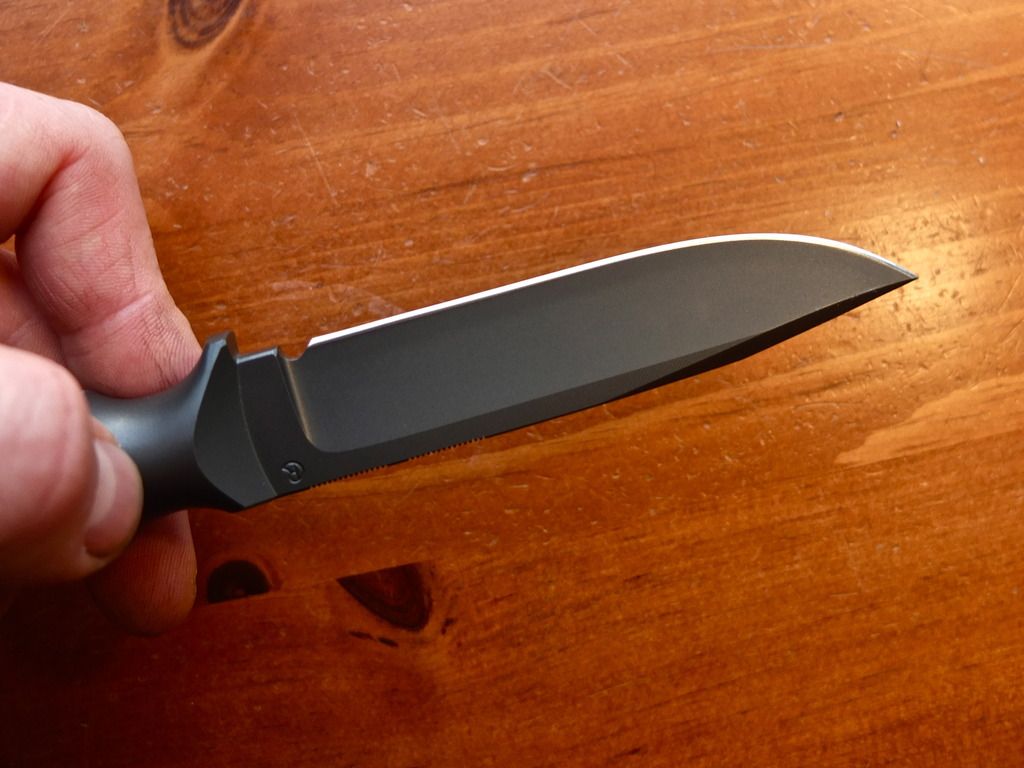

First up, the edge grind! Wow....this grind is amazing....totally straight, even, matching both sides. Whoever sharpened the edge of this knife cared a great deal about the result. BRAVO CRK!! 👍

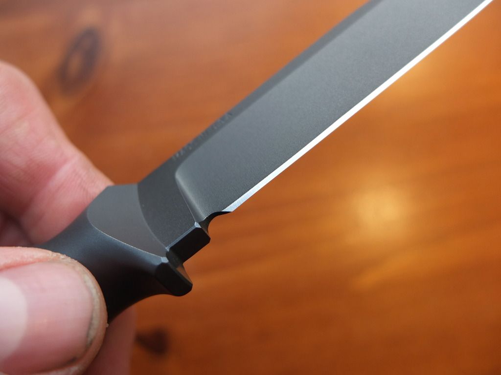

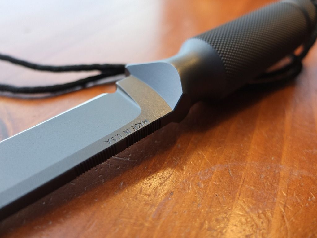

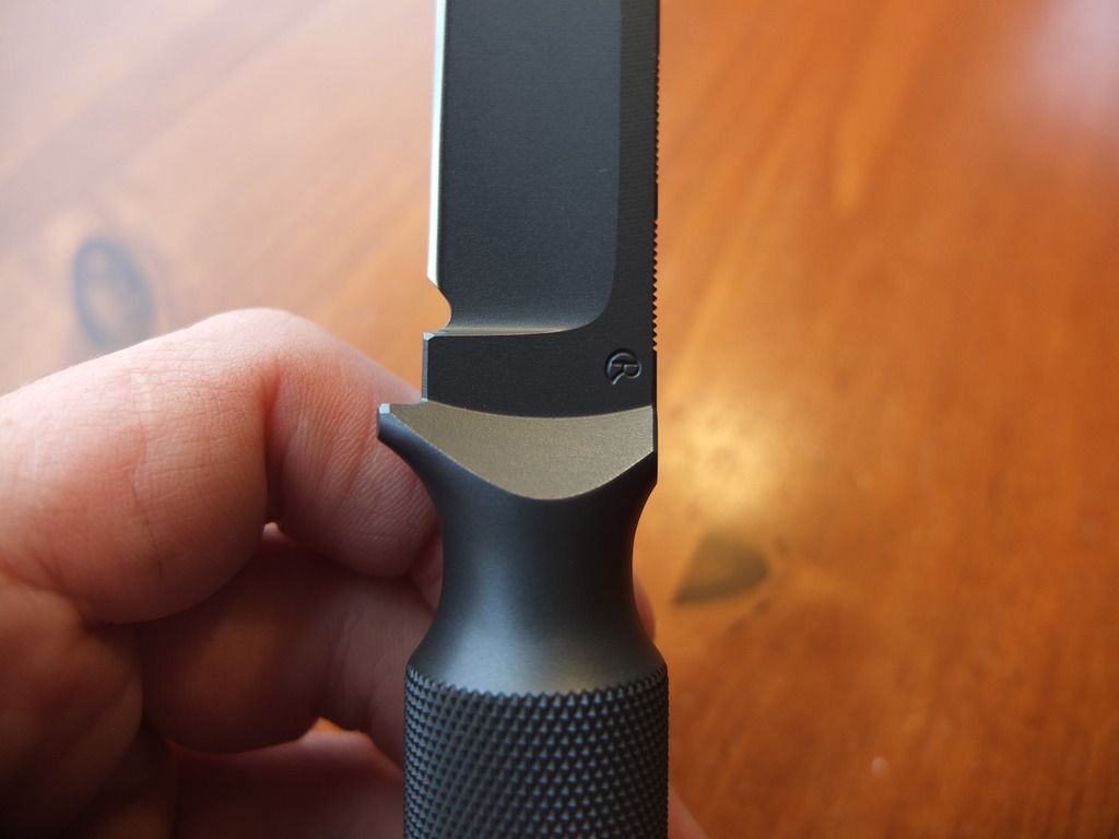

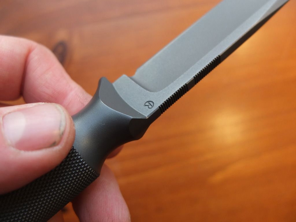

The blade has a very nice and useful sharpening choil, the guncoat coating is even and impeccable, and all the sharp corners on the protrusions are nicely removed with subtle small flat grinds. The plunge grind on the blade is awesome (note the nice arc between the plunge grind and the flat side of the blade). The hollow grind on the blade, 'CRK perfect' as expected:
The logo on these knives is punched into the surface, not engraved:

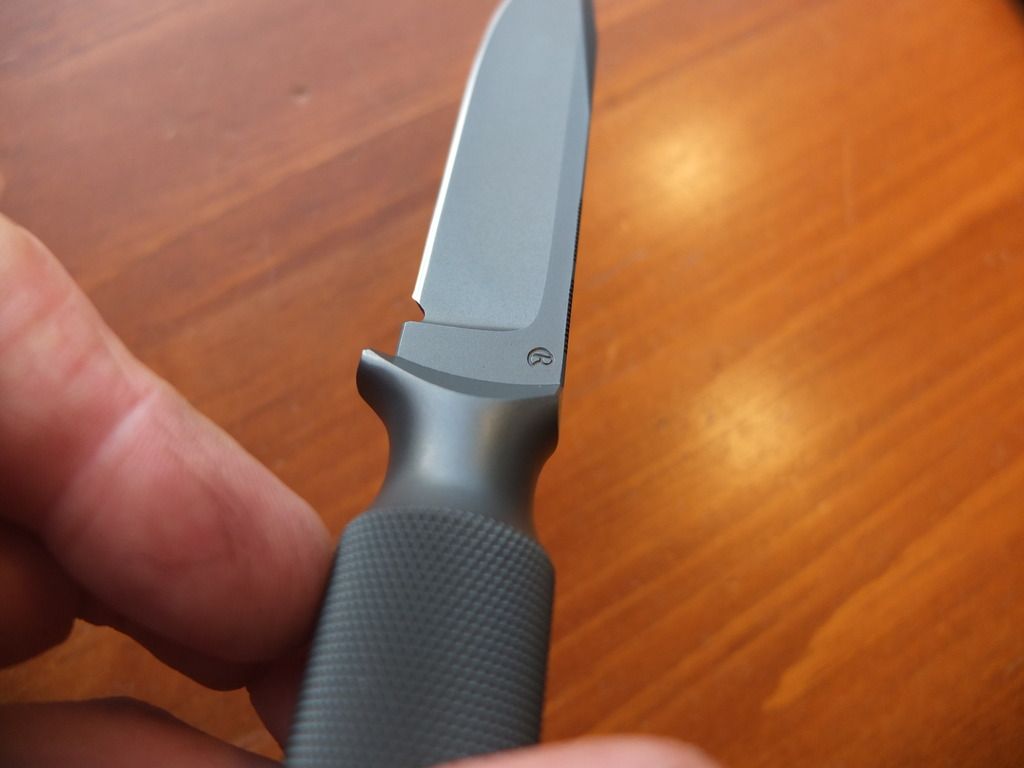

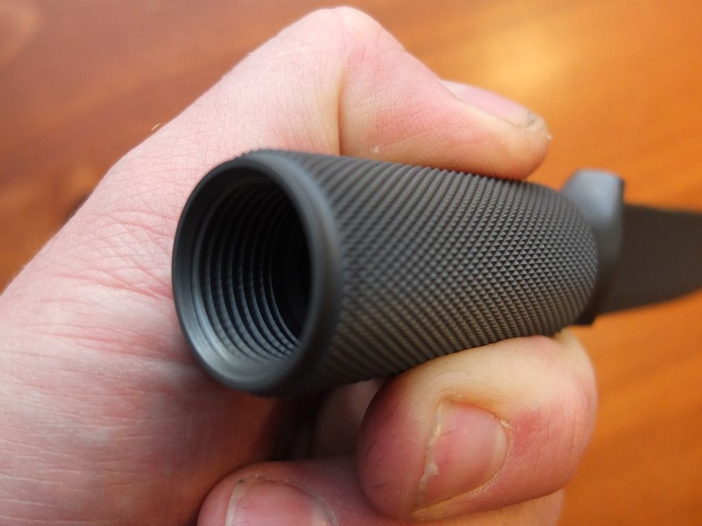

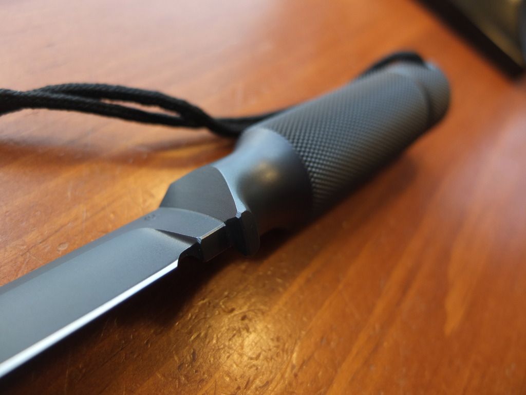

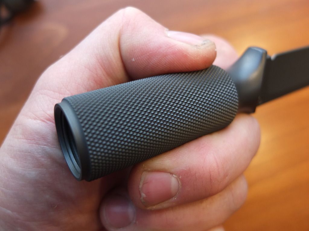

Have a look how the knurling transitions to the smooth area. Perfectly, perfectly even all the way around the handle in the photo below. That is not easy to achieve.

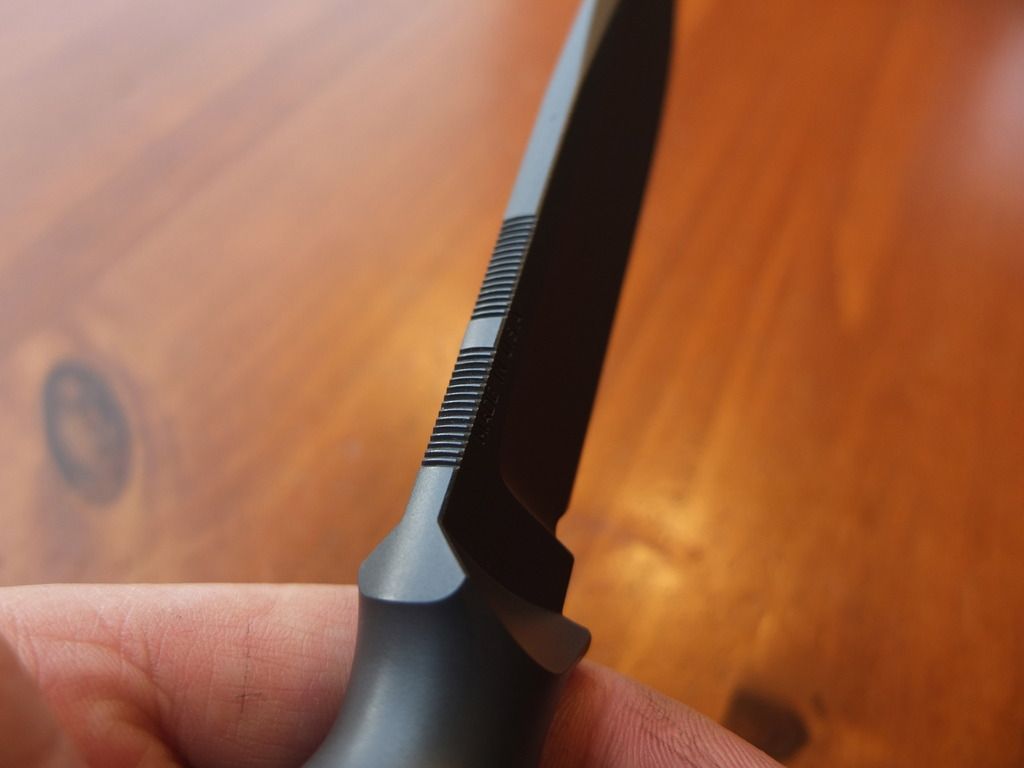

Jimping is fantastic!:
The traction knurling is amazing. I don't know what it would be like to work with this knife for hours (likely would chew up bare skin), but the traction is amazing in the short term, and it looks perfect. I like how the gun-coat carries on inside the knife:

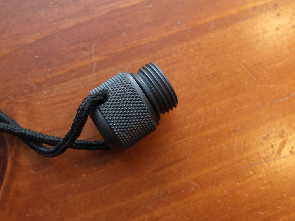

The aluminum cap is a wonder in it's own right (note the neoprene O-Ring for waterproofness, and the perfection of the transition between knurled and smooth surfaces. It is interesting that the appearance of the knurling on the aluminum cap and the hardened steel handle are identical. It likely took some figuring to make the machining match between the very different metals):
Never seen a nicer swedge (perfectly even both sides) and probably never will:
The rounding of the handle-to-blade transition has no machining marks. Very nicely finished:

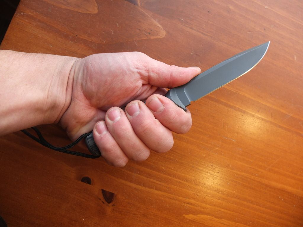

Feels great in hand!

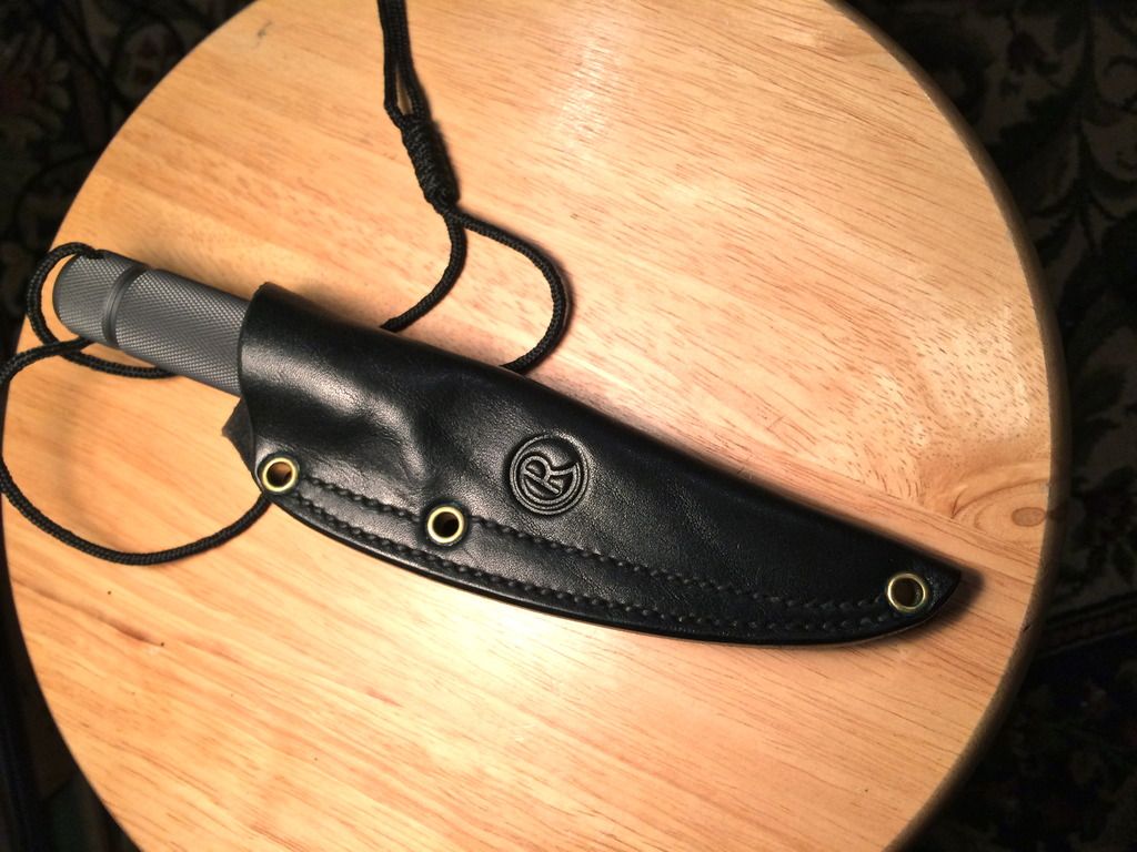

Sheath ? Show us the sheath.
please

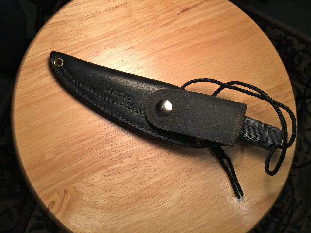

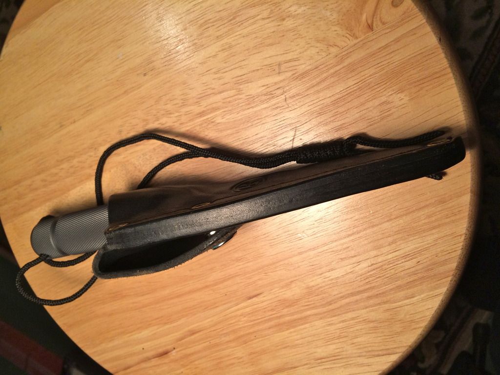

Here is the sheath, from GFeller Casemakers in Idaho. Very nice. Good snap loop, and rugged construction. Knife feels secure in the sheath:

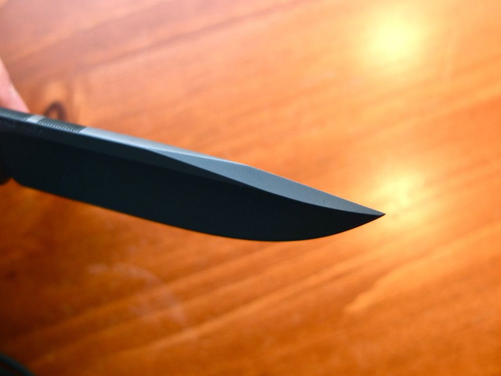

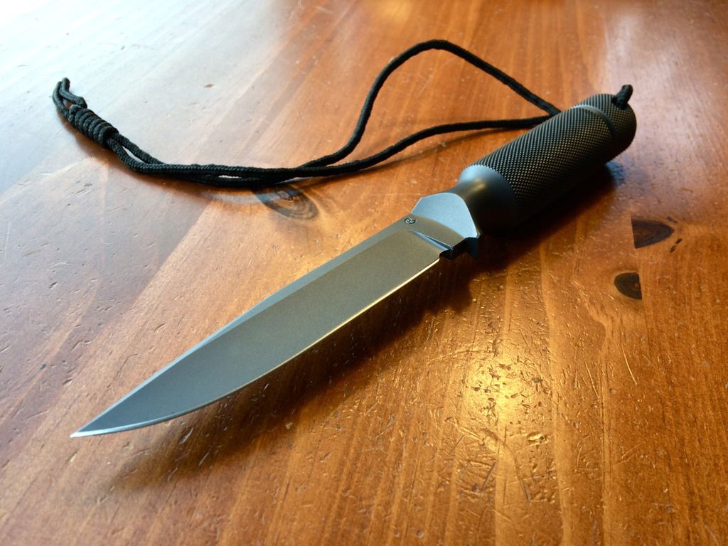

Another glamour shot, this with the forced perspective of an IPhone camera (makes the blade look longer than it really is). This is a smaller knife than it looks in pictures, but a very useable size.

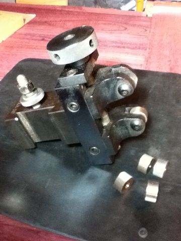

Speaking of caps..I may have have made that one :)

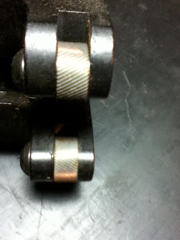

The knurling isn't difficult to figure out, but the peaks has to be perfectly formed (knurling isn't typically cut, but formed)
You did a great job on the cap!

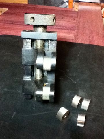

For any one curious here is a knurler. It gets mounted in a fairly robust metal lathe. The rollers on the tool with the file like teeth are forced into the metal to be formed and the metal gets squished into the knurled shape as the work gets turned. Note the different rollers for fine, medium and coarse knurls.

Thank you for your review! And for the photo with you holding it. I really can't imagine what one of CRKs OPK would look in hand so this helped a lot.
