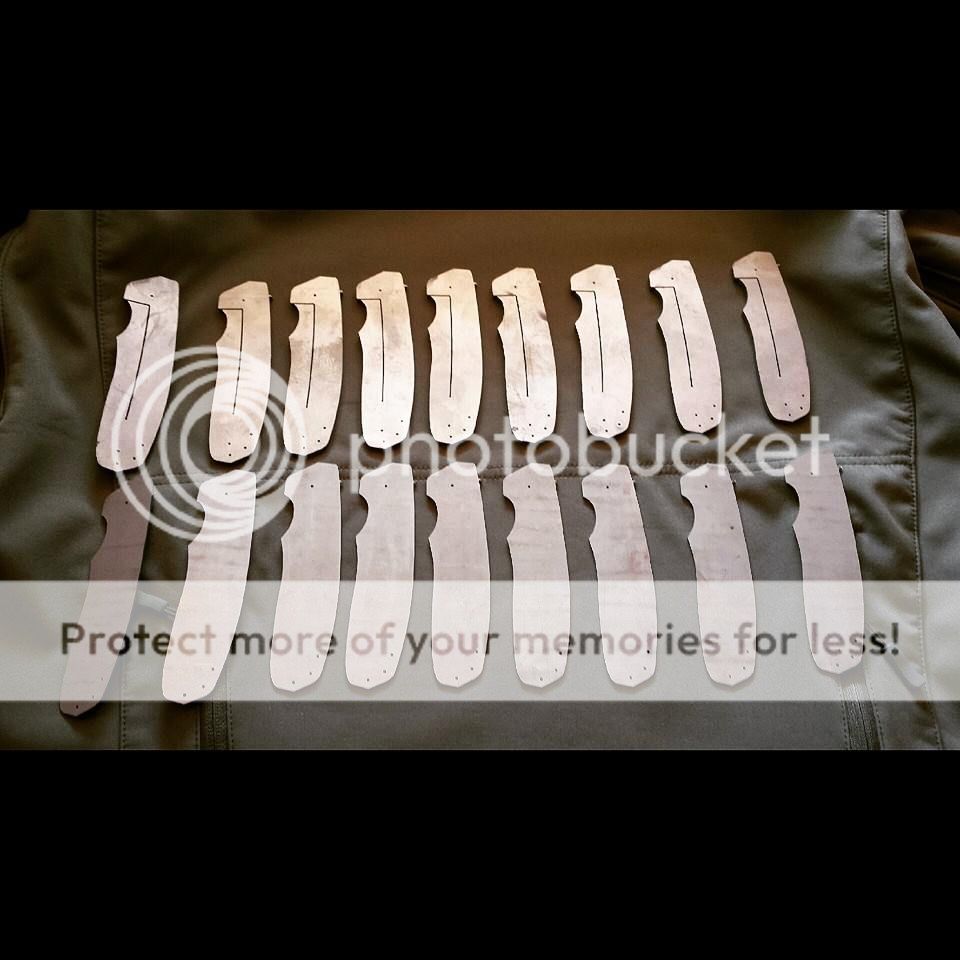

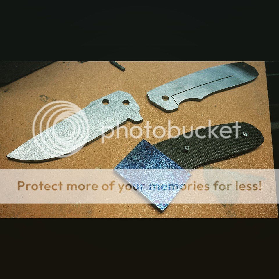

Water cutted titanium, that's only part that I don't do myself....

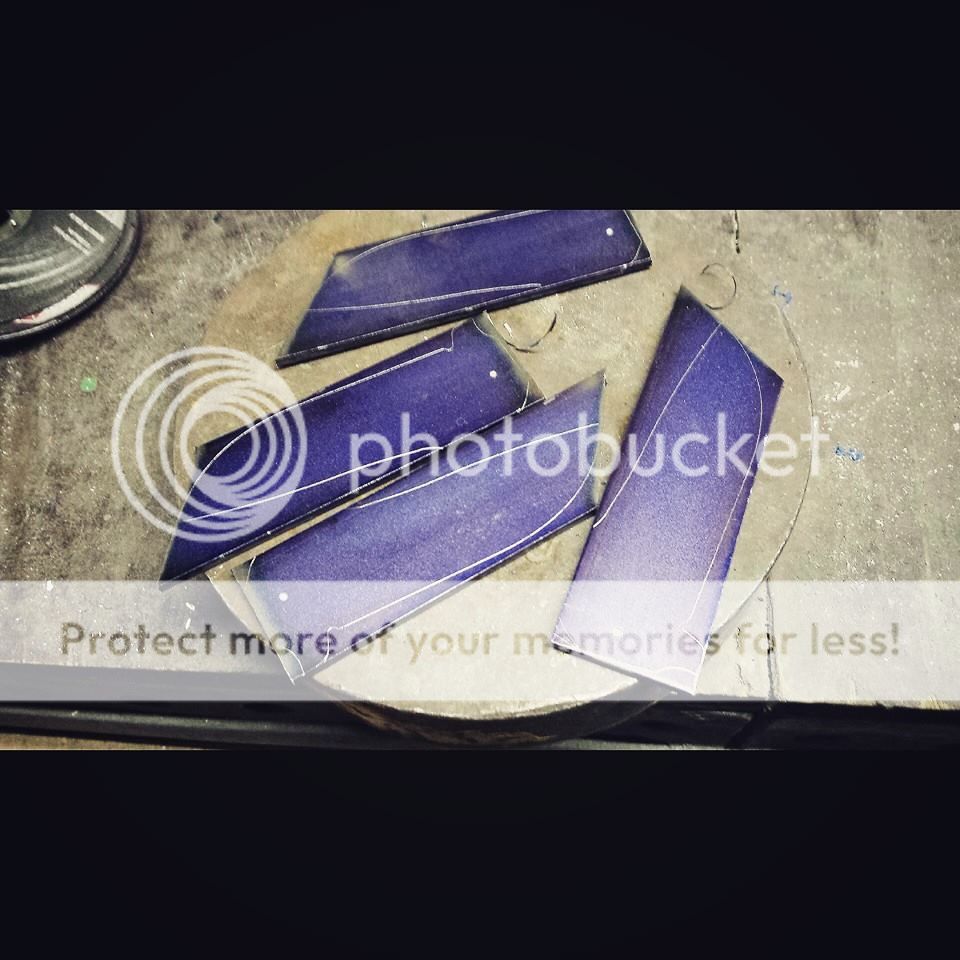

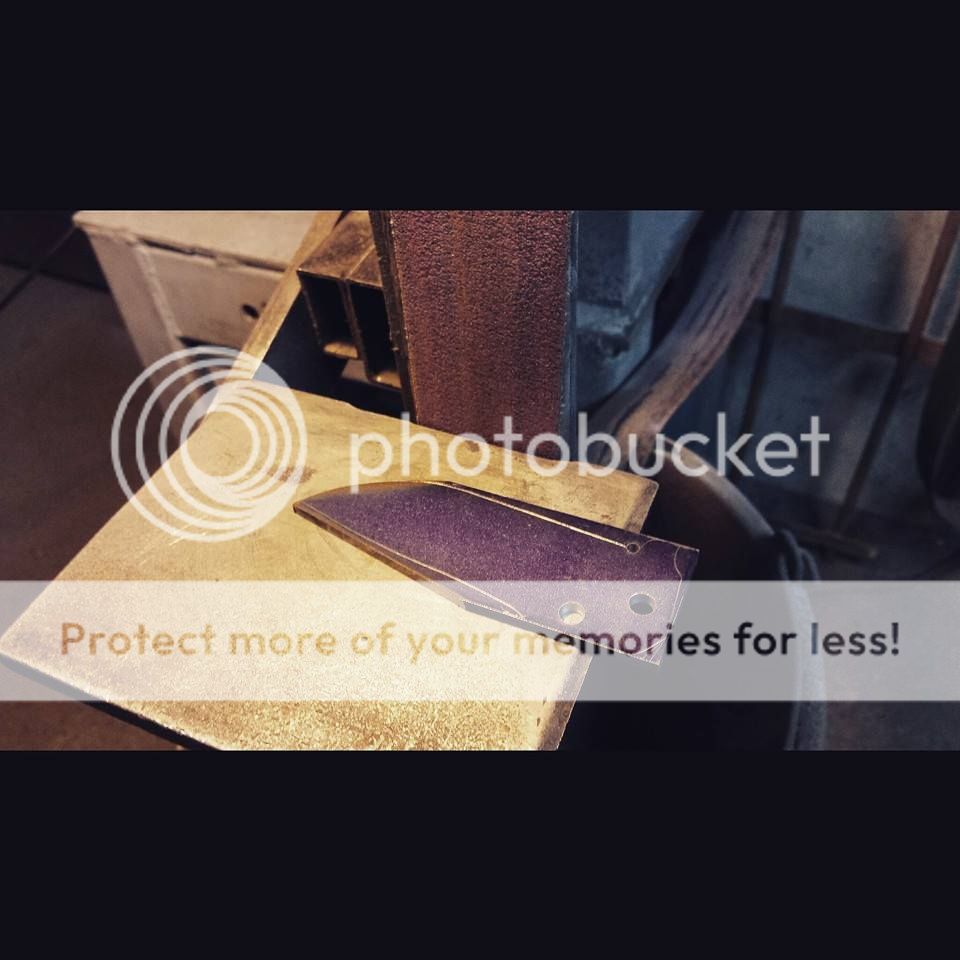

Blades, marked and cutted

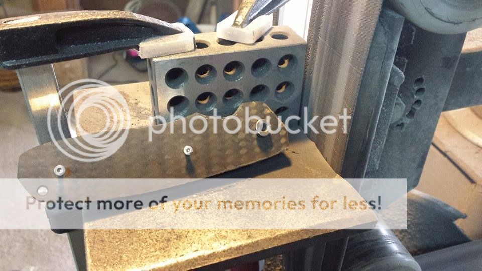

Shaping...

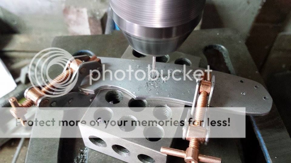

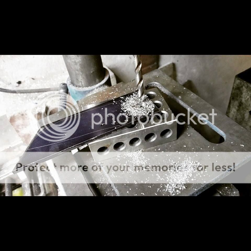

Drilling presentation side

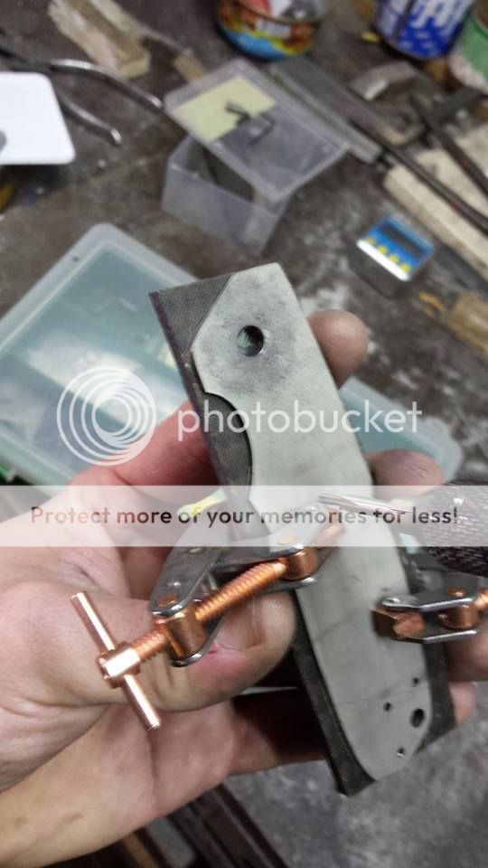

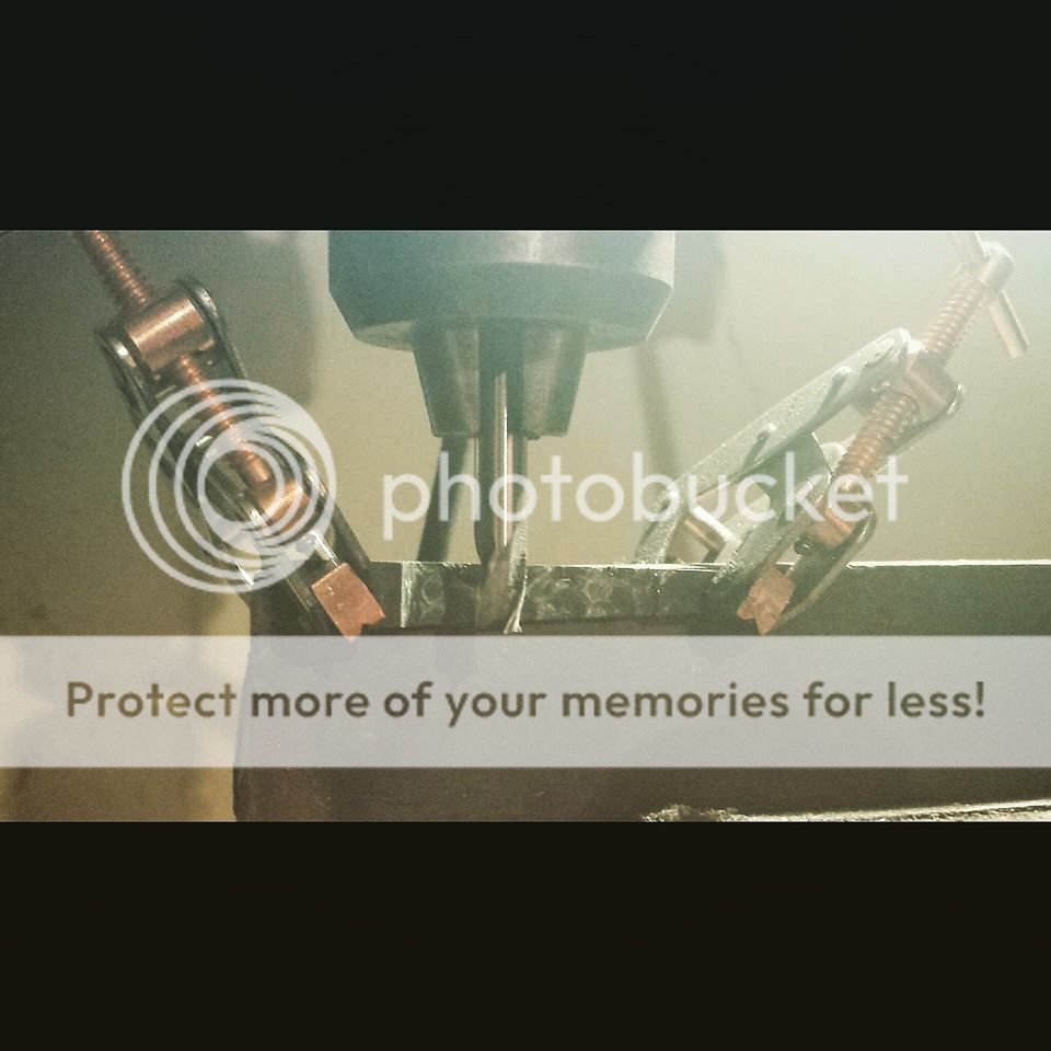

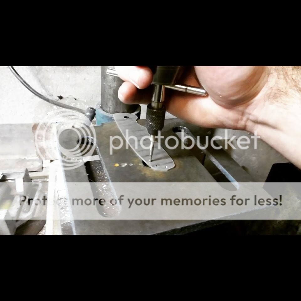

Tapping...
Handmatic minus 7x. Slow that slowest can't be ? but what can I do, it works !!hahahah

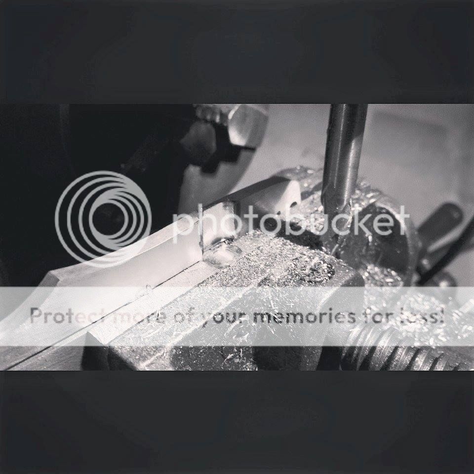

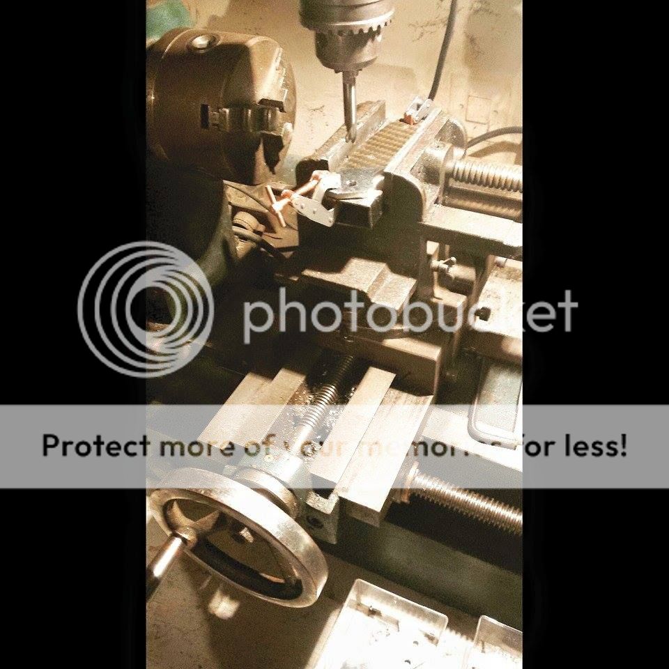

Counterboring pivot on my lathe/mill machine

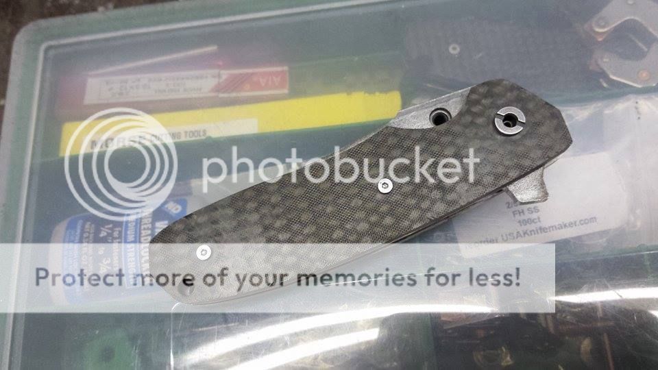

And carbon fiber clip
Perfect match !!

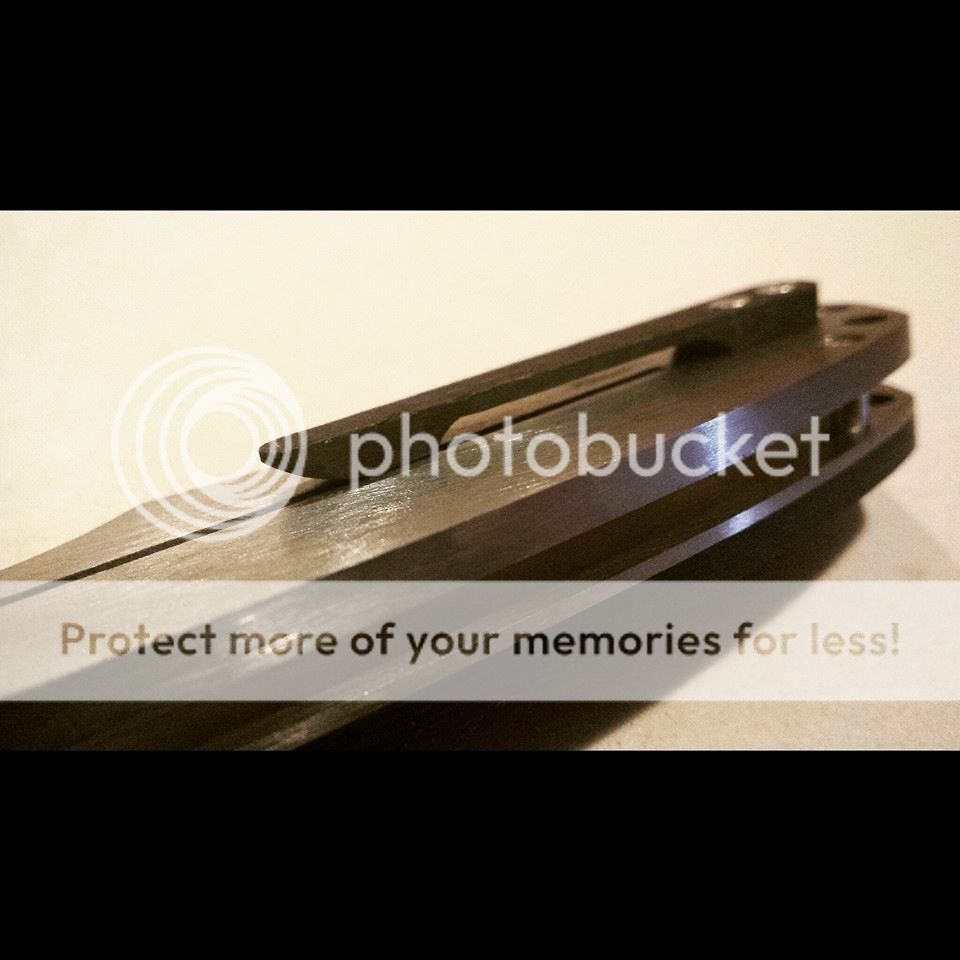

Aslo lock release

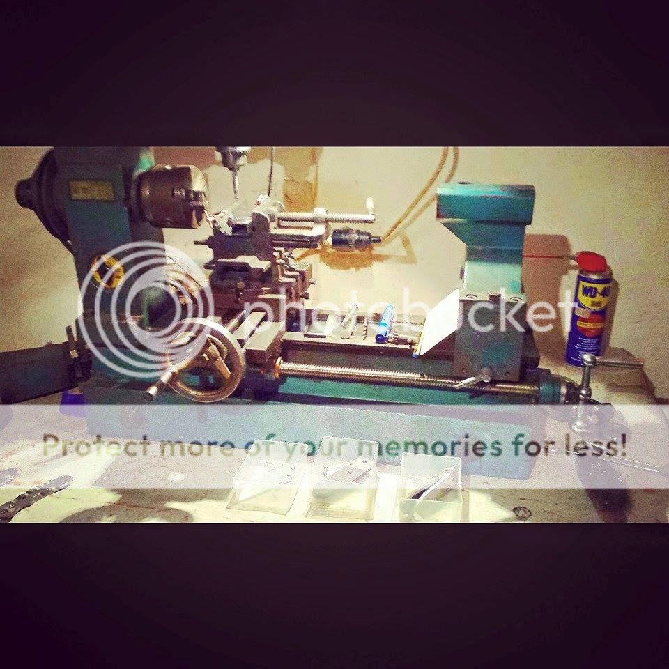

This is my vintage lathe/mill...
I love that old German machine, are built to last forever.
Not like China shit tools...
