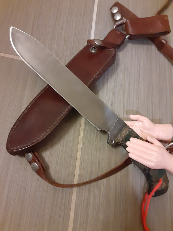

To my knowledge the only asym edges released by the shop later on were either very limited runs such as on the Basic 11 at Blade Show 2010 in Atlanta, or special orders filled back when the Custom Shop still accepted private orders, up to about 2015. For example, Garth put an asym edge on this Basic 8 LE (War Feather mod) for me in 2015…IMG_9095.jpegIMG_9094.jpeg
