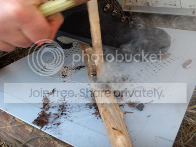

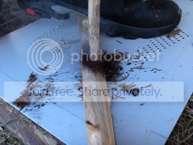

I"ve finally made fire with a fire bow. My buddy took a pile of pics as I went.
I know it doesn't look like the wilds but there's 3 feet of snow and ice everywhere here so i did it all on the step of my barn under the close supervision of my Llama Tom.

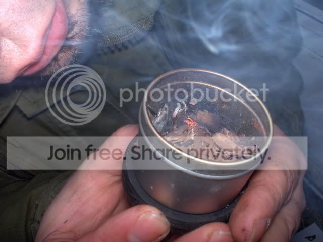

I started off with an All Cedar set-up.All parts I used came from the same dead tree.The bow was maple.I used the Fire piston tinder box to hold my tinder as it was quite windy today here.

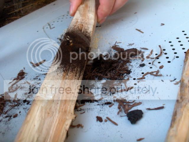

I got good smoke right off the bat.And very dark dust.I knew I couldn't stop.

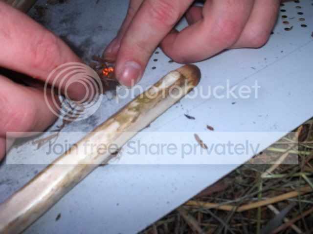

Then my buddy told me to stop.I couldn't see through the smoke but there was an ember.(you can faintly see the little thread of smoke against the black dust).

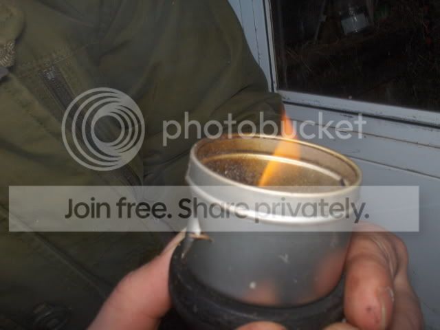

I gently blew on the ember and it glowed bright.

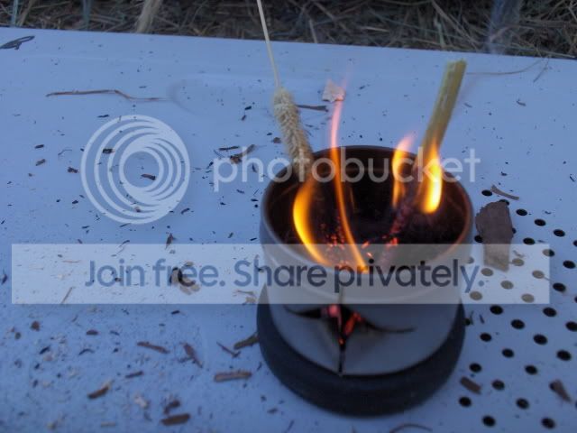

I had made 1 mistake and didn't have my tinder right under the ember to catch it so I had to chase it around for a few desperate seconds trying to get it into the tinder box.But,once inside it was cinched.
Flame soon followed.

A couple of questions: First, what did you use as your bowstring? Second, how long did it take you total, from fabricating your rig until you had fire?

Thanks for asking.The bowstring was 550 para cord.All told it took us about I'd say a half an hour from knife in wood to flame.I was amazed at this because I've drilled for that long and got nothing in the past.It was just meant to be this time.

If ya put the glowin' ember in the X on the tinder box and open the end just a little, (like partly takin' the lid off) all ya hafta do is blow and it bursts into flames.
When yer done just put the lid all the way on and it'll snuff out the flames, then just stuff new tinder in the end with the lid and it'll push fresh tinder into the opening makin' it ready for the next time.
