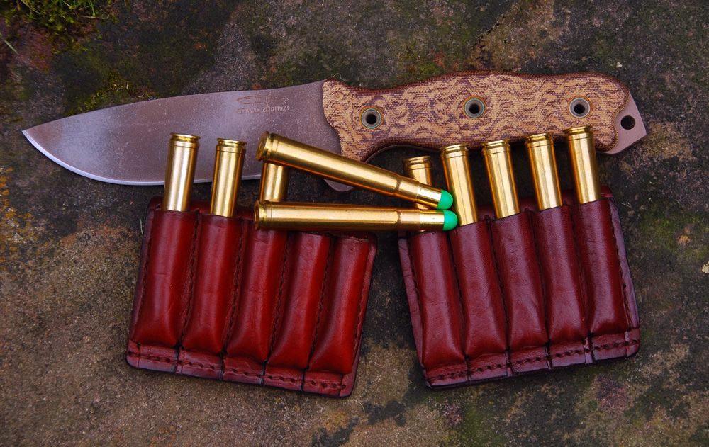

... so last year I figured out the load I was going to use in my .375H&H when I toddle off to Africa in August but time has been against me since. Also had to solve a crimp issue to get the big pills nice and tight in the case. So after some experimentation and a couple of buggered cases today I finally got it all sorted out and started dumping some powder into cases and stuffing projectiles in on top.... :D
Just a few today, another 50 or so before I head bush next month to play.... :) :)
Dang, them be some large rounds! My apologies to your shooting shoulder in advance.
Are those the Woodleigh Hydrostatic? Never seen the green domes on them before, is that just to improve feeding?
Yep 300gn Woodleighs. The caps are purely for feeding, I have to pop them off to seat each pill as they are a bit spongy.

Those Woodleighs are compressing 77gns of Win 760. This is the same load I used with Sierra 300gn'ers in the 80s on Asiatic Buffalo with fine results ;) . I loaded a small batch of Woodleighs, on this, seated deep enough that they will load in the magazine. Shot a couple for pressure (primers flattening but not significantly) and then put three into 1.1 inches. I could play around more but I am not going to. Putting rounds out of the rifle is now more important than marginally smaller groups at this point.
Completely agree on the group size, but is there a significant increased temperature difference between where you are now and there, when you'll be hunting? I don't want you to have to boil the barreled action or beat the braizing off the bolt handle to get it open. Generally I've found the 375 does best with medium-burn rate powders. 760 is pretty slow, and the Sierra (Game Kings?) I'd certainly think are waaaaaaay shorter, giving the Woodleighs more bearing surface and more chance to build pressure. It appears to have bearing surface relief grooves which would counteract the length difference hopefully. And you may have forgotten more than I know about it. Just trying to avoid a horror story.
