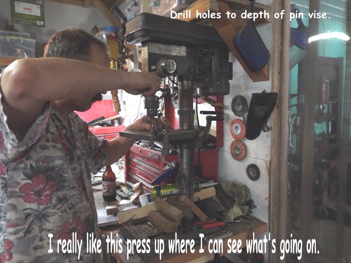

I have three different drill presses for dedicated tasks.
One I'll show here is for drilling tiny holes that I can view up close.
Mine is floor standing and I'm average height so the chuck is approximately chest high. That seems about right.
