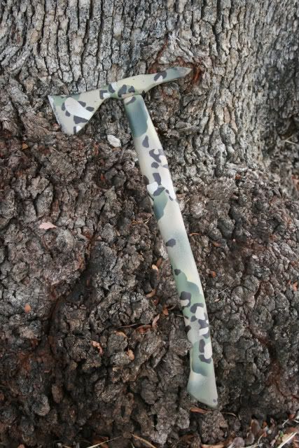

Ask and ye shaaaalll receive!
It was 762 Shooters pic that inspired me - I just couldn't find a handle like his one, as that's what I really wanted since it's slim whereas the ball pein hammer handle is getting thick at the grip end.
Will add my grip tape and see how it feels after that.
There was a thread here about 2 to 3 weeks ago about straight versus bent handled hawks. It inspired me to get this one out and kill some air zombies. After a couple of days wacking things with it I am back in the straight handle corner. I love the hawk pictured above but it does have some, er, weakness'. It would be great on a back swing with the spike. Reversing the hawk and attacking with the spike would be greatly affected by the curve at the bottom of the handle. One would be fighting the hawk more than the bad guy. I'm sure Vec could explain this far more eloquently than I. That hawk is very lively in the hand and I would feel like a Valkyries boyfriend with it in my hands but a bent handle has some drawbacks. I like tha handle you have on yours very much. I like Vec's handles even better. Wait. His hawk handles. You new that. I was talking about his HAWK handles. Glad I inspired someone. I gotta go tell my wife. Good thing it's in print. She'd never believe me...
