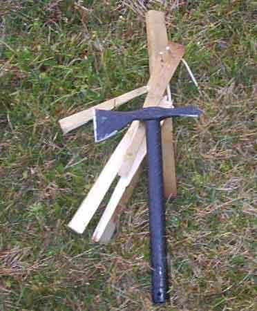

Making a small fire, the vtac gathers the dry limbs well. A highly efficient cutting edge actually doesn't make as much difference here as it does on fresh woods because the dead limbs do tend to crack more than cleanly cut and thus the raw power of the tomahawk actually makes it more productive than the Ratweiler for example. The knife however did better at making shavings and cutting the lighter vegetation for tinder as well as limbing the boughs to get the fire going to get the dry wood to burn. Some work with the sharpened under edge again showed that there is a lot of potential there for brush cutting if it was reground to a more acute profile, it would function similar to a scythe.

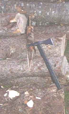

Here is one of the advantages of the tomahawk over the Ratweiler, a decent sized log :
On wood of this size and larger the long blades will start to slow down because they lose penetration on the wood as more of the blade comes in contact. The axe still gets the same regardless of if the wood is wider than the bit or not so is more able to clear chips from thick woods. The tomahawk is of similar capability here as the Ratweiler even though the Ratweiler is significantly more capable a chopper on smaller wood. This wood is also fairly rotted and thus will absorb water which makes it nice for keeping a fire going in the rain because the water won't simply run over it into the coals but the wood will tend to soak it up which is then boiled out by the fire.
