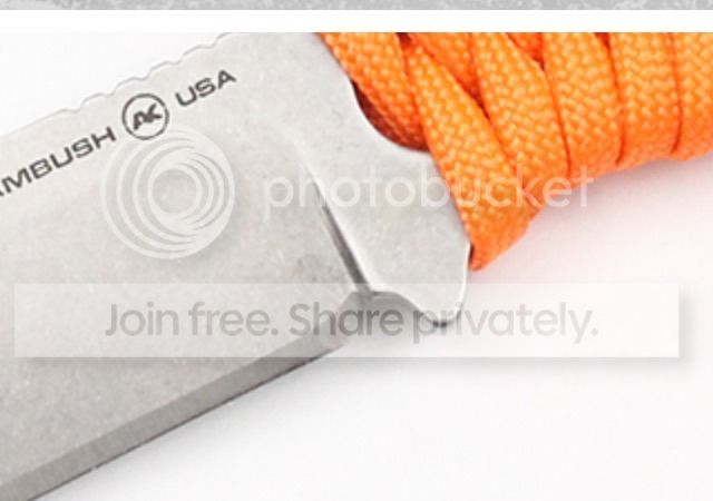

Atrocious edge

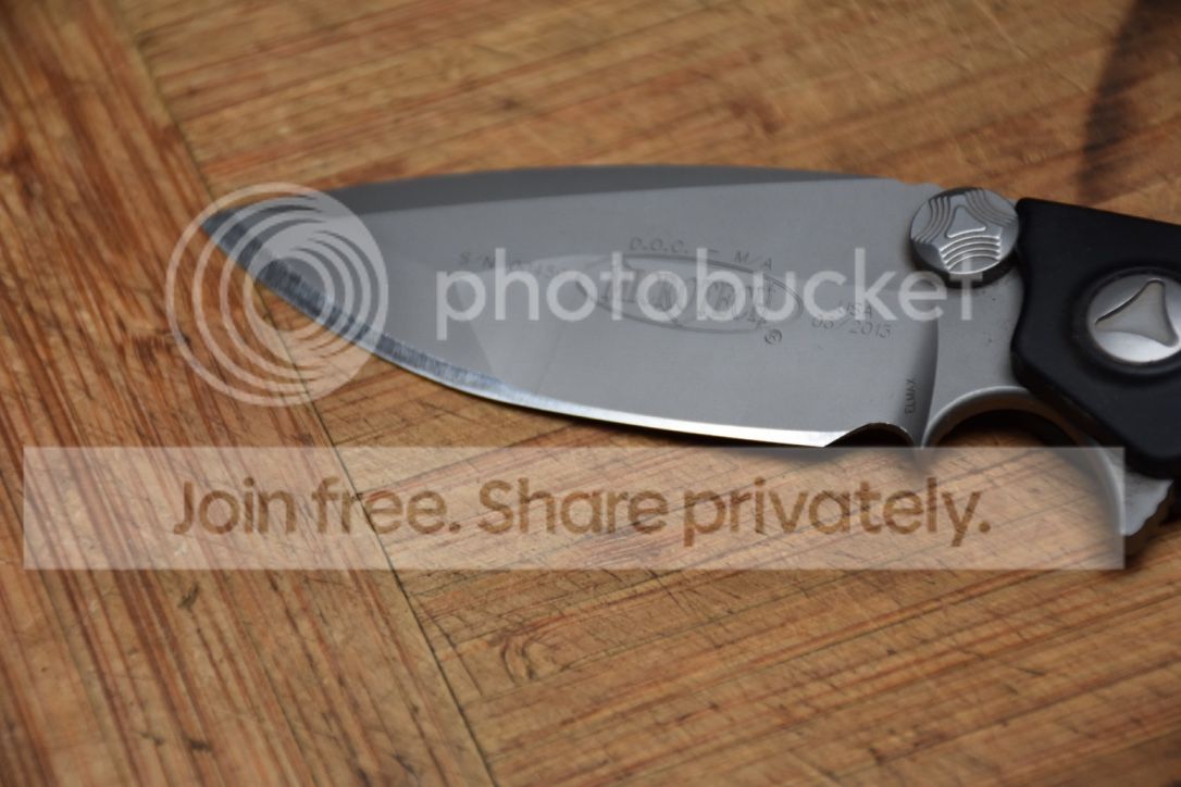

Here is a proper sharpening coil — right before the ricasso. The regular choil is behind it, allowing you to choke up on the blade to get more control in certain cutting tasks.
The sharpening choil allows you to sharpen the edge evenly without getting your stone caught up in the ricasso.
The OP’s knife is a faulty execution of a sharpening choil. It looks like that knife has a high sabre flat grind that wasn’t finished at the ricasso, as it should have been. Instead, the edge ramps up to the ricasso, so the rear most portion of the edge is much thicker than the rest of the edge. You can’t get a good, clean edge that way. What was left was a groove directly before the ricasso. Every part of the edge in front of that groove should be a constant thickness.
The DOC in the photo also has a ramp up to the ricasso, but it doesn’t affect the edge or the sharpening process because the sharpening choil makes sure the edge is well in front of the ramp up, making the entire edge a constant thickness that is easy to sharpen.

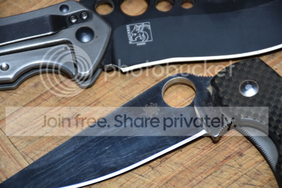

Here’s another example of a proper sharpening choil — the one on the Benchmade Skirmish. The Spyderco Military doesn’t have a sharpening choil and you can see that the edge doesn’t finish cleanly because the stone has to butt up against the ricasso.
There is a second advantage to the sharpening choil: it eliminates a stress riser. On the Military, the sharp grind line where the blade meets the ricasso, is a stress riser.
On the Skirmish, the blade gradually ramps up to the ricasso, eliminating the stress riser.
It’s difficult to tell on the OP’s knife if there was even supposed to be a sharpening choil. It looks like the blade didn’t get finished. In any event, a sharpening choil is supposed to allow for a clean finish to the edge, something that the faulty grind of the OP’s knife doesn’t allow.

That's definitely a sharpening choil. Still, the grind lines are poorly executed, and it looks as though the ramp up to the ricasso (the blending plunge line) didn't quite get clear of the sharpening choil.
I was online shopping knives and I came across this edge atrocity. I'll get bashed for this and might be labeled as a troll but in reality I'm tired of seeing these type of edges on quality materials and they call it "quality made" product.
For those people who wonders what I'm talking about. It's the grind on base of the secondary bevel.

Are you talking about the area of the sharpening notch? I'm not familiar with that knife but it would make sense to me if it was deliberate; it would help stop things like cord and cloth catching on the sharpening notch during cutting.
The sharpening notch is usually there for more that just ease of sharpening. It is there because the main grind coming up into the ricasso makes a thicker piece in one small part. You dont want an uneven edge at one small part because it screws up your ability to put a fine edge on your entire blade. also it does not make your sharpening system happy.
spyderco doesnt put them on because they have a sharp angle from the ricasso into the main grind, as to not create that thicker piece that makes a notch nessecary.
I might have just answered the wrong question, but nobody really does what is demonstrated in the picture on purpose.

Stress risers, I understand that as a metallurgical term, and that may be true for the strength of a piece of steel, but if you use a knife as a knife, it won't matter. Having an unsharpened bit of blade right where I need an edge it is a pain. Spyderco does it right as a cutting tool.
