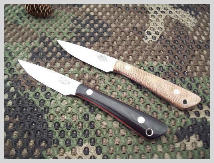

A couple of little Sidekick slicers I knocked out before the end of the year.
Kitchen, EDC, Bird & Trout, Fur Shed, these little guys work well almost anywhere !
Specs follow :
Steel : 3/32" ATS 34
Heat Treat : Austenitized & Quenched, LN Cryo, & Triple Tempered (in that order) Final HRC @ 59-60
Grind : 10" Hollow Ground, Hand Rubbed Satin Finish
Handle Scales : Black G10 & .015 Red Liner
Fasteners : Stainless Steel Corby Handle Screws & Lanyard Tube
Overall Length : 7-1/8"
Blade Length : 3-3/16"
Sheath : 8-9 oz. Veg Tanned Leather, Hand Sewn with Neatsfoot Oil Finish
Cost : $155 + shipping

Beautiful knives David..one question is the blade longer on the G10 model??
Your George Herron model is well liked!
FAF
FAF
Yes, by ~ .100 ............. good eye :thumbup: The scale is a bit more forward on one too. Which do you like ? I know ........ not fair
With the different scales it's like apples to oranges ;)

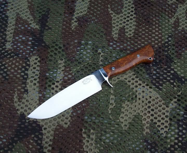

Just finished a Hunter for a guy in Germany that's modeled after Herrons Drop Point # 6. Antique Gold Micarta Scales :thumbup:
It was REALLY nice !! Shoot me your e-mail addy for pics if you like :)

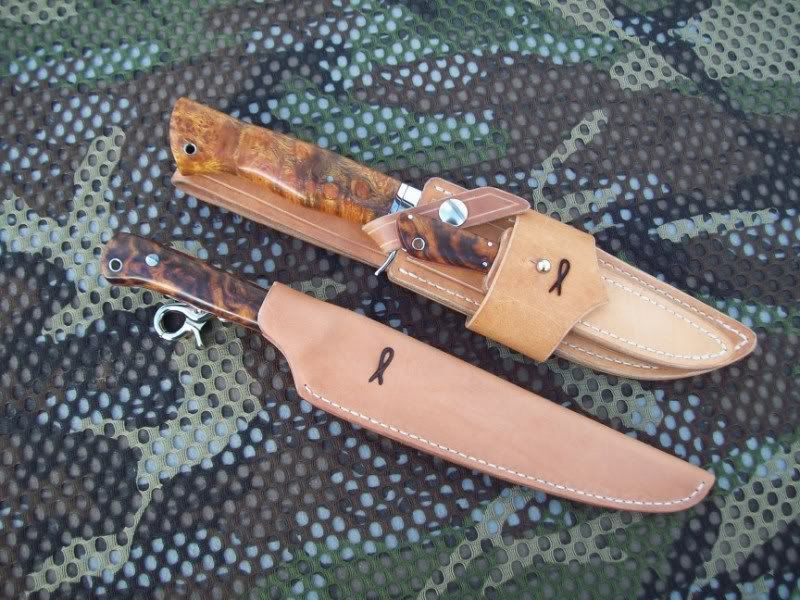

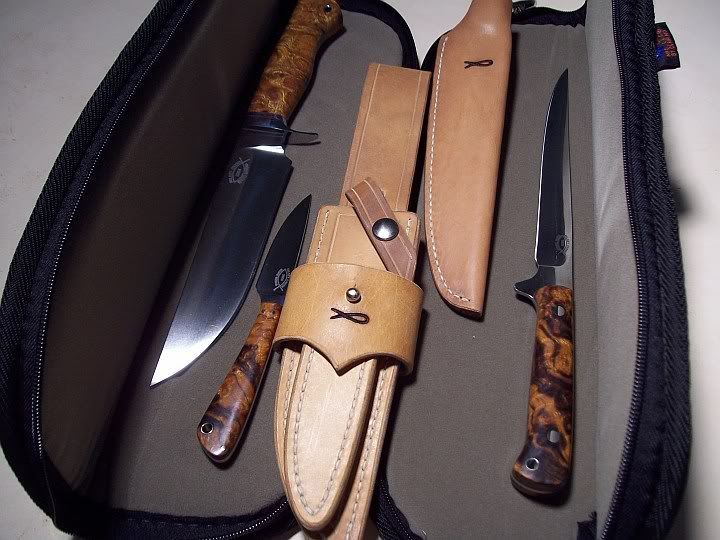

What is the knife in the clip on sheath in the picture with the Camp/Caper combo?
Thanks,
Jay
Thanks,
Jay

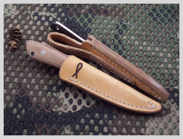

Hi Jay,

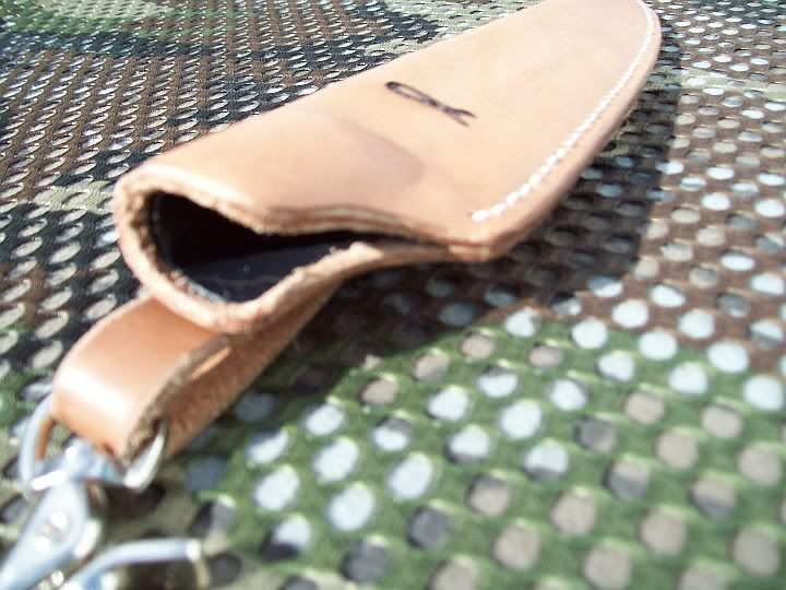

The knife shown below the Camp set is a filet knife. I included a couple of pics for you. One shows the filet knife, the other shows an inside the sheath shot. I took that pic to show the kydex liner, which I first form to the filet knife for a snap fit. Next I wet mold the leather over the kydex and sew it up tight for a nice fit, then give it a coat of neatsfoot oil. It makes for a really nice filet knife sheath. IMHO, long, slim, pointy Filet knives are good candidates for slicing through the side of a pouch style sheath if not careful. The kydex liner helps prevent that :thumbup:

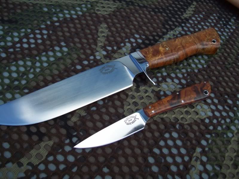

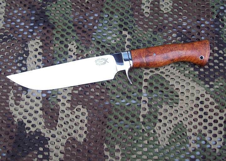

Hi Wong,
The difference between the GUS and the Camp Knife is in construction technique, the GUS uses Full Tapered Tang Construction, while the Camp Knife uses Stick Tang Construction.
There is also a difference in Blade type. The GUS is a Drop Point Design, while the Camp Knife is a Clip Point Design.
Both knives are extremely tough, time proven methods of knife construction. I think you could get into a heated discusion when it comes to which is better.
Although the stick tang may appear to be the weaker of the two designs, I have yet to have one fail, and I've personally beat the tar out of more than a few, trying my best to do just that. I also have quite a few in the field with nary a failure
One thing I'll say about the GUS full tang. If, and I mean if, the handle scales were to ever come off, you could always make an improvised handle from cordage, duct tape, etc. whereas the stick tang may be a bit more difficult to do that with.
Yes, I would be happy to make a Camp Set for you using the GUS rather than the stick tang constructed Camp Knife shown.
Here are a few pics showing the differences in the GUS and the Camp Knife.
GUS
Camp Knife
