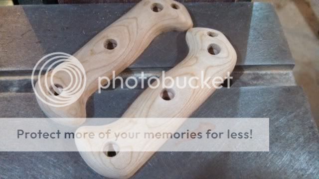

I'm definitely loving my BK9, and while the stock Grivory scales aren't bad I feel like this blade deserves better.
I really like my Micarta scales on my BK2, but I don't want to fork over the cash for another set.
So I feel that hardwood is the way to go. Since I already have some cherry that will be the hardwood of choice.
If it's free, it's for me!;)
I do already have them almost done for the most part. I just need to cut the "slots" for the nuts, do a bit of final light sanding, stain, and oil.
This is what I have so far.
I made each one about 1/32'' thicker so it will feel like my BK2 does in my hand, since the 9 is 1/16'' thinner.
I don't have a chisel that's narrow enough so I might just try and sharpen a screwdriver.:confused:
I'll post some more pics when I make more progress.
Wow, nice work! What color are you thinking for stain?
Can't wait to see them on the King

I think I'm going to go dark, but not too dark, and maybe a bit red.
I figure eventually the blade will be stripped since the paint is already starting to wear out in places.
But I still want them to look good with a black blade for now.
Why not just buy a chisel? They ain't that expensive, are they? And with all the work you got in those scales, don't you want to do it right? Be a shame to bugger 'em up now.
You definitely don't wanna skin a fart to save a nickel and ruin a twenty-five cent knife.
I've got at least 8 chisels, just not one that narrow.
I'll look around and see if I can find something at the local stores.
I definitely don't want to mess them up, but I do have plenty of spare wood to try again if I do.
How about a cheap knife or a pocket knife with a broken blade that you could sharpen the broken tip to make a smaller chisel?

Just an idea, could you burn the nuts into the wood or is there too much material?
Seems if you're going to go dark then it wouldn't mater if it blackens the wood in the nut holes. Maybe try it on a scrap piece of wood.
That thought crossed my mind too.
I might try that if I fail at the slot for the nut.
Call me stubborn but I like a challenge.
I used to have a chisel shaped blade for an Xacto knife.
If I can't find it I'll try and get a new one, or modify one.
The heated nut idea might be the way to go too.
I'd like to figure out a semi easy way since I'd like to make a few more sets for future purchases

Those look awesome.
With that grain pattern, they have a bit of the micarta "topographic" look.
I have one of those x-acto chisel tips. It seems like it would be a hair too big. They do have the 1/8" slanted one, but I don't think I'd have the patience for that.
I'd probably break 3 or 4 of 'em before I finished the set.
I would suggest a method I read about here once.
Take a spare nut, attach it to a bolt and heat it to red hot. Then just push it towards the hole to burn out the pattern.
Best way to do it will be if you put the bolt in your drill-press. If you got one..
