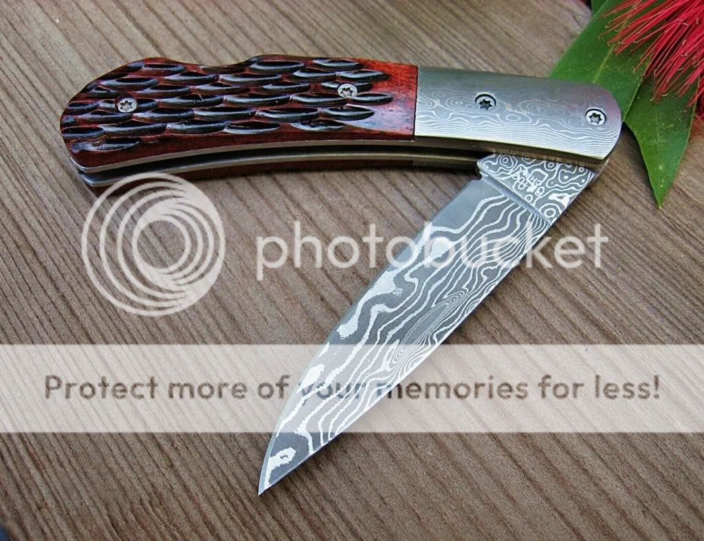

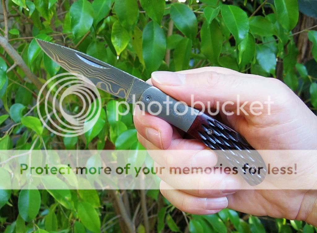

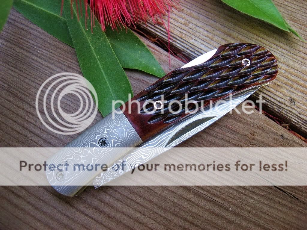

By way of introduction before the photos do the talkin', I'll just say that if its cutting performance and durability match its appearance, fit and finish, this solid little 3-3/8" damascus lockback may represent one of the best knife values I've ever encountered.
The long bolster and hollow-ground blade are "Japanese San-Mai Damascus" with sixteen layers of spring steel folded around a carbon steel core, producing a total of thirty-three layers. The scales are deeply jigged bone and the liners are steel. The walk is extremely smooth (note the hidden pivot), the talk is crisp and snappy (very Buck-like, actually), the lockup is 100% wiggle-free in all directions (much better than my GEC #72 mini-lockback in this regard), there are no handle gaps and the finish is clean, even and scratch-free inside and out. Weight is 2.2 oz. and the OAL is just shy of 6". The Damascus actually looks better than my photos suggest - it has a nice satiny shine and good contrast.
So, what's the big bargain?
This is a freakin' Rough Rider RR1021 that cost all of $19.99. They're also available in a larger 4"-closed version for a whopping $24.99. Honestly, if I didn't know better, I'd would've guessed that this knife sold for around four times the asking price.

I was able to get the just-adequate factory edge on the RR shaving-sharp this morning with just a few swipes on a fine ceramic rod sharpener. I'll be cutting some 1/2" hemp rope to make a parrot toy today, so we'll see how the edge holds up.

I removed the bolsters to check out the pivot, which turns out to be a simple peened(?) pin rather than an adjustable fastener. If the blade picks up any side-to-side play over time, it should still be easy to tighten it up again with a gentle squeeze in a small vice (sans bolsters, of course).
I've been using mine to cut a few sections of 1/2" rope, shave the bark off of some small branches and cut a little non-corrugated cardboard, and the edge is holding up quite well. I'm guessing that the hardness is somewhere around Rc 56 or 57, as it's easy to bring back a grabby razor edge--the type that I associate with carbon rather than stainless steel--in less than a minute. My initial impression thus far is that the steel and heat treatment are perfectly adequate for a small gent's lockback.
