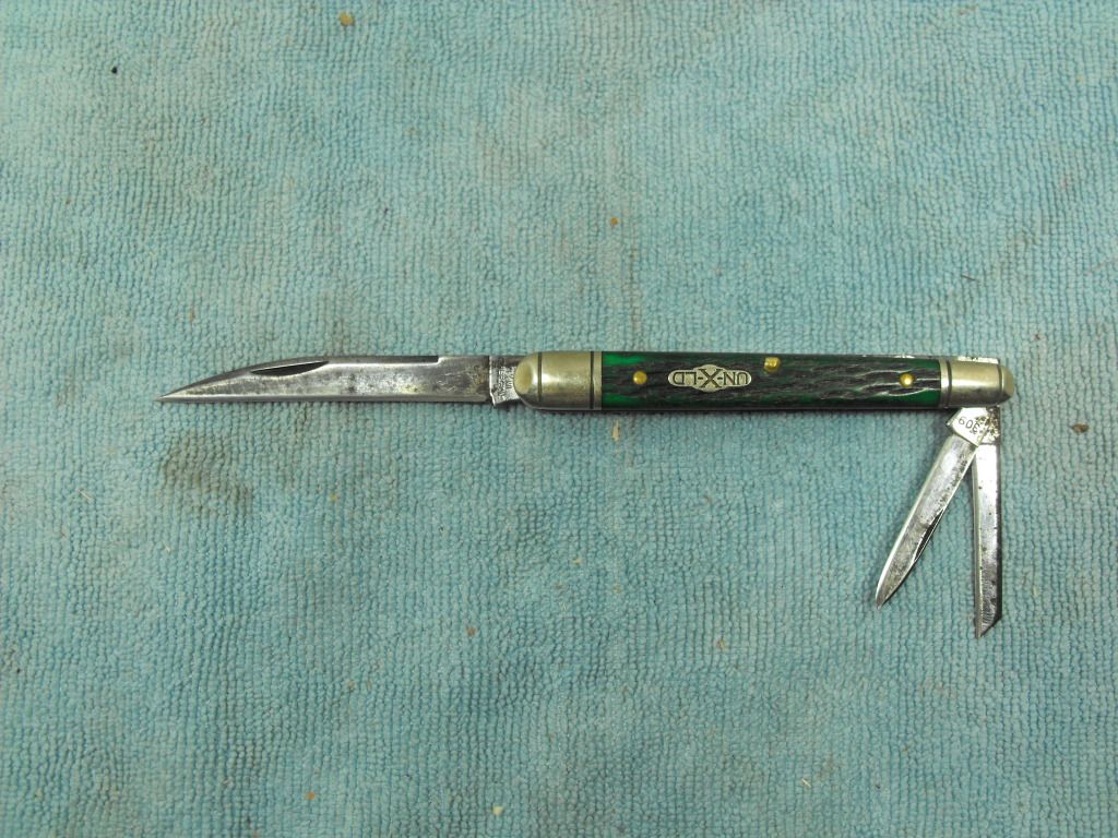

A carving blade that has not been closely reproduced by GEC yet and deserves a look can be found on the elusive queen carver or bulldog brand carving knife. Also the queen/schatt & morgan/northwoods "large dogleg whittlers" deserve a look. I have a half dozen of these in various scales and either clip or wharncliffe mains. You might say im excited to see the split back whittler set up knife on GEC ' S website as it is almost a twin to these large doglegs.
