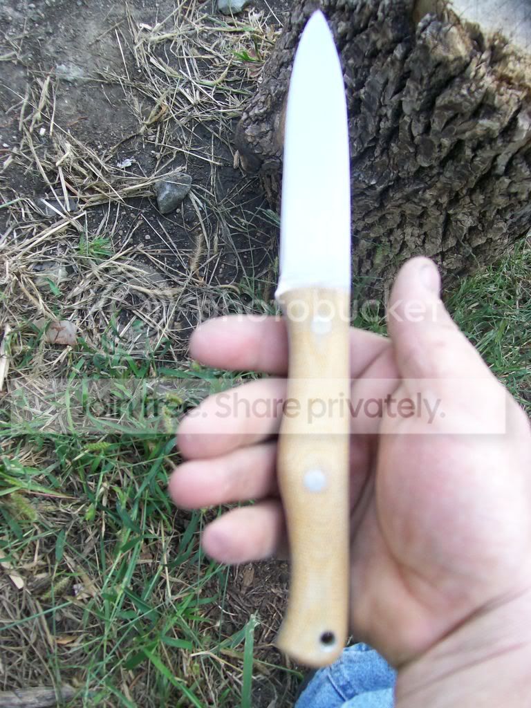

The few pics I have of a knife I made for a fellow who wanted a custom
knife made for him. His knife has an Aurora look. The customer had some thoughts on waht would make his perfect bushcraft knife. He sent me his drawing and the spects that he wanted for his knife. Blade length 4.5" long by 5/32" thick 0-1 steel the blade width at 15/16" wide and a 5" handle with the tan micarta for the scales. Then he wanted a palm swell with spects like the ends of the handle .630 for the width and the middle .850 for its width. I was not sure how that would all feel this was the first time I have such spects like this for the handle. But it did feel really preety good to me I like a 4.5" long handle the best. that extra 1/2" was ok to me. Anyways when you make up or mind between the two knives or want something extra or something different maybe a custom is the next step.
Not a bad looking knife for less than a $100. If I could help you out let me know.

cool looking knife bryan..:thumbup:

Hi Mike thanks for the comments on the knife I made.
Blade frenzy The guy who wanted the knife must have some pretty big
hands to order that long of a handle. This last weekend I invited a customer to come out to where I make knives. He was a pretty big guy his hands were way bigger than mine. Well when he got here on sunday we chatted about what he wanted in a handle length ,after he tried the 4" and the 4.25" and
4.5", 4.75" and 5". He said the 4.75" felt the best. I am with ya on the med. sized hands the 4.25" is the minamal. I like the 4.5" long handle and it fits me the best. Why so many knives and there makers make small handle I do not know. It does not make sense.

Sicily02, that's a beautiful knife...yes, I've thought about customs a lot. The thing is, I just don't know what I'd like it to look like, in terms of functionality. I like the looks of your knife, though...
