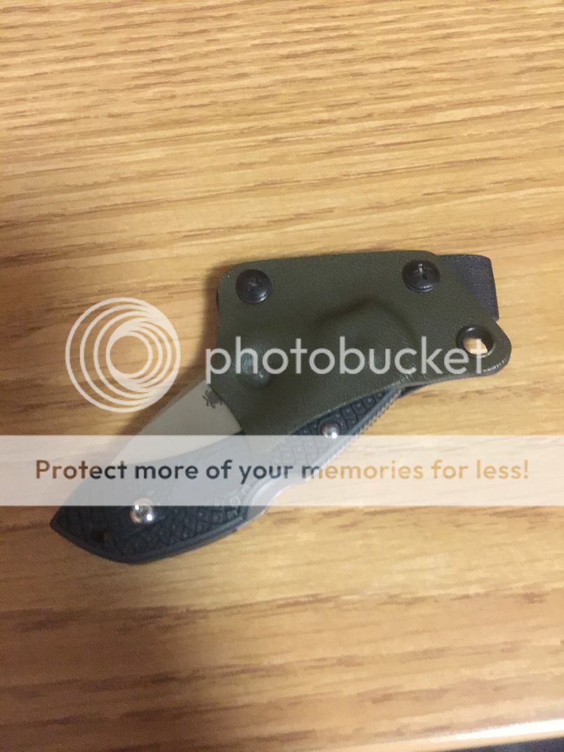

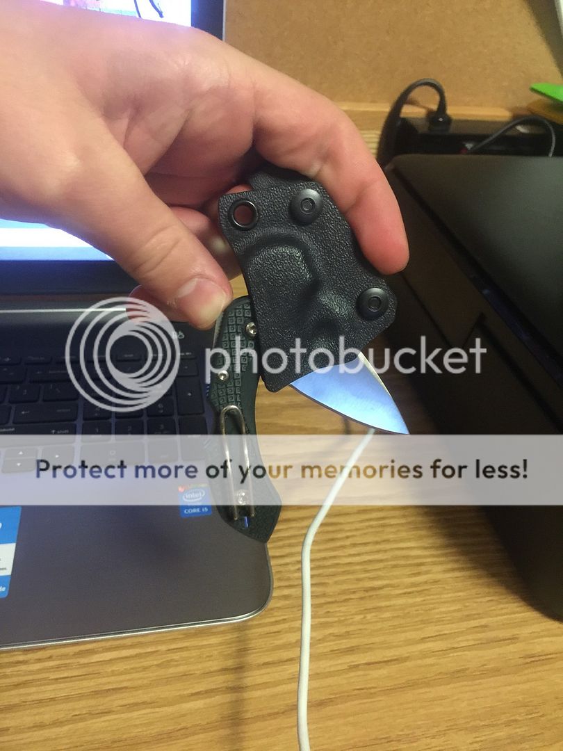

So I have been wanting to attempt making a sheath that will automatically deploy a folding knife when drawn.
Here is my current attempt I have made for a Spyderco Dragonfly, but it only opens up about this much before coming out of the sheath.

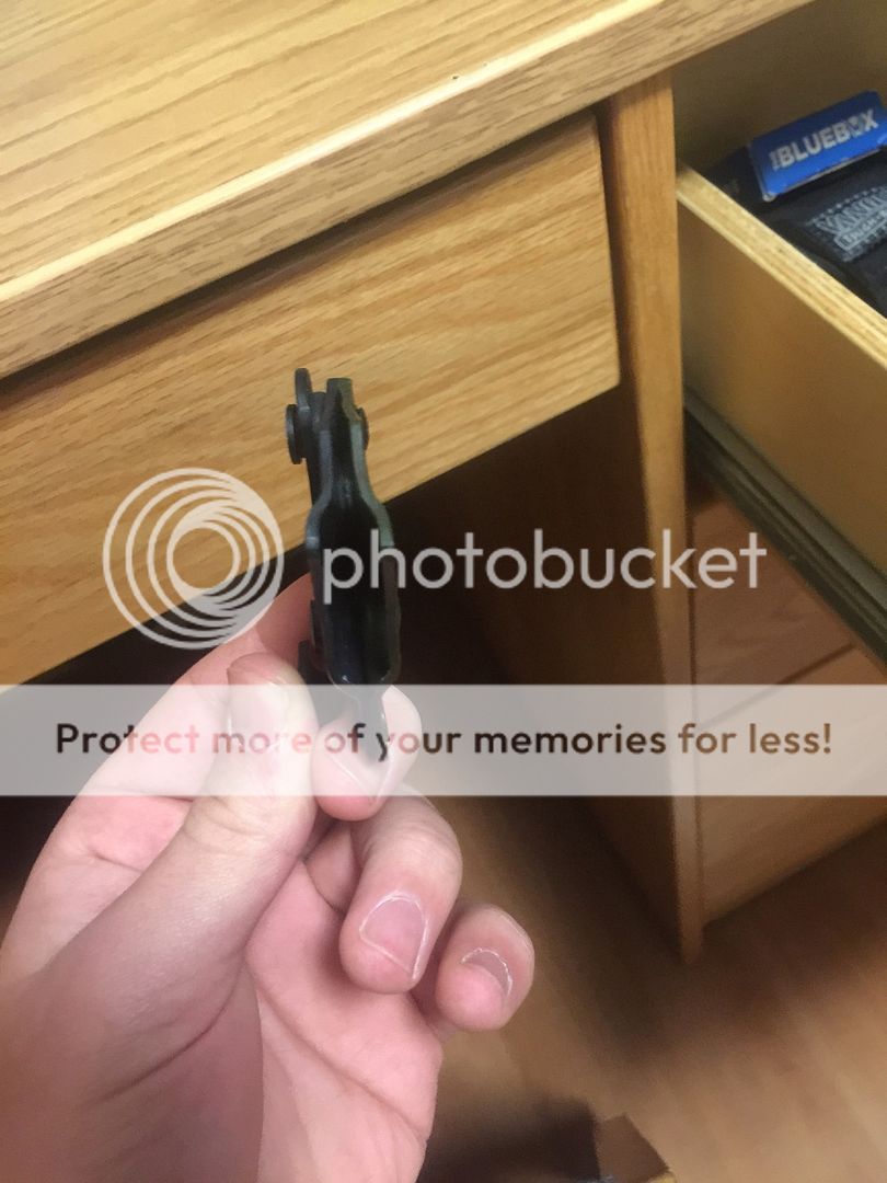

A friend told me to heat up the kydex going into the sypdie hole and push it down more, making more of an indention in it. This should give it more to grab onto and delay it from popping out of the sheath before opening. Are there any other factors that could be preventing it from opening completely?

First pic sheath looks a lot better than second...
Well, the way I have it set up is to be carried at 8 O'clock on my belt. In order to draw it, it would be pulled up instead of down.
And there is only one sheath :D lol. One side is green while the other is black. I believe the angle and lighting just makes it appear different. But I should reheat the top portion again to get a better contour on it. The spydie holes however are both about the same depth.

In the first pic it looks like the blade can only rotate so far before the spine of the blade hits the sheath where the fastener is positioned .
Wouldn't it be better to raise the fastener up a bit and create a slot for the blade to continue opening further before it comes to a stop and then become the leverage point that causes the knife to release ?

Yep make the indent deeper

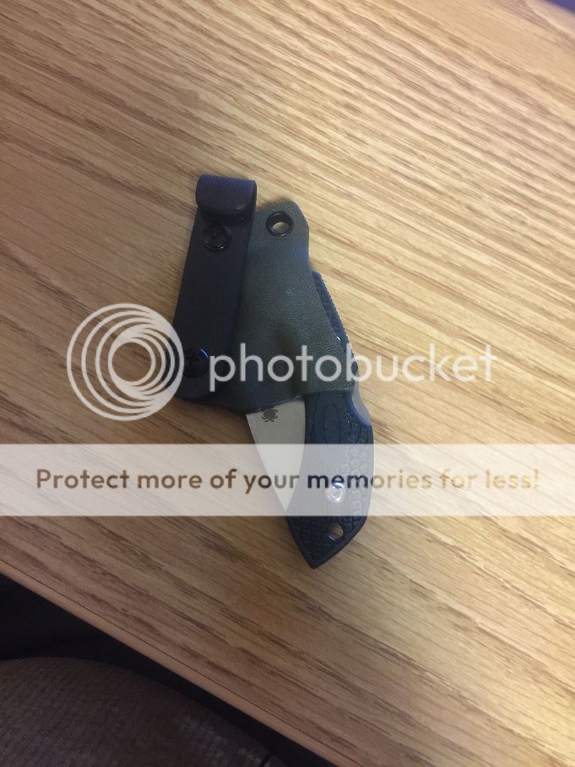

The one that works with the wave feature was developed by Ernie Emerson or for him, and at Blade show in 08 I asked him permission to develop it a bit further, ( it was the honorable thing to do) he said it was fine with him and he told me to go for it.
We are pretty good buddies, I like to think.
and this is what I came up with.
these work much better than the ones that work with the hole.
it can also be done without eyelets:

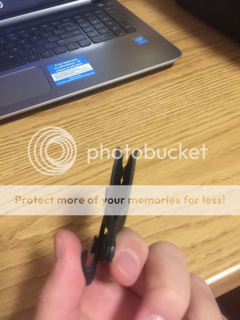

Thanks for the pictures! I've been looking everywhere for a close up of the indent.
So I need to make the indent deeper. Should I make the indent deeper on each side? Or will it just take some experimentation on one side at a time
Does anyone have an effective technique for reheating the hole indent without messing up the rest of the sheath?
I haven't used this technique for this specific purpose, but it has worked for other small refittings. Use a hair dryer and make a cone of some sort to direct the heat. I used a metal funnel.
What ALLHSS said should work. Alternatively you can try cutting an appropriate sized hole in something that won't transfer the heat much and lay it over the spot you wanna heat up.
In any case, watch the heat build up as that kinda thing can get away from you.

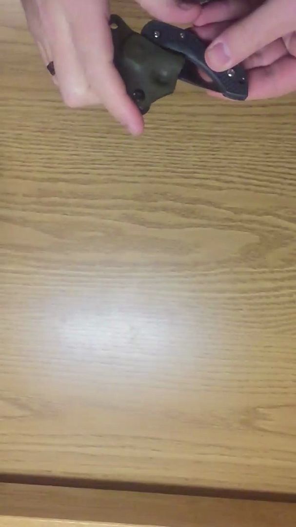

Well, after several hours spent reheating and reforming my sheath, and making two other trial sheaths, I finally came up with a working product.
I pressed the indents down more with a small rod and used a thick piece of metal with a small hole in it to concentrate the heat. What did make it work right was something a lot more simple than I had considered: loosen up the blade pivot. Who would've guessed :D
Here is a video of the opening.

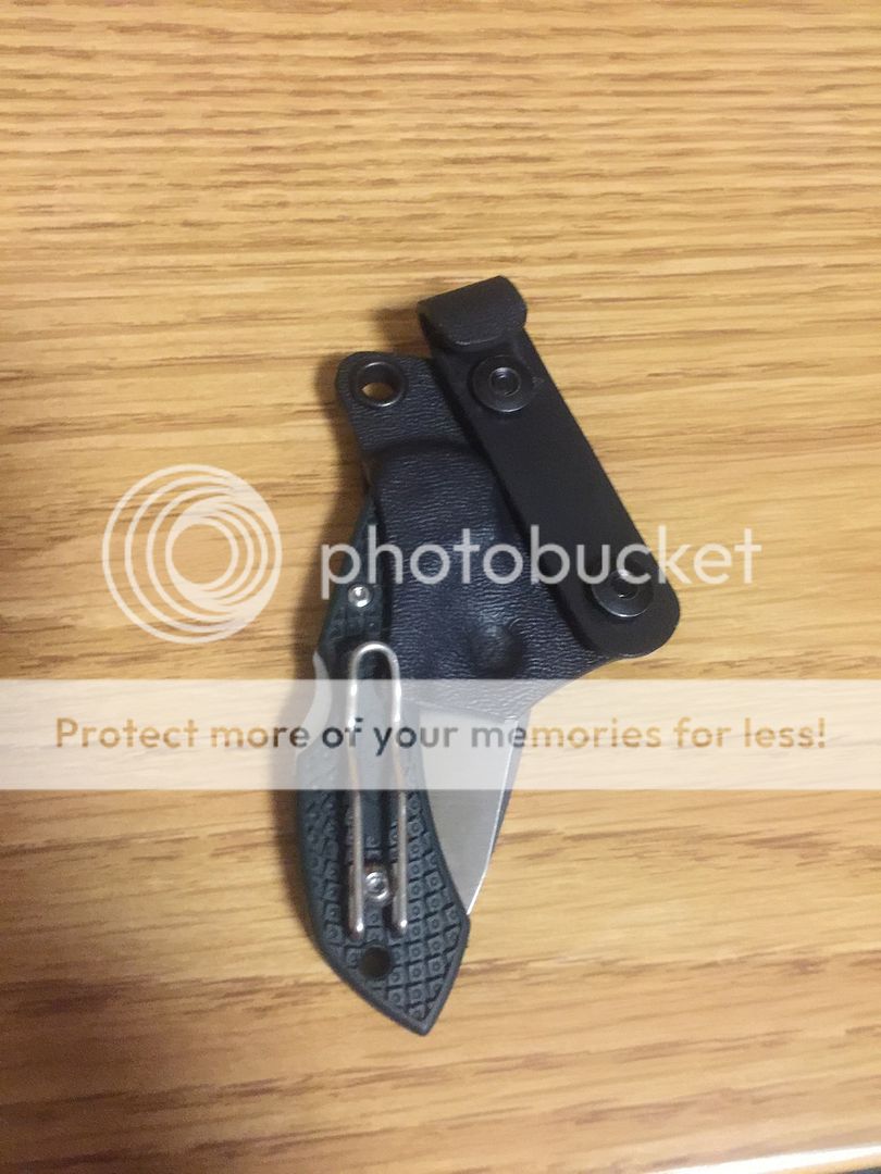

A lot easier when you have a ramp or wave to work with over just a spydie hole. I made this a good while back just for grins. It deploy every time unless you hold the blade shut.
