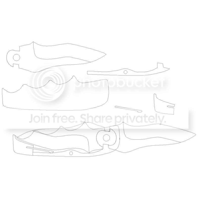

bezier is your friend :D , here's one I whipped out today based on the awesome blades by ken onion, meant totally for my own use if I ever actually make it
also dont hesitate to make a rough physical model of something then scan and vectorize it, I used that method to get the finger spacing exactly right on the above knife, I took some clay and squeezed it like I was holding the knife and let it dry, then cut it in half and scanned it
The bezier is a curve that is kinda like splines, except that the points that you click on will be a point on the curve, and i dont have too small of hands, I wear a size 12 ring
