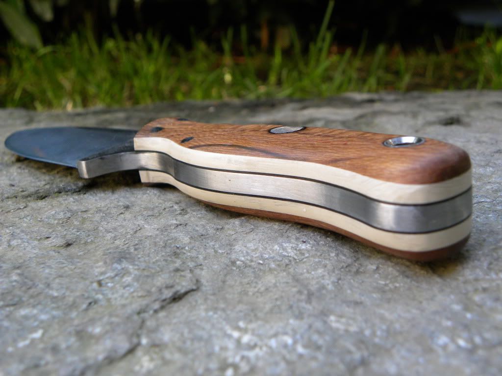

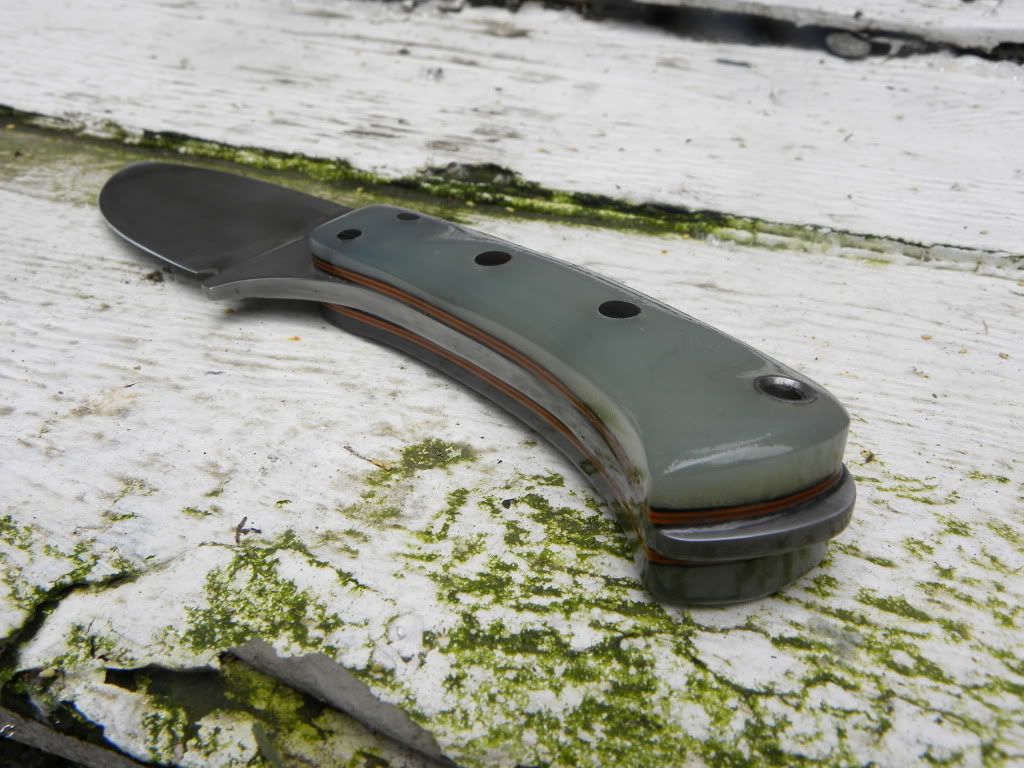

Since I am not doing anything in the shop I thought I'd make myself useful and post a reminder about one of the biggest mistake new makers make. And sadly not only the new guys. I think it is something that is hard to get over and people with a few knives under their belts still seem to struggle with it. I include myself in this group as I have to refine the shape more than a few time to avoid....wait for it...the dreaded...BLOCKY HANDLE!
It is one of the more obvious signs of a beginner and produces a handle that is both uncomfortable (well at least not as comfortable as it could be) and visually not very pleasing. The weird thing is that in theory, it is something relatively easy to correct. But in practice, the fear of taking off too much of that nice handle material you've payed for and worked so hard to attach make it a much harder mistake to rectify.
Here is a simple cross-section drawing (I know, I ain't no Rembrandt) of a full tang handle.
Sorry about the over simplification but there is really not much more to it than that. Well there probably is but I just don't know the terminology to put it down in words. And if you are like me, and prefer books with pictures in them, it'll make more sense anyway.
As you see, a small radius on the corners just doesn't work as where a nice fuller radius gives a pleasing look and an oval shape that fits the hand much better.
A small piece of cardboard cut to the desired radius could serve as a guide to help alleviate the fear of taking off too much.
Now of to the sanding station you go and let's wage war on those blocky handles!
