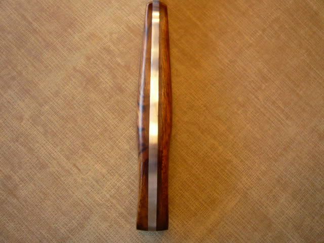

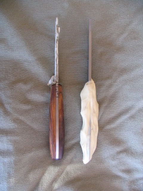

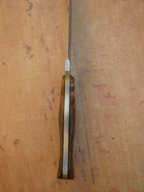

Here is the actual knife I was referring to above...I think it was #5 for me and it was headed for that same blob shape as my previous ones. I asked for some shaping guidance here and someone suggested that I try an experiment with clay, but I really didn't learn much from it unfortunately. These were also 3/8" scales on 1/8" stock...way too thick (at least in my opinion.)
I decided I would go for a contoured shape with palm swell/recess and tapering towards the blade, which I liked, and here is how it ended up. I removed a lot of material on the grinder to go from the first pic to this one. Still not world class by any stretch but far better than it started, and perhaps more importantly, it got me over that mental hurdle of really going after it on the grinder.

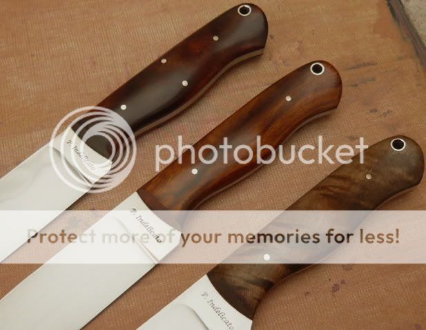

Here is how my latest contoured handles look. I like the way they feel in my hand and I like the way they look compared to a blob or blocky handle. I do 90-100% of this shaping on a contact wheel and slack belt, with perhaps a little bit of tweaking by shoe-shining with sandpaper if I feel the need. Doing this on the grinder is definitely going to be limited compared to what you can do by hand with files, but I'm not sure what I would do any differently to make the extra time and effort required worthwhile. (Critiques and suggestions are welcome!)
Paul those look really comfy, your clay experiment tells me that handles could be more comfortabe if they were made strong hand specific (Left / Right)!
