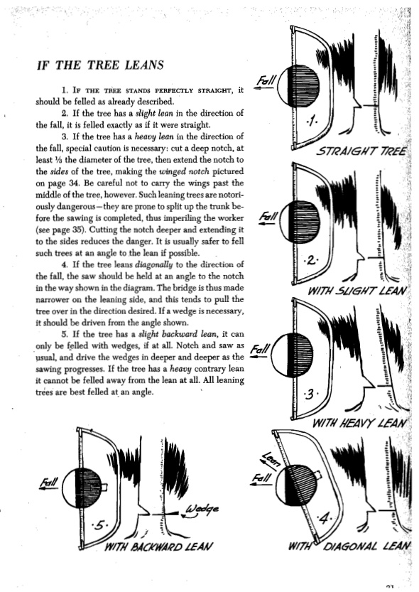

Frederick Koch draws a good image in Bernard Mason's book 'Woodsmanship'. See sketch 4. The thicker hinge wood left at the bottom of the wedge pulls the tree away from its natural lean toward the desired fall line.
Great post Muleman 77. All your advise is right on the money and everybody should see this post before they venture into the world of felling trees. I would add to your comment that "straight axe felling is the least exact, in that all you can do is go with the lean". As you know, in straight axe felling, while you must go with the lean and can not wedge, there is one directional felling technique you can use. While following the lean you can "pull" the direction of fall left or right off the lean. To do this you need to make the back (felling) cut with the hinge wood thicker on one side than on the other. If looking at the hinge wood from above it is sort of triangle shaped. Never cut all the way through the hinge in either corner for any reason. If you want to pull the tree to the left than the triangle hinge would have a larger part of wood left on the left. This makes the right side (small side of triangle) fall faster, thus pulling the tree, going with the lean, more to the left. Sorry, this would be better if I knew how to put a drawing on this computer. It is an old computer and maybe just needs to be sharpened, can anybody tell me where and how to hone it with a puck ?
That's right about the uneven hinge thickness, thanks for adding it in.
