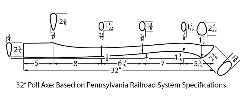

I would love to be able to carve one myself. Maybe I'll try one day.
I found this diagram when I was searching old posts. this would be the pattern I would use.
