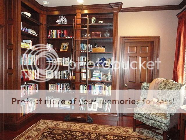

I don't take many pictures of our work out of respect for the owner's privacy, but here is a picture of a cherry library my brother and I built about 10 years ago. A lot of the lumber came from a huge tree that had uprooted here on the farm. The owner was proud of the work and encouraged a picture.
