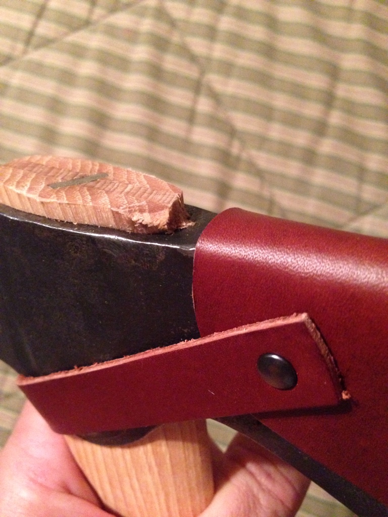

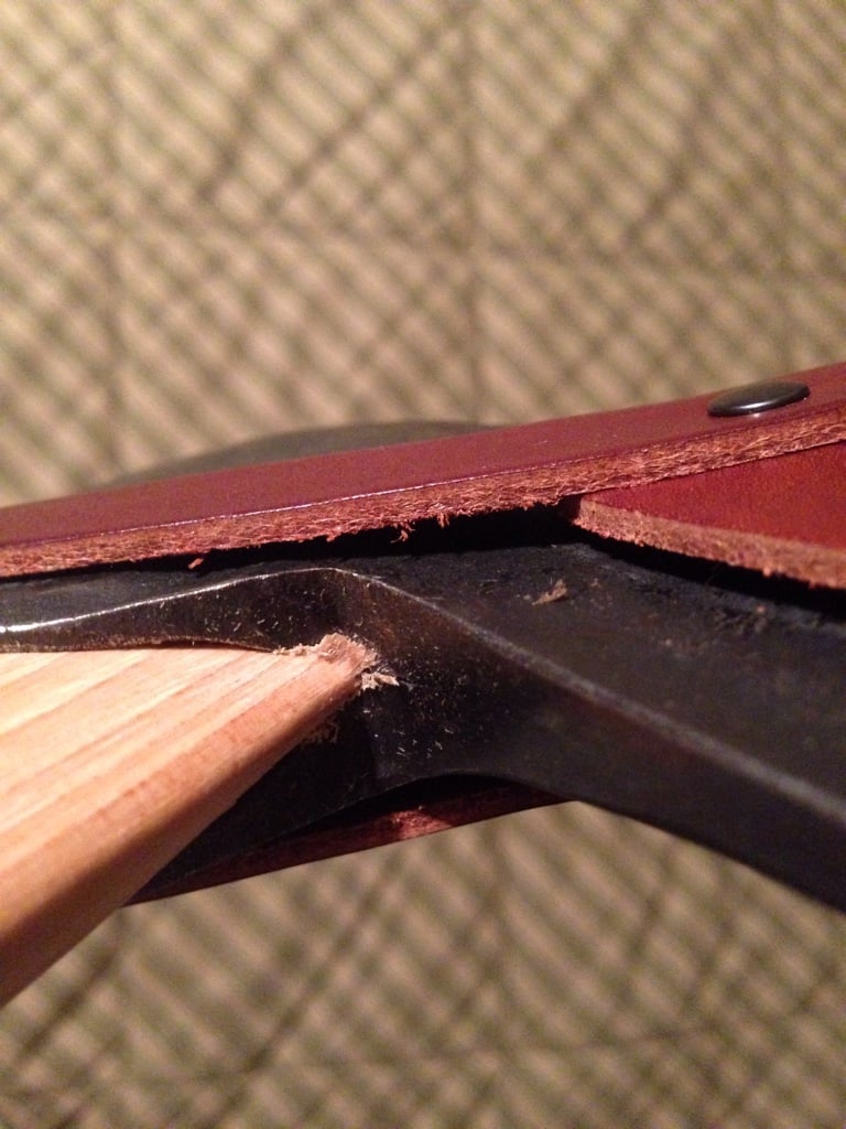

I'm not an axe guy, so thought I'd ask if this is normal. Should I be concerned with how the head is biting into the handle here? Maybe not preferable, but not really an issue? I'll try to keep it simple and leave the question at that.
Thanks
Use a utility knife to carve out the slivers and furred wood. A slope is preferable to winding up with an abrupt shoulder.
Yep! What 300Six said. I always trim that wood off to both look better and prevent those cults from splitting down the haft.
Fit the bottom of the eye to the handle, and let the wedge take care of the top. I would have sanded the front part down more each side until that gap disappeared before final seating. That gap may cause premature loosening of the head when you use it.
Usually the goal is to have no gaps. The gap behind the leading edge of the eye is more of an issue (or so I have been told). Usually you taper the shoulder a bit and when you hammer the haft/handle into the head (put the head on two small pieces of wood at the bit and butt and hammer with mallet) the shoulder should be larger than the eye so what you are seeing happens around the entirety of the eye (a little bit). (hope others will correct or add to what I said if it is not accurate)
I appreciate the input. What I'm hearing is this is normal but the fit is not perfect.

Looks Swedish so you probably don't have to keep the brand a secret. I have a couple GBs and have seen this with many other axes as well - the edges of the eye flare out here and there (or have a slight bevel/rounding) giving you the impression of a gap when that gap is maybe a 1/16th of an inch into the eye. As far as that tiny bit of wood being shaved, trim it, it's nothing, particularly at the front like that. These aren't CNC machined - there is no precision. I don't see anything concerning but pictures don't always tell the whole truth like holding the thing in your hand.

I'll echo what COTS said...trim it and forget it, and small gaps are not an issue. Those heads are hydraulically seated to ensure a tight fit. It's not going anywhere. That top wood is probably going to get dinged up through use anyway. It's not a big deal, even for a high end axe. And the ding could have come from the supplier, from shipping, or packaging. It's not necessarily the fault of the axe maker. My GB SFA has a similar ding.

Looking at the picture of the top and looking at the video how those handles are put on, I would agree that handle is ok. I was writing before as what I would do to get a perfect fit when I put a handle on. There is a difference between how an axe factory puts a handle on and a home replacement.

Especially with an axe (striking tool), someone had to use a striking tool to make another striking tool. The haft was hammered into the eye and then the the kerf wedge was hammered into the kerf slot. Unless its going to be a wall hanger and you will never use it... a few over strikes or misses and you'll never know it came looking like that :)
