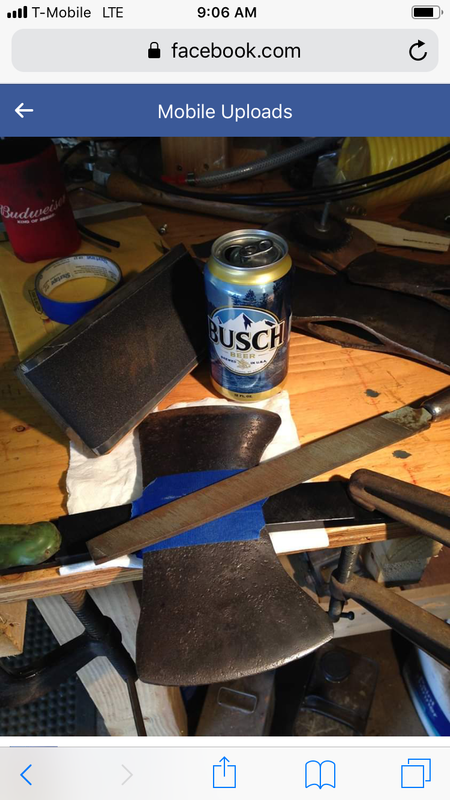

I've just gotten into rehabbing old axes. I have limited space indoors during the cold weather, and my reloading bench is seeing double duty as a sharpening station. This is what I'm stuck with, and am looking for recommendations to make this better. It works ok, but the position of the clamp limits the travel of the file so it take a lot more time and effort. I only have files and a puck, no belt sander/grinder.
I've looked all over the net for plans/pictures of clamping jigs, but no luck. Any suggestions?

well, what you have right now with the exception of a vice is pretty much how it's done. might consider and angle grinder

You should be able to do just fine with your present setup , just keep the dust , filings and other swarf away from your reloading equipment.

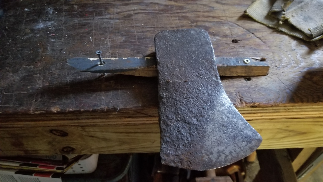

What about a strip of steel with a thick- ish pad on it , a hinge on one end and latch on the other?
It could slip through then clamp down and with the pads would hold tight to various wall thicknesses.
I'm just not doing enough heads to need any kind of setup for it, but this is what I'd make when / if I can start acquiring more.

Or screws. I just use a piece of wood like shown above. Or my vice. Frankly that works best for me. Do you have a vice?

Nah just clamp it between a couple strips of wood in the vice laying sideways. I'm off to dinner with family but I'll take a pic of that to illustrate it in the next day or so. Unless somebody beats me to it! I, like D M, don't sharpen till after it's hung. I like to file first in the vice.

I would block the head in the vise using strips of wood for either verticle or horizontal vise sharpening. Protects the head and adds stability when sharpening and applying pressure with the file.
