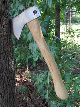

Other no name HB patterns without the unique TT shape could be a number of things. When that sticker is gone it makes things more difficult. Could be S&N with missing label. Could be Forest King with missing label etc...those two are very similar and both had metal wedges. There are unmarked heads that match the Collins pattern as well. Herters sold one of those. Photos always help.
Here's some photos of my no-name. Very blocky.
