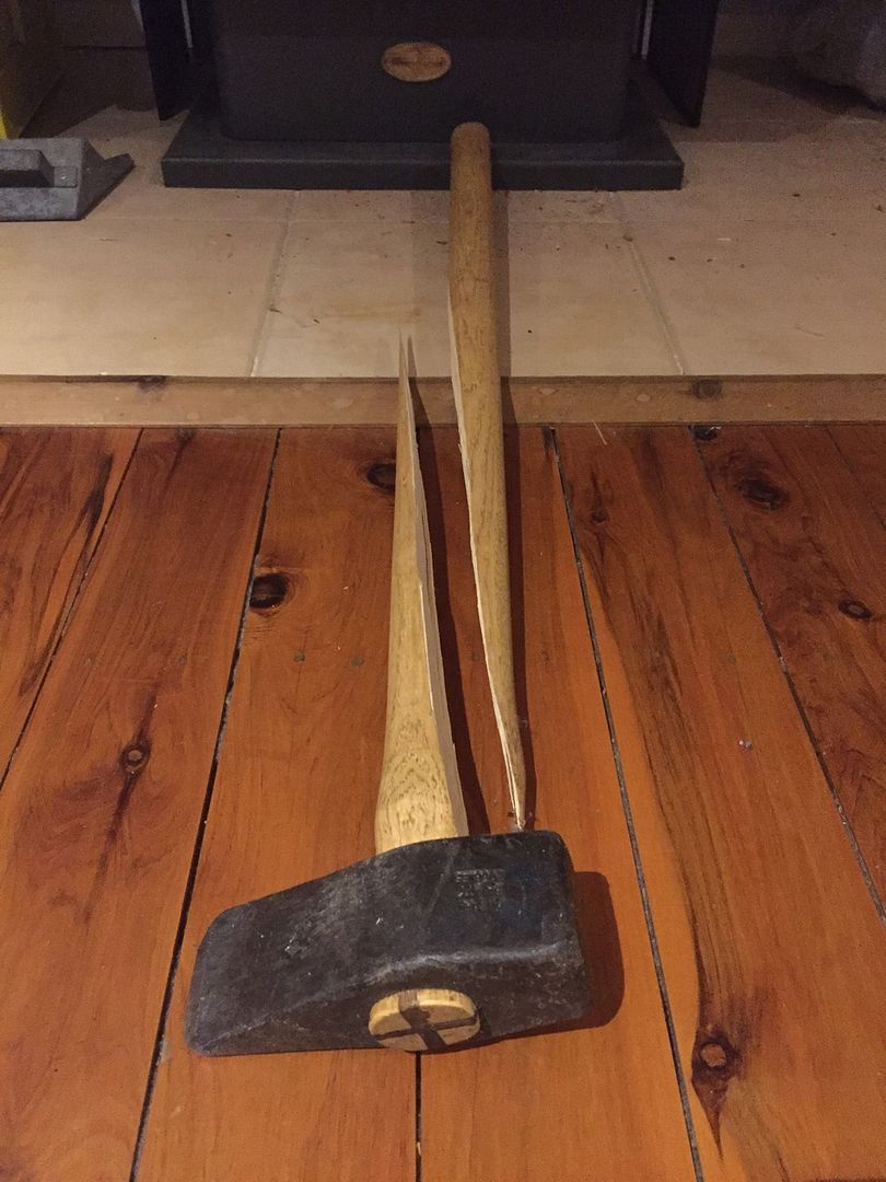

After watching Wranglerstar's youtubes on restoring and hanging axe handles, found a suitable splitting maul head on eBay and then headed down to a large hardware retailer (Masters) to pick up a new handle for it.
I looked through the whole shelf and found the straightest handle with the straightest grain in the correct orientation. I also bought a couple of bastard files and a rasp.
I filed down the handle to fit the eye of the maul. The top of the eye had a gap all the way around it between the handle and head, so I decided that I needed to have a cross wedge. I cut up some wedges and fitted them tightly. I left the head slightly proud and treated it all to liberal doses of boiled linseed oil. I made a reservoir around the protruding handle at the top and made a pool of BLO so that the oil would penetrate (just like Cody said).
I split some seasoned gum and the head held up nicely on the handle. I cut about two or three cut logs. On the second day I split some more seasoned logs, then thought I'd try some freshly cut jackaranda logs. I'm pretty accurate and didn't over strike so I was surprised when the maul bounced and my 'new' maul handle was broken. I checked and there was no evidence of over strike. The handle had had snapped clean. The crack line is definitely not running from the cross kerf. Im a little lost and put it down to poor quality wood used by the handle manufacture.
Any ideas? Can anyone in Australia advise me where to get quality axe handles? I know that there are quality Australian made ones, but I can't find anywhere that has good quality ones.
That's real bad luck! Looks to me like you did a beautiful job of hanging that head too.
Here's a question for ya': sight down the length of the handle and look to see if any of the grain cuts across the handle's axis. End grain orientation is only part of the equation and I see some possible signs that you may have had runout issues on that handle, though I could be wrong (hard to tell in the pics.)

42, you're spot on. On the grain runs diagonally across the length of the handle. This might explain why the break line runs diagonally down the length of the handle. Wish I learnt this info beforehand, but it's all part of the learning experience. It'll make the task of finding a decent handle even more difficult.
Thanks for your insight.
Kiln dried hickory is basically lifeless wood. From what I've learned on this forum, from men who have worked with trail crews, that type of failure is common. For the record, l've never witnessed an air dried handle failure in my life.
Looks like a classic case of runout. Maybe a bad piece of wood to begin with, too. What a shame after that beautiful hang.

Offhand I didn't see any glaring evidence of obvious grain runout on your photos but then again the break itself does look suspicious. I'm once again (which will generate a groan from regular forum members) going to post my illustrative picture of severe 'grain runout'. Handle on the left is 'lovely' whereas the one on the right is 'an accident waiting to happen'. Now, with curved handles you also seek vertical end grain because of the horizontal curves inherent to such a handle will create run out if you use horizontal end grain. But in the case of a straight haft (such as for a maul or double bit axe) it really isn't that crucial whether end grain is horizontal or vertical. In fact diagonal might even be ideal under those circumstances. But what you don't want in any wood handle is length grain running out somewhere along the way.

You only ever do that in an emergency and with the expectation that you will only get one more strike with it. I tried various glues on rake, shovel and wheelbarrow handles many years ago and not a one of them held up. There are other things at work within pieces of wood that have fractured, that no mere glue can rectify.
Get a new haft and do another beautiful hang. I like the shape of your maul. And try not to watch Wranglestar.
