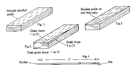

Straight grain (fig 1) vs runout (figs 2 & 3):

Actually, run out is only the result of sawing or more specifically cutting at an angle to the wood fiber direction. I've rarely seen wood split at an angle to the grain, and only seen it in relatively weak woods that would not be used as tool handles.
That this break happened so quickly leads me to agree that the handle had other problems - some of the possibilities have been mentioned already - but it broke in exactly the way a run out handle breaks. Usually it just takes a lot longer. The vast majority of the machine made handles I've seen do this, because they all have run out to some degree or another. The industry and customers have no interest in paying $50 per handle - which is what I would guess (completely made up guess :D ) they would cost if started with riven billets.

Bob, your new picture perfectly illustrates runout so I'm going to use it to demonstrate.
grain_runout2 by city_ofthe_south, on Flickr
The red line illustrates how the OP's handle broke and the board in the picture also perfectly illustrates the OP's handle grain orientation. Bob, my point is this with "across"; just because it is not 90 degrees perpendicular does that make it no longer "across"? I am using the term across because while it is not 90 degrees perpendicular (it's far more acute or obtuse I guess, depending on how you look at it), it is not WITH or ALONG the grain. How?
The blue line indicates how a handle WOULD have broken if it had broken due to runout. That lower picture "figure 3" perfectly illustrates ACTUAL runout and you will note that the break is what? Yes that's right, exactly the opposite.
Now, please take a look at your own pictures. This one indicates runout exactly as we all understand it. You will note that it is completely contradictory to your image from page one and everything that guy says in the link. How is it contradictory? Because the picture from page one illustrates quarter sawn lumber with a pink line running at an angle on the face of the grain. This handle, and the image above all illustrate flat sawn wood and unless I am still missing out on the joke, runout breaks occur WITH the grain. However, that guy is specifically talking about what is exactly illustrated with the pink line in the picture from page one. And he is consistent is calling that runout. He even demonstrates it.
Server problems are killing me over here. I will attempt to complete my other post later. Point I wanted to add is, and I was trying to say it in my earlier posts, this new image illustrates two kinds of runout. Fig 1 has none. Fig 2 has what they are calling sloping grain on the face, and fig 3 has both. The guy in your link is talking about the figure 2 type of runout. My point earlier was, this type of runout would happen on curved handles no matter what, and because it is difficult to see, it would also seem to happen frequently on straight handles as well. We typically attempt to avoid the kind I am trying to illustrate with the blue line. Ultimately the point is, the "on the face" type of runout can't be terribly important because if it were, we'd break a lot more handles.
