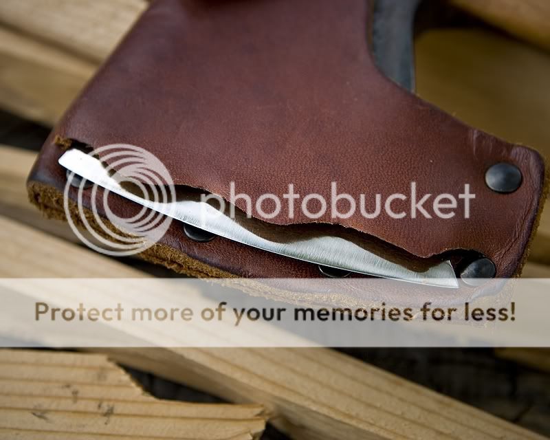

Personally, I would not hammer with a kydex sheath on. You have to remember when you hammer with the poll, the same impact is also being imparted from the sheath to the cutting edge. Kydex sheaths do not have a welt, and eventually, I bet it will force the rivets onto the cutting edge. Ask me how I learned this one :D
As you can see, even the welt did not stop this from happening, and the rivets did damage the edge on the way through :grumpy:
It seems like the safe thing to do. Hammer with the case on. For a long time, I was hammering without one. Now, I started making my own sheaths with a thicker welt, and have not had an issue. But, time will tell more on that one still.

I read somewhere, probably Kephart's book, when making a sheath for an axe, put two thin sheets of brass in your welt and spread them apart a bit to keep that from happening. I can see where that might be a good idea. Maybe metal from a soda can would work as well. I suppose you would have to be using copper rivits to put it together.
