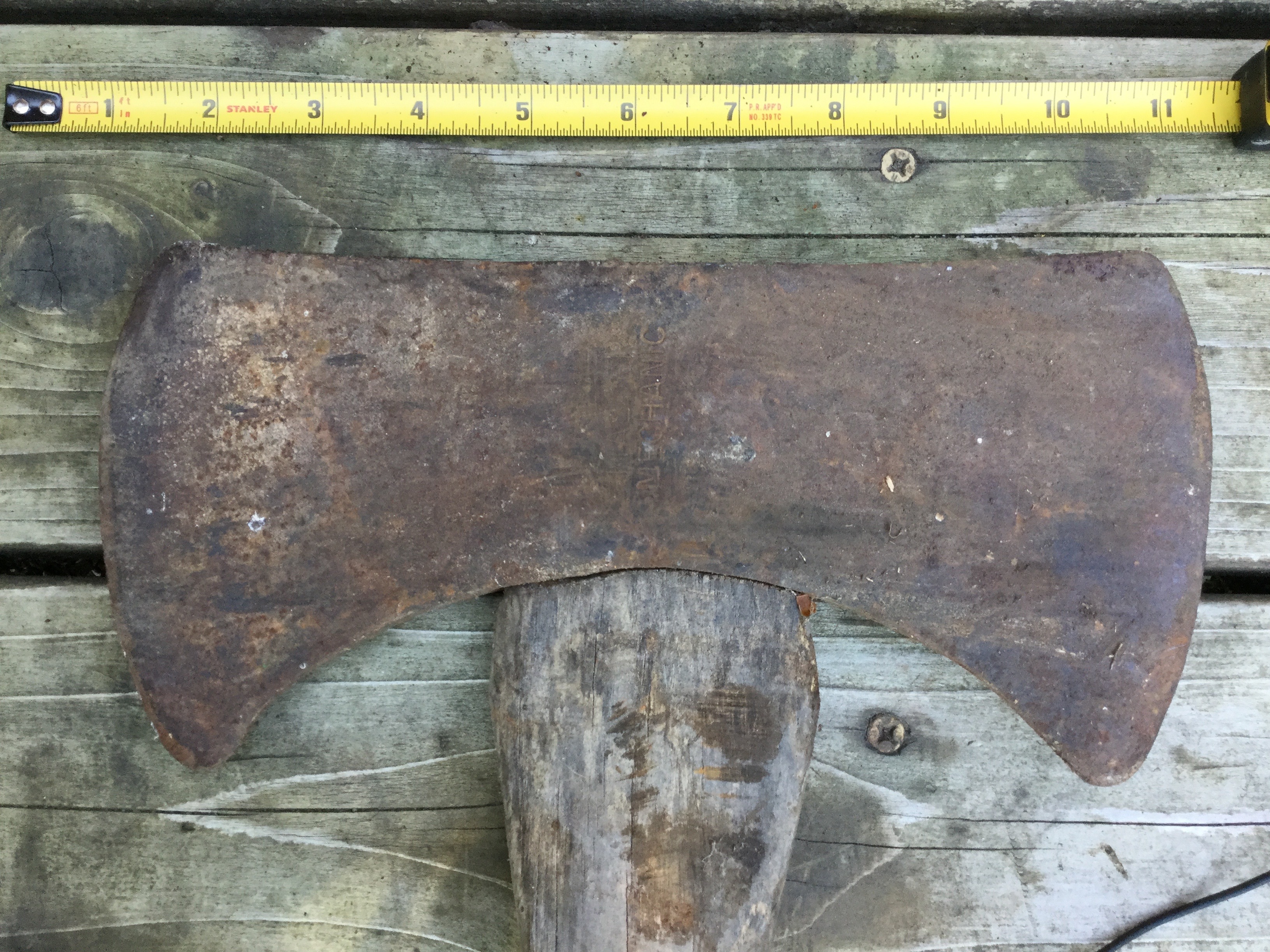

Collins
Has an "M" and possibly a light 3 1/2 stamped on it.

It was a common practice for one bit of a double bit axe to be kept much thicker for things that could damage or prematurely dull their good sharp bit, so it may not be too far off from where it needs to be.

You don't get much for $150 these days except for a bad headache following 'a night on the town'. The 'no name' you show looks to me to be a classic Plumb "National". I always thought this pattern was proprietary (and therefore Plumb stamped) but then again perhaps not all of them were. In any case Nationals were introduced after the war (in about 1947) and were probably discontinued when Ames Industries took over the Plumb name and facilities in 1971.

The Collins under the Sager is what I think of a swamping pattern looking like. A friend of mine calls them a peeling pattern.
They balance well, cut well, but don't have a following like other patterns. I've learned to like them.

I'd bet you that 1st unmarked axe was soaked by someone in vinegar, the heat treated portion of the bit will darken like that when soaked in vinegar. I haven't soaked in vinegar in years, but not as bad as people make it out to be, just dump some baking soda and scrub it in afterwards, then rinse and wipe dry and they'll be fine.
I am with you on the swamping pattern. I think the 4lb Plumb is a peeling pattern.
Those big swiping patterns where really popular out here. Like you said they are really a nice pattern.
