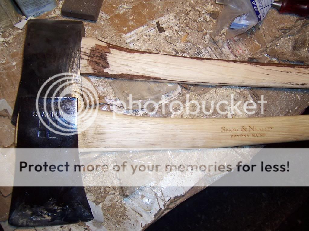

do those coats go on before the head is installed?
I would assume that the more oily moisture you get into the handle, the less evaporative water moisture you'll have problems with later... hm.
I only apply oils after hanging. I want the eye wood of the haft to be able to soak up my wood-swelling solution when I wedge it.
