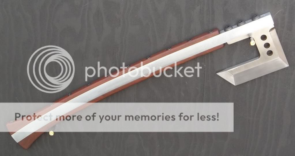

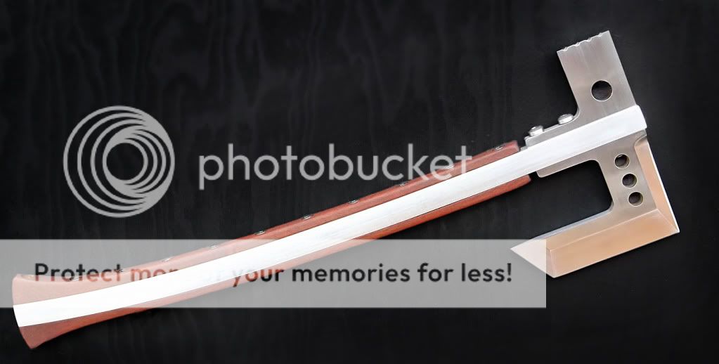

This one's coming to Blade too...
S-7 steel over 1/2" thick, reversible blade with 3 cutting edges, removable breaching hammer, 6061 aluminum alloy shaft, ipe wood handle, 25 grade 8 socket bolts
More when I can get time...
I'd like the first configuration better if the haft was assembled with the curve facing in the opposite direction. :D:thumbup:
thanks all, I tend to put the blade on the outside of the curve because it feels more slicey, while the hammer on the inside of the curve just feels destructive. This piece has enough weight that the slicey side is crazy destructive too! It can be mounted fully reversed but this particular one is optimized ( the third 3/8 bolt is hidden inside) to have the hammer on the inside of the curve.
