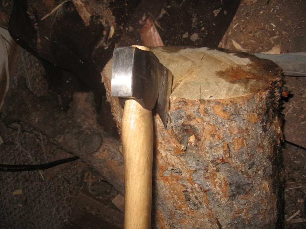

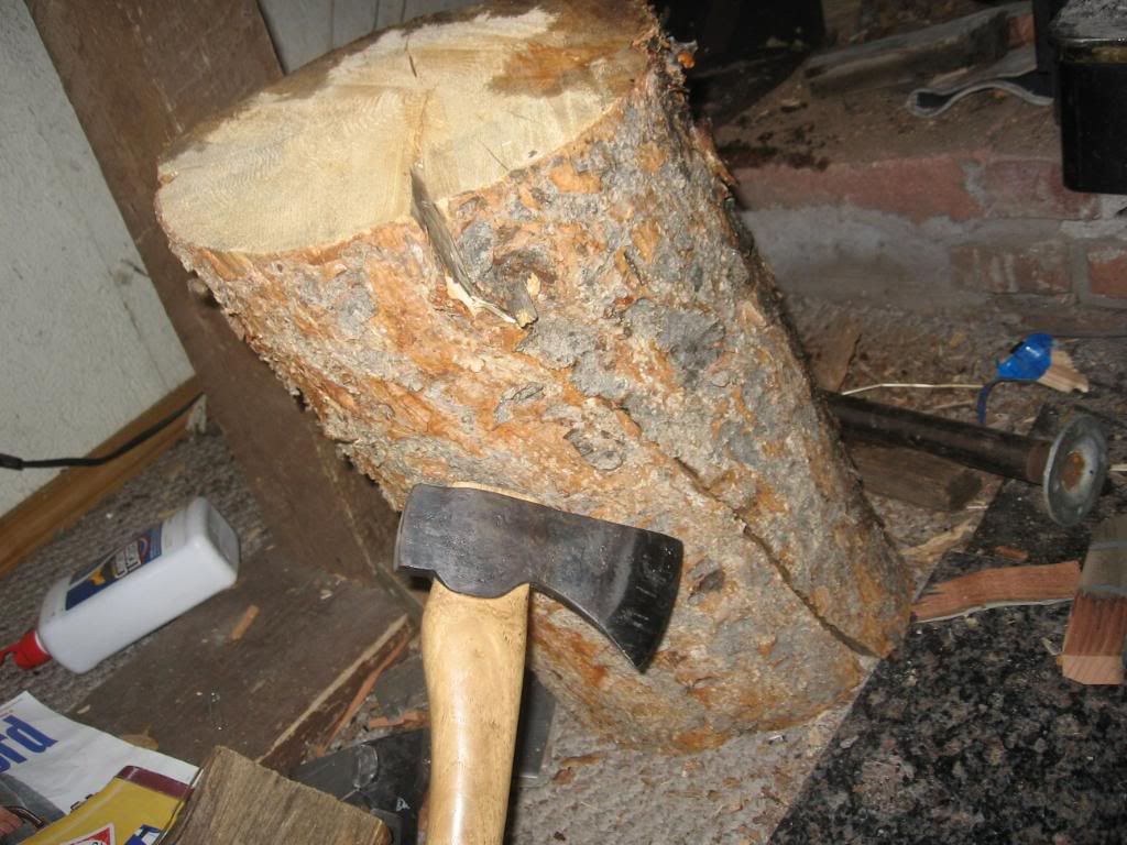

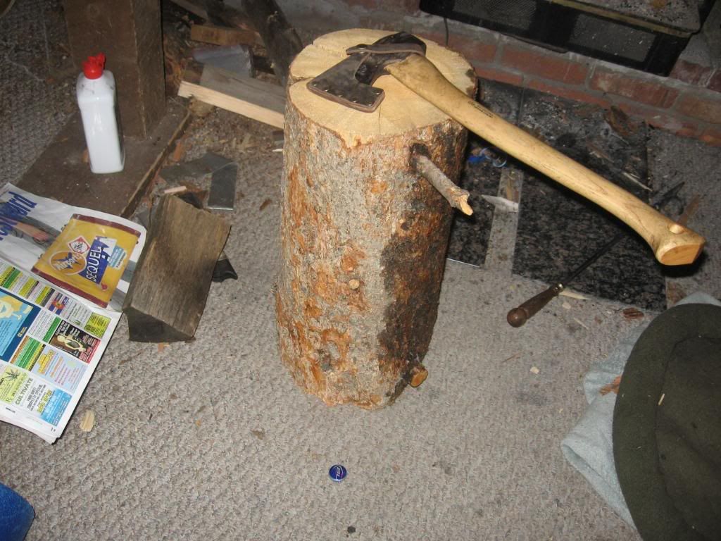

Here are some pics of me splitting a log with my 19" wetterling. This is why I prefer the traditional design. the flat Axes take far more energy to do this.
Start on the top edge, in alignment with the grain.
Switch ends, same side.
Switch sides and pow, the log splits because of the geometry of the bit. I use a baton to do this. Don't swing it!!!!

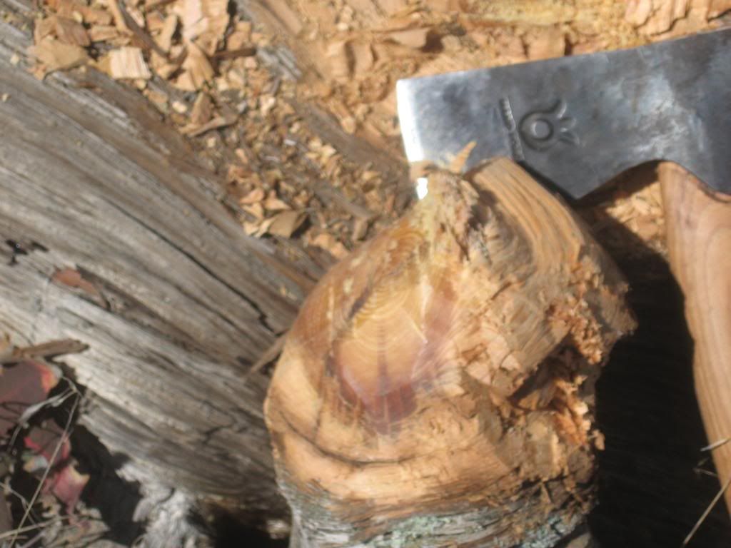

The Husqvarna has the same geometry as GB. Here is a pic of same very seasoned, very hard wood I harvested for carving. Had no issues of edge rolling or chipping.

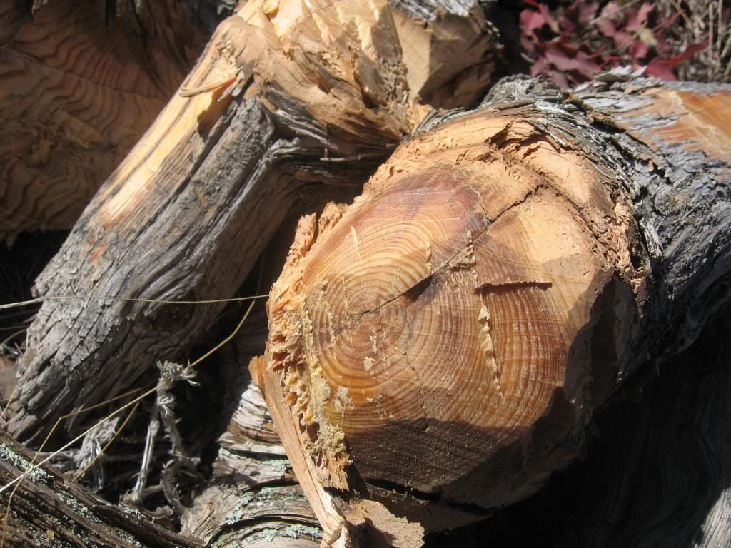

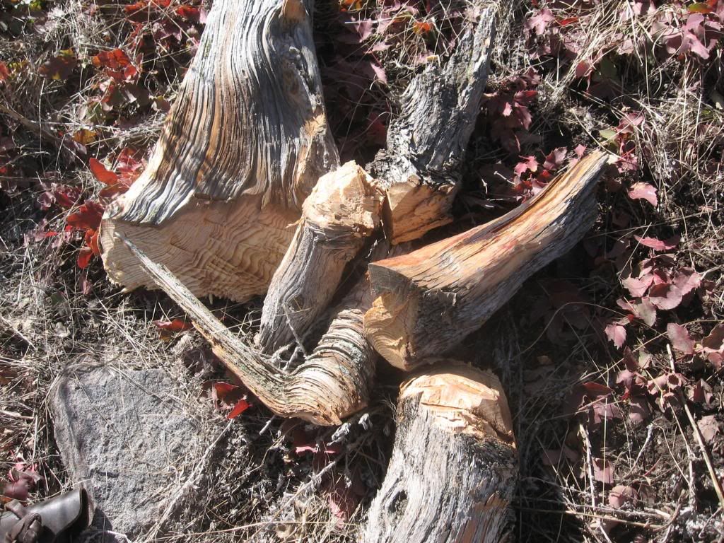

The wood was so hard it made the hatchet ring like I was hitting metal.
It shattered as much as chipped.
The six pieces of wood weighed in at 47lbs. Heavy stuff!
This wood can also be used as fatwood. Very oily!!
