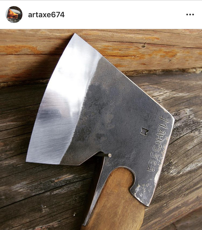

Our usual Thanks:) to Agent_H for making photos bigger and better,that axe of MA's on that last photo says "Mangazeya" along the poll,in chisel marks,so why not let that be the type name?

I'd like to add that this type,the Mang.,is wonderful and mysterious(i've had a few go's at it and was roundly defeated;my hat's off to MA,he's a great smith!)
It has a reverse taper in the eye(my feeling is that it's an Ugric tool and has nothing whatever to do with "russians",whomever we mean by that term),it's angle of convergence is very odd in that it's steep,yet somehow very graceful,it's a short compact powerful tool,like some mini-piilu or something...

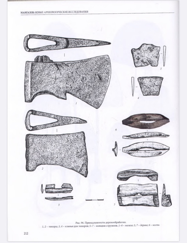

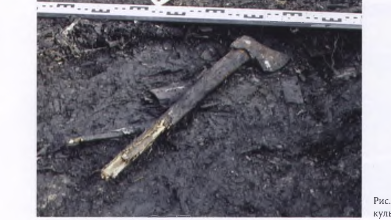

here are a couple of screenshots of the axes:
