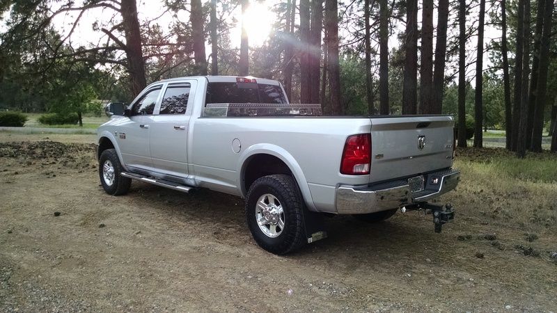

The last Ford I owned was a 1991 F-350 CC 4x4 with an 8 ft bed. It didn't turn great, but it wasn't horrible either.
My Dodge actually turns fairly decent for a long pickup. I drive it every day, everywhere. My buddy has an 04 Dodge CC 4x4 with an 8 foot bed and his turns horrible.
I guess that wasn't uncommon in that era of Dodge.
