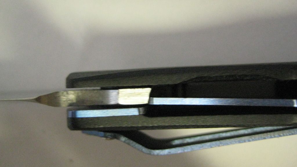

It has a linerlock mechanism for locking the blade. The liner stands well on the blade. I have no doubt, that it will keep the blade safely in its position without closing accidentely. BTW: It´s no heavy-duty-knife at all. This is what knives are built for, formaly - Cutting. It has a single-liner construction, which makes the knife loose weight.

The blade (440C) is slightly off-centered, but it has no bladeplay. Ok, that´s a small issue. But as long as the blade doesn´t rub against the liner, it´s ok for me. About the blade steel: Böker uses the 440C even on their Solingen made knives and they do a great HT on them, imo. The combination Böker & 440C is a very good one :)

I have similar blade centering issues on mine. Not a big deal but I'm trying to fix it.
When I apply pressure on the pivot, the blade moves towards the center, then moves back when I let go. It seems to me the pivot holes are drilled too deep, even when the pivot is at its tightest, it is unable to press on the blade with enough pressure. I'm thinking of applying something to fill the pivot hole, maybe by 1/2 mm. What do you guys think? Any suggestions on what to use?

problem solved. I had to unscrew the pivot and take out the blade entirely. After I put it back it is dead center. Guess there was something in the pivot.
