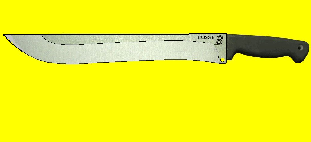

Man, every time a look at the sketch of the 13olo, I get more and more into it... What a good concept! What a good profile! Let's get this going!!!

What was the reasoning for no choil? Maybe missed it. Also, I know some people really don't like choils.
It's a practical lightweight function over form outdoorsman concept for wood chopping/splitting, bark peeling, brush clearing & grass cutting. Imagine being able to go camping, hunting, backpacking or living in the woods/farm/ranch and being able to carry your axe/chainsaw, machete, draw knife, wedge & scythe all in a package under 1.5 lbs in a sheath on your belt/pack/horse/atv/motorcycle/truck/tractor. It will do just about anything else one could need while providing features not yet combined on an INFI res-c design, believe me, I've tried them and I live in the woods where these tools are regularly needed.
Keeping the goal in mind:
1. A choil creates a snag for brush/vine clearing & scything that takes away from the benefit of the recurve pulling material into the cut, that's why there is no choil on a karambit, khukri, sickle, or scythe.
2. Ten minutes with a drum sander either by Busse or the end user can add a choil, but one can not be removed.
3. Almost everyone who will own a 13+ inch blade will also edc a small knife for detail work, we are knife people after all.
4. The basic 10 was the only INFI res-c chopper to be offered without one, but it was too short and lacking the benefit of a recurve to really take advantage of it.
I think the regulator handle is similarly shaped & would work excellent on a khukri with the ~16" OAL.

1: I have noticed that myself, actually. It even can be an issue in batoning.
2: I've added choils on a couple knives, and it definitely doesn't take a genius (I did it).
3: That's true, as I said about my Rucki, a 13" blade isn't too great for filleting a native brook trout.
4: I haven't been around long enough to know anything about that haha
To my eyes, the only improvement I would make would be to extend the point ever so slightly. I have noticed on a couple Bussekin models that near the point the curve/belly almost goes flat (and even totally vertical on a few) and I don't really understand that from a design perspective. I do realize that it makes for a more traditional Bolo design though.
Here's my slight tweak to the already awesome design (I hope it's okay I used the existing picture, I am not good enough with the computer to create a new one. If it's not alright please let me know.):

how about this one Sir ?
