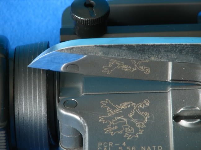

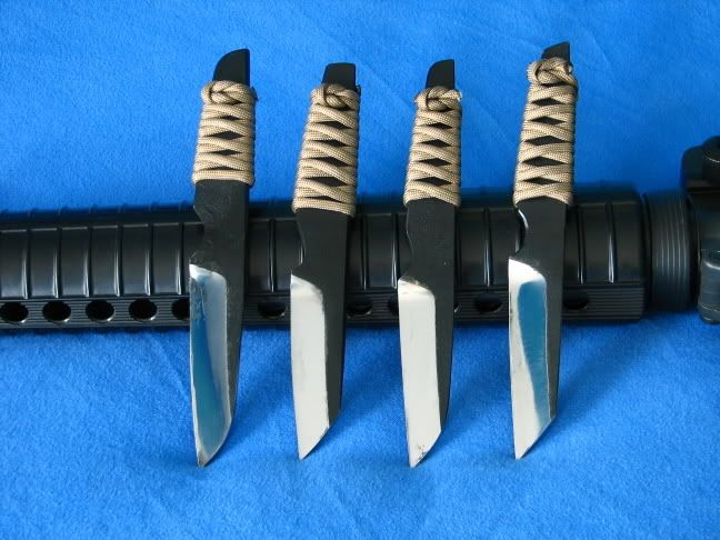

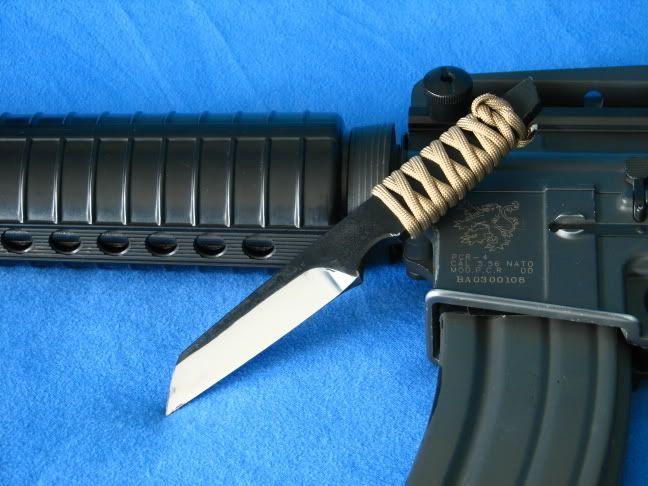

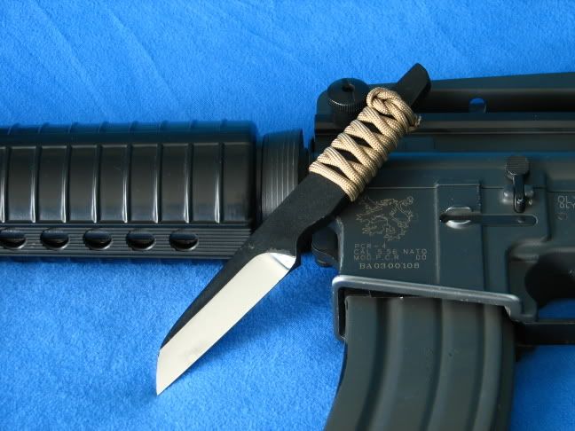

here are a few warncliffe knives that i made out of some flattened truck springs. these knives are great because you can stick them in you back poket and they wont pierce the poket..and there is no need for a sheath...they are a great size...right inbetween a pocket knife and a full blown belt knife. these were differentially heat treated and brine quenched...but the hammons wernt very pretty and i am still trying to figure out how to etch them any advice would be greatly appreciated.
Specs:
Length: 7-7 1/2"
Blade: 3"+
Steel: High carbon spring steel from a truck. Differentially heat treated in a Charcoal forge and tempered.
Thickness:1/4"
Finish: black with high polish blade
Handle: 550 para cord
$80 + shipping
please email me an let me know which knife you are interested in at Knifemaker87@gmail.com
Thanks for looking! please let me know if you want more pics of any of the knives
