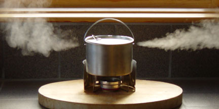

I'll probably be in the minority, but I am a convert to alcohol stoves.
There are designs that weigh mere ounces, to full fledged Trangia cooking systems. Beginners can try out alcohol cooking with a $10.00 Swedish milsurp.
Once you find out how cool it is to have a system where the fuel is relatively benign, available universally, operates silently, and doesn't suffer badly at all from all of the myths surrounding it, you may find yourself building a stove that amazes even the most jaded backpacker who has never seen it before--the penny alcohol stove, with simmer ring:
http://www.csun.edu/~mjurey/penny.html#
After I built a really well executed version of the penny stove and packed it along to play with, I dumped a Whisperlight with its greater weight and maintenance requirements.
Yeah alcohol is slower and cold prone, but the first is just a lifestyle change and the second is easily combated. With alcohol, if you want something boiling, you take two minutes, set up the stove and put on your water first. Then in total silence or against the ambient noise of nature, you set up the rest of camp. Easily before you are done, you have a roiling boil.
As for the cold, it is simplicity itself to use some tinder in the wind screen to heat the aluminum body of the stove to promote the evaporation of the alcohol.
The best part of ETOH stoves is that in the best triple use purpose ever, one can carry more expensive "drinking" fuel that will also make a fine disinfectant/pain killer in a first aid emergency. Try that with kero.:D
boats,
do you use that setup there because it looks interesting and something i would try how much is it for stand messkit and stove like that
and Pict
is that gamo pellet can just the can that you pour the alcohol into with holes drilled in the lid and do you screw the cap althe way on?

I use that stove, particularly in the summer, because it is small enough to fit in a day pack if I want to really rough it. I just take a small SIGG bottle with a screw top and put it in one of the bottle holsters on the pack as the fuel bottle, sling an aluminum pot from the daypack holding the stove and its components, and I am ready to go. In rougher conditions and later in the year, I pack a Trangia 25. If I go snow camping, I bring a Whisperlite.
The stove has cost me about three six packs of Heiniken in the required cans, the penny required for use as a pressure regulator, and about five hours of my time learning the crafting skills for making it through two abortion stoves and one really good one made on my third attempt. I don't really count the beer as an expense, since I would have bought some anyway. I guess I am out under a dollar in can deposits I didn't claim.
The materials for the stand and the windscreen were less than $8.00
I use an Open Country 2 quart non-stick "billy pot" that cost about $12.00 when I bought it three years ago. I put everything stove related in the pot except for the fuel, and it stays closed with two Velcro straps I sewed together to make a secure travel kit out of the pot.
