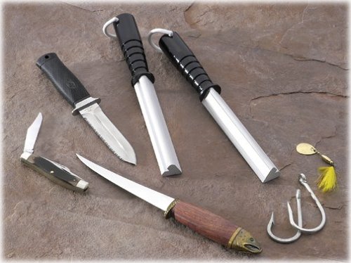

Ok so I wan't to know what you guys bring backpacking that helps you keep an edge on your knife. I also wan't to know what I should get, I need a steel. any recommendations? thanks- Josh.
personally i use the lansky diamond set and use the rods as a benchstone set, theyre light and its good practice to do it by hand
Steels are for cheap kitchen knives don't use them on your good blades.
For camping/backpacking sharpening tools many including myself like DMT diafolds. You also have, Fallkniven DC3 and 4, spyderco double stuff, ceramic rods, sandpaper, and pocket oil stones.
Personally I use a coarse/fine diafold and a ceramic rod. The ceramic is usually used first if the edge is just slightly dulled and the diafold is used if the knife has been put through extensive work and is duller than what the ceramic can repair.
I carried a Gatco Micro-X pocket sharpener. 1 oz with interchangable ceramic rods. Not as good as a oil stone, but good enough for a 'field' edge.

I have one very similar to this one which I find very useful. It has two levels of diamond grit, coarse and fine, and a ceramic surface which is good for polishing. It's pretty light weight yet large enough to handle sharpening a larger blade like a khukuri, which smaller sharpeners can't.

I use the red plastic Gatco thing pictured above.
