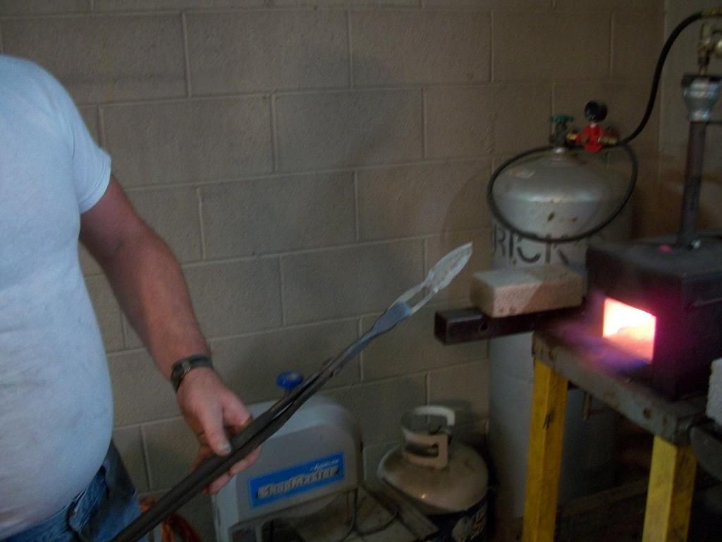

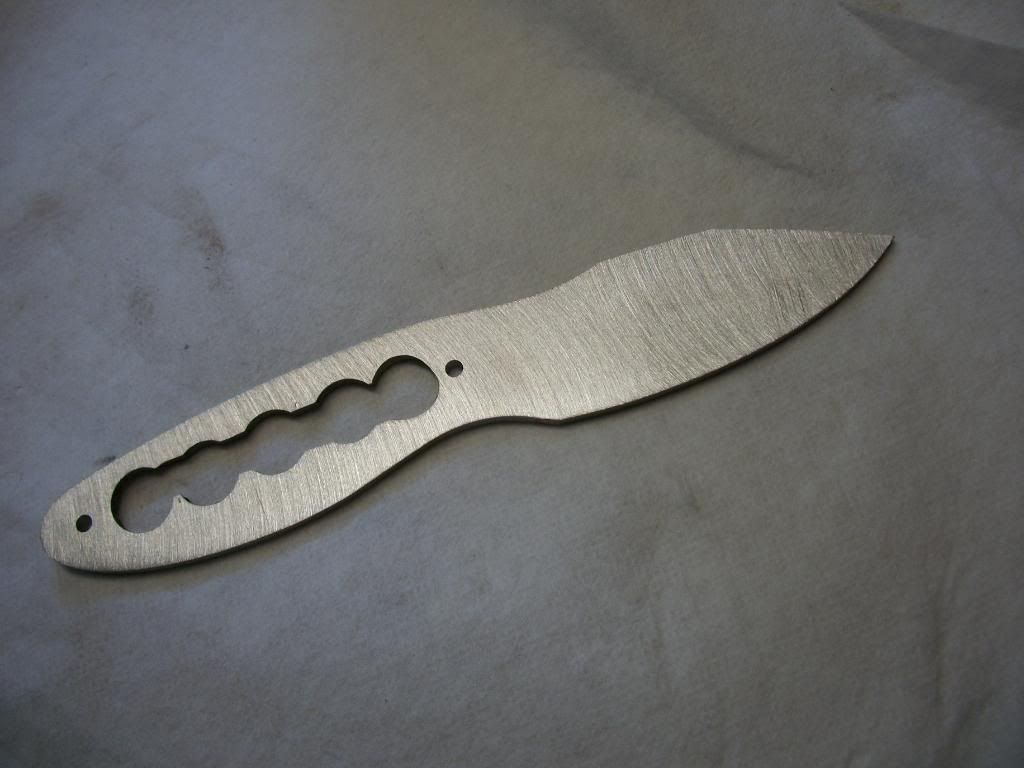

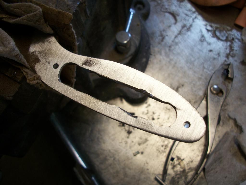

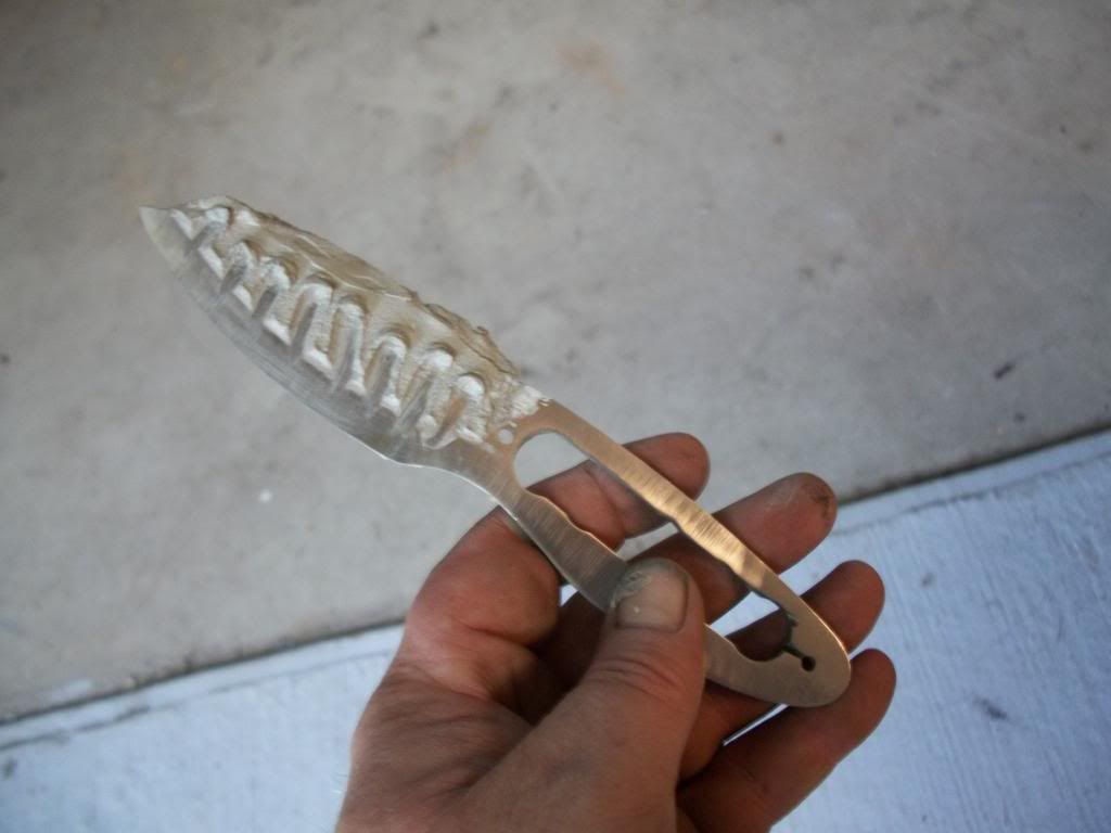

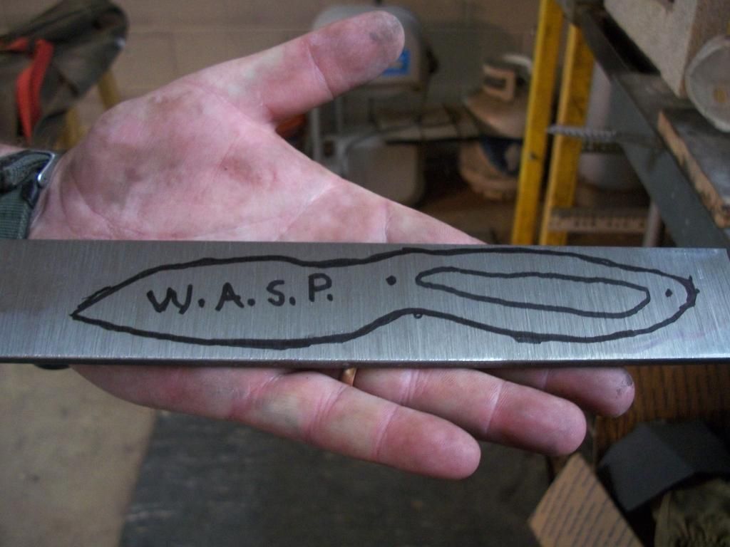

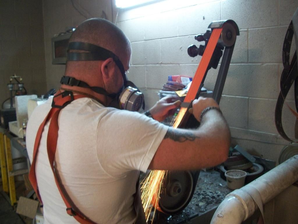

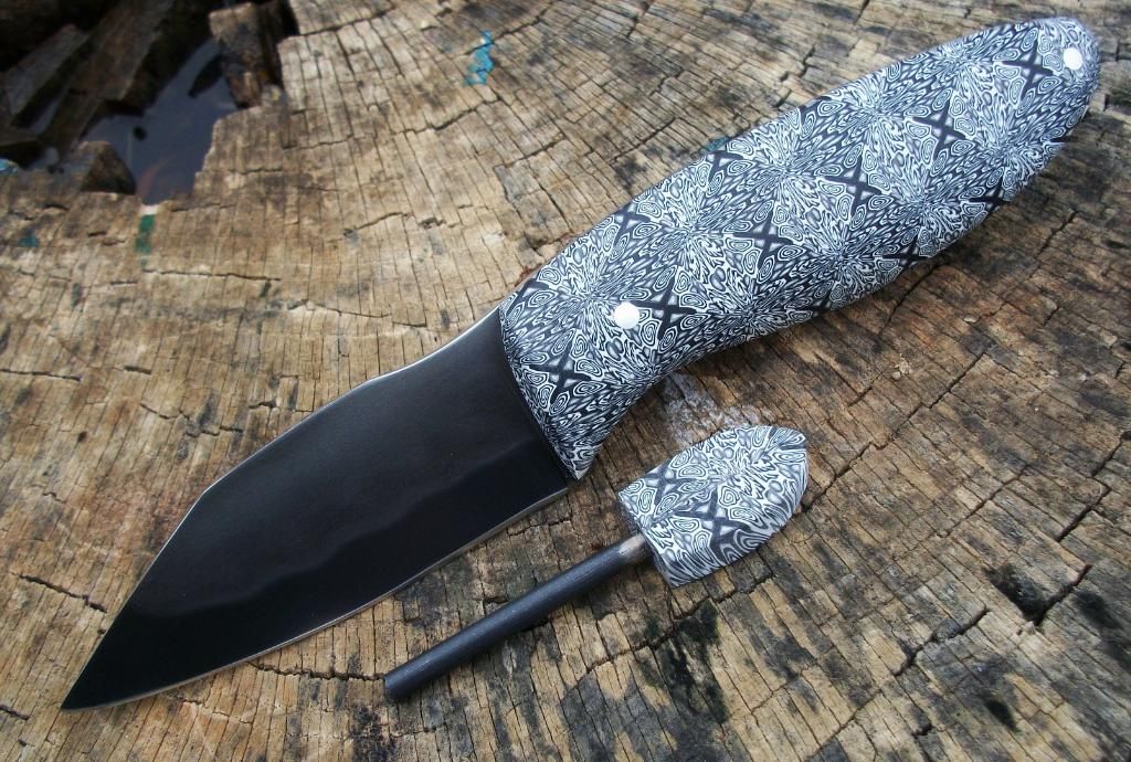

HERE WE GO AGAIN,I WANTED THIS KNIFE TO BE VERY LIGHT WEIGHT ,VERSITILE ,COMFY,IT ALL THAT AND MORE,THIS WAS A LITTLE OUT OF MY ORDINARY BUT WHAT CAN I SAY,SOMETIMES DIFFRENT IS GOOD, THE KNIFE HAS A THUMB DENTATION ON THE TOP FOR EASY COMFORTABLE CONTROL,JUST PAST THAT IT HAS A FLATTENED SPINE FOR PRECISE CUTTING USING YOUR INDEX FINGER TO REST UPON OR EVEN BATONING IF NEEDED,THEN STRAIGHT INTO A SPEAR POINT FOR PEIRCING ANYTHING YOU WOULD LIKE INCLUDING FLESH!! "RIVER WARRIOR" MARC HAD ALOT TO DO WITH THIS,SO PRAISE TO HIM!! AND HE IS A HELLOVA CAMERA GUY, THE KNIFE ONLY WEIGHS IN AT A WHOPPING 2 OZ , AT THIS POINT, MEASURES 6 3/4" W/ 2 3/4" BLADE, ALDO'S 1095 STEEL

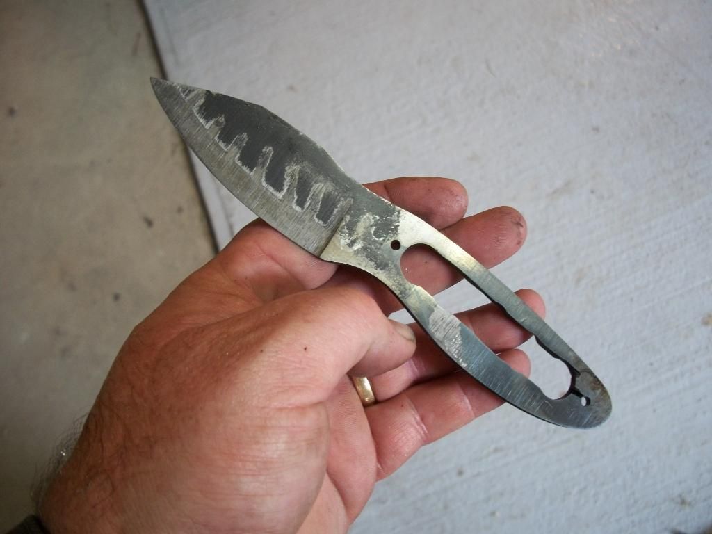

FIRST A CHICKEN SCRATCH PATTERN??

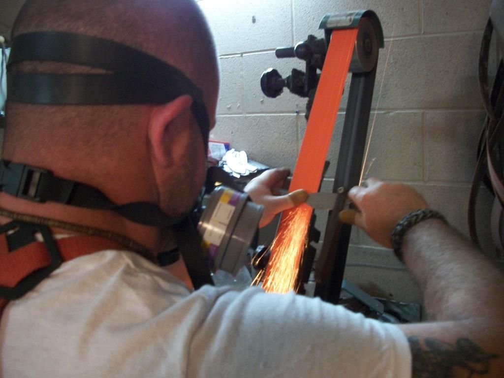

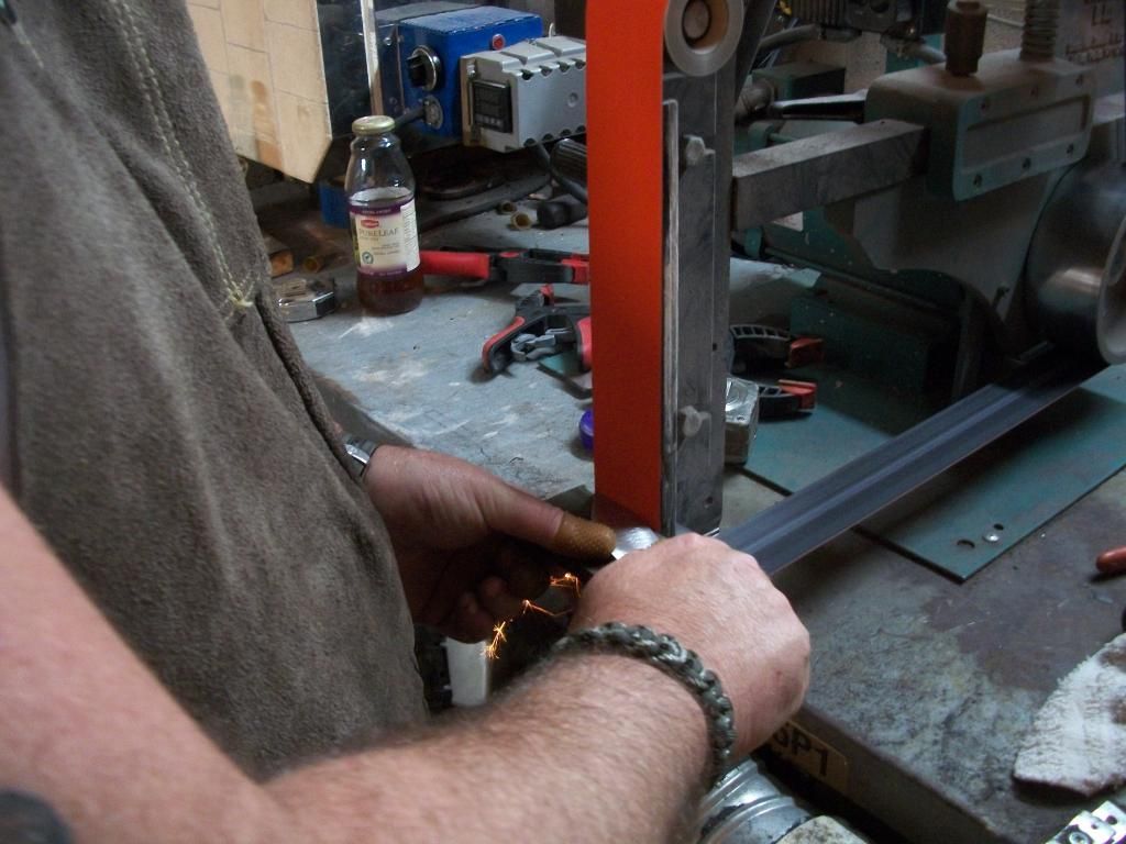

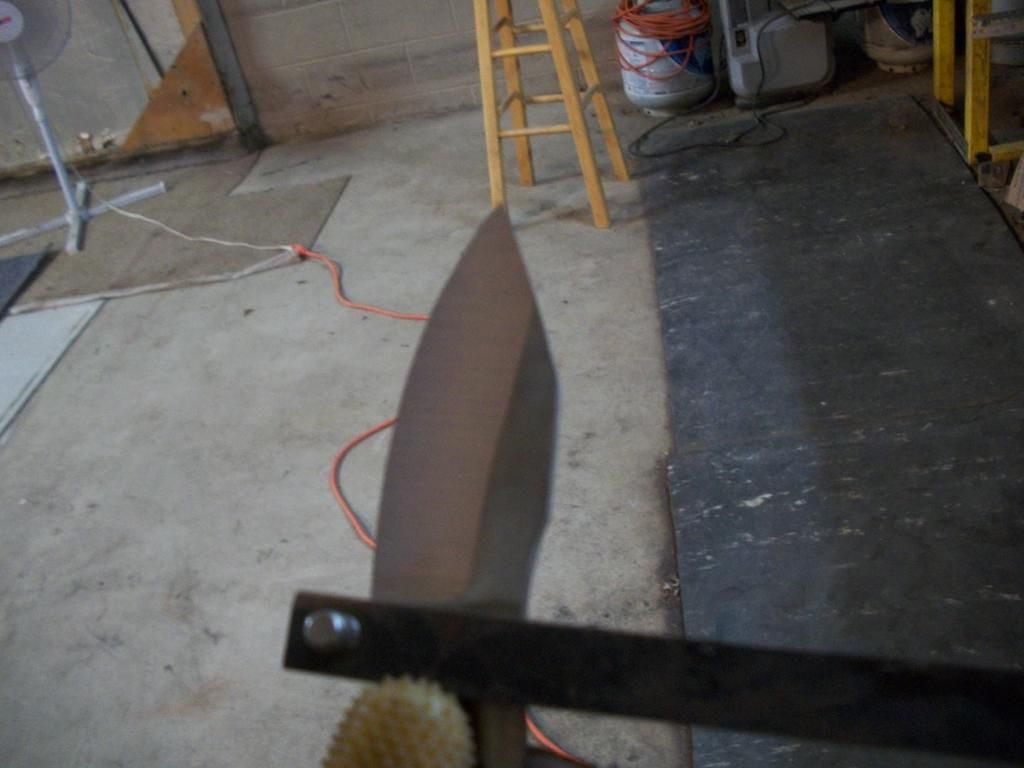

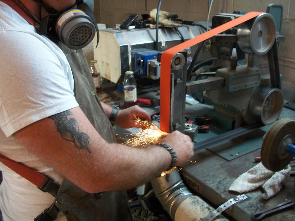

STOCK REMOVING

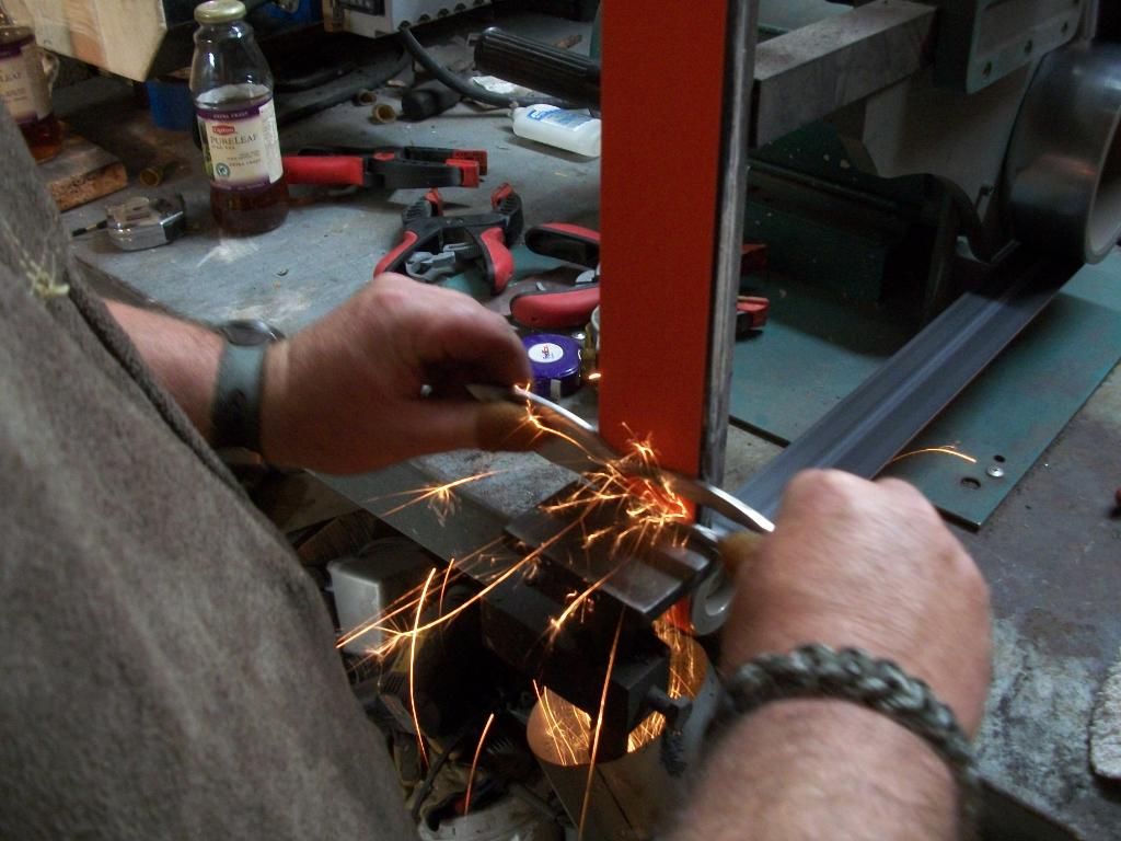

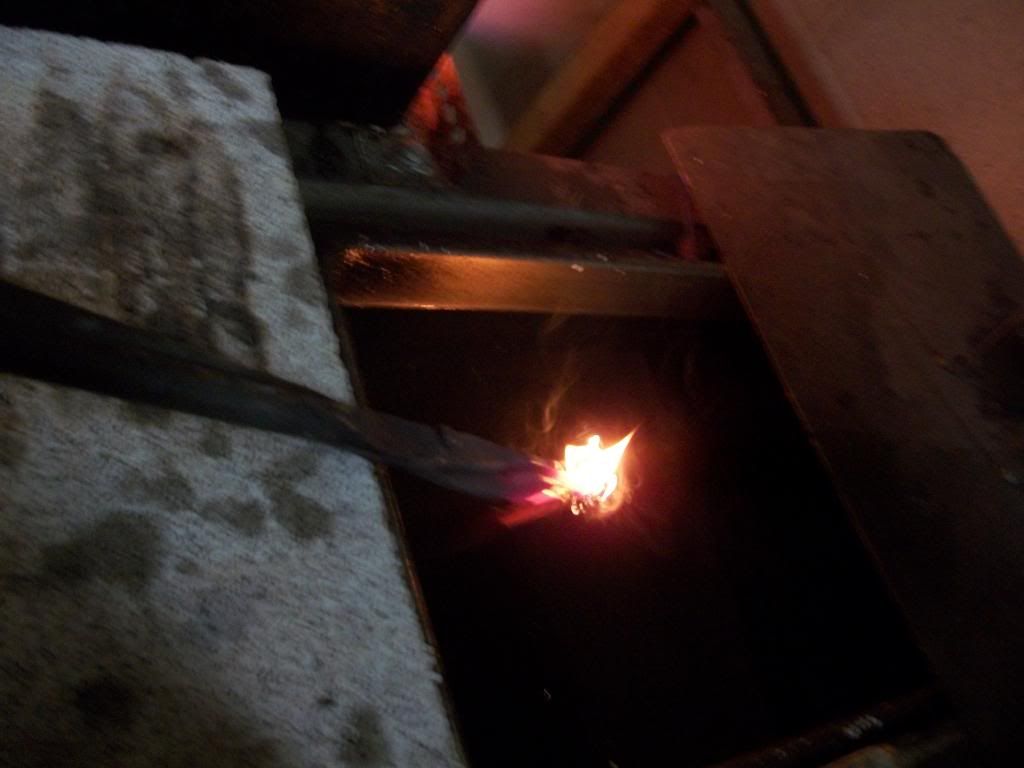

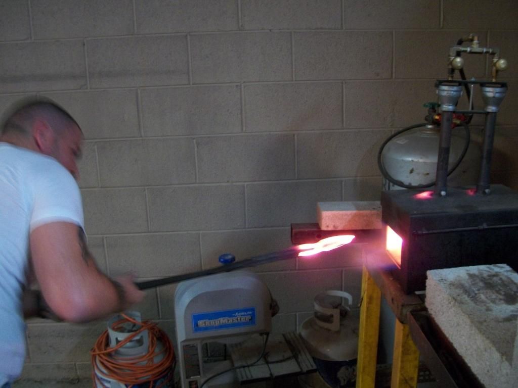

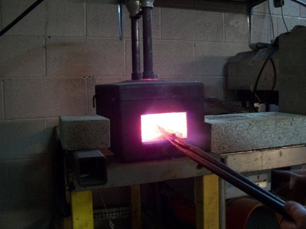

MAKING SURE EVERTHING IS SQUARE AND GRINDING AFTER NORMALIZING 3 TIMES IN THE FORGE

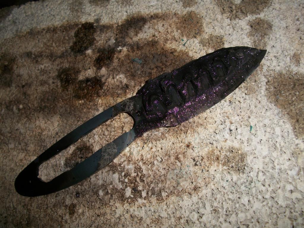

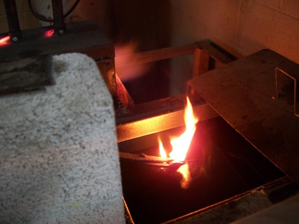

TIME FOR A CLAY COAT TO GET A NICE HAMON ON THE BLADE THEN IN TO THE FORGE AND INTO THE QUENCH

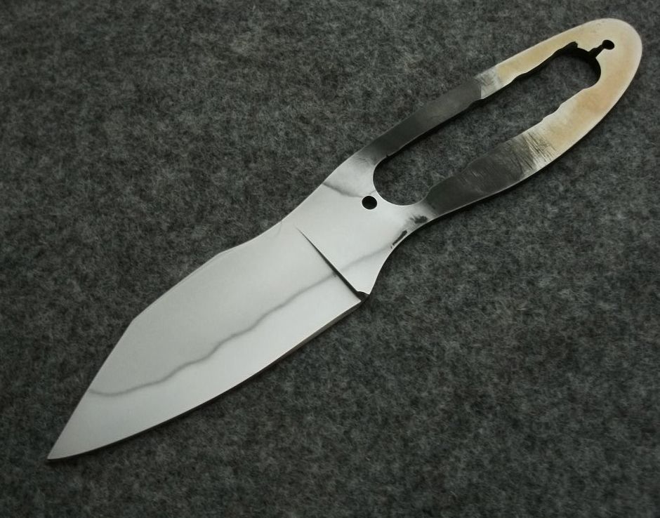

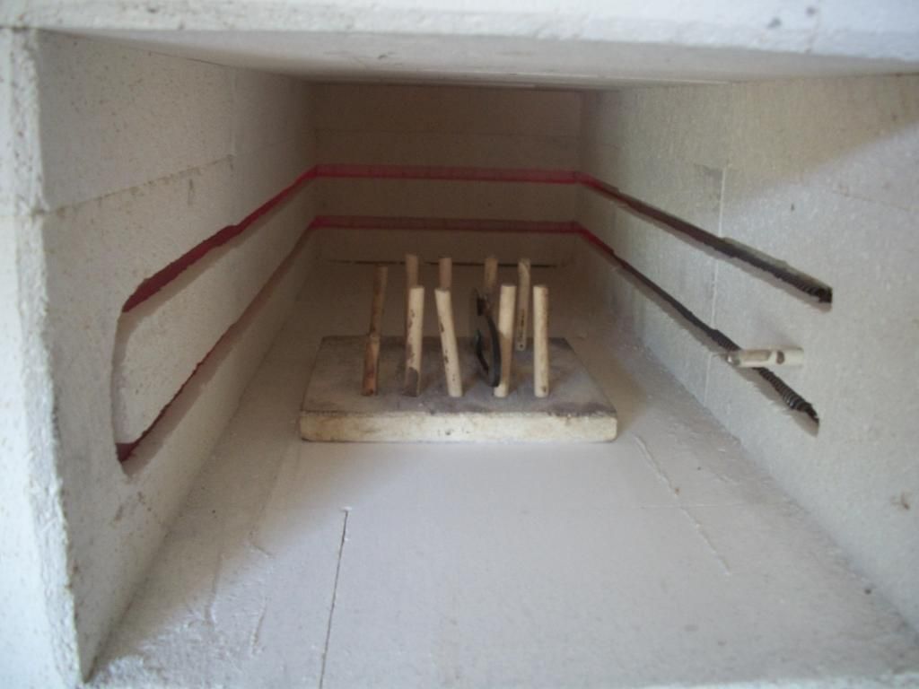

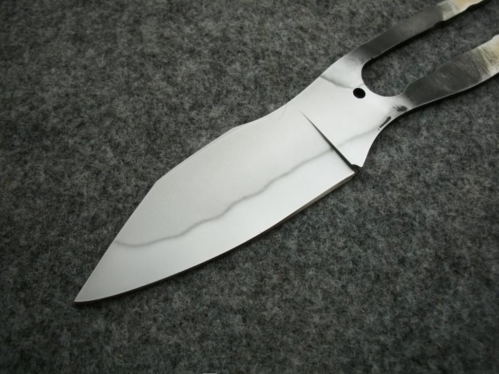

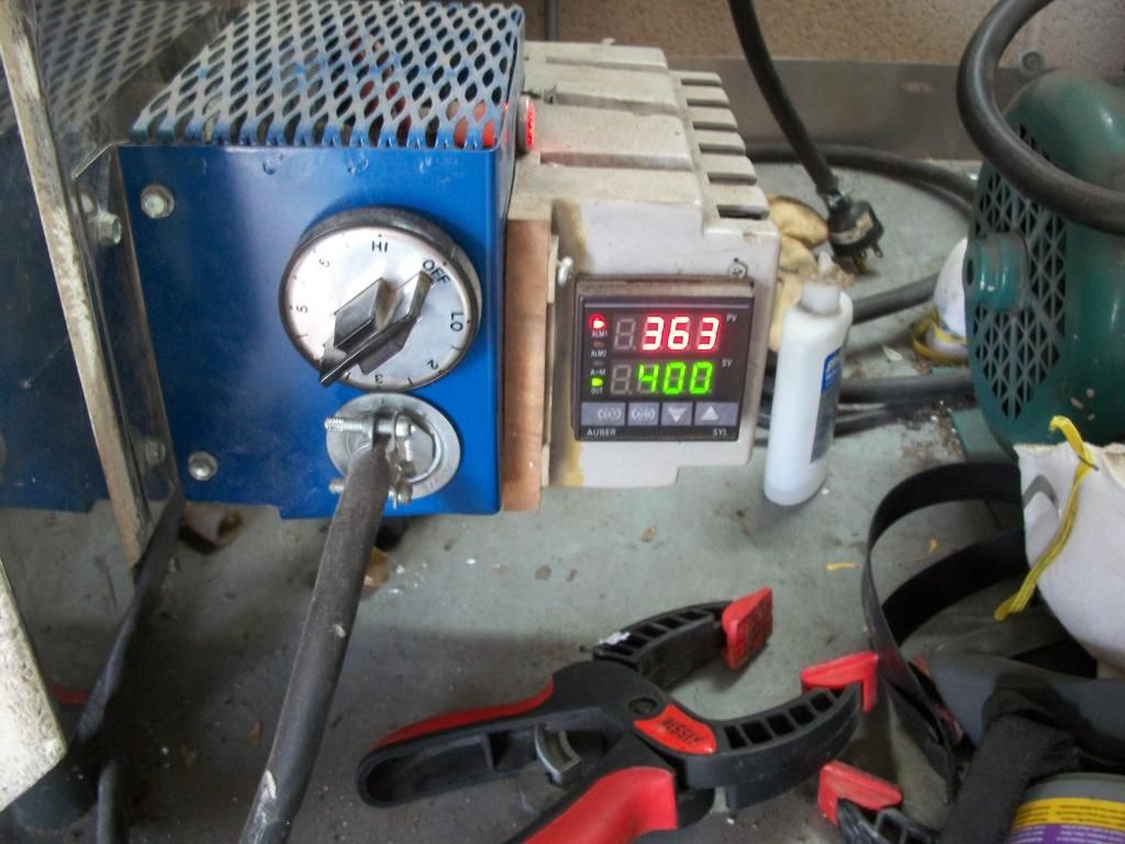

SANDING ,SANDING,AND MORE SANDING TO A MIRROR FINNISH BEFORE I GO INTO THE TEMPER OVEN FOR 2 CYCLES AT 400 DEGREES 1 HR EACH CYCLE
INTO THE KILN AND RAMPING UP TO TEMP

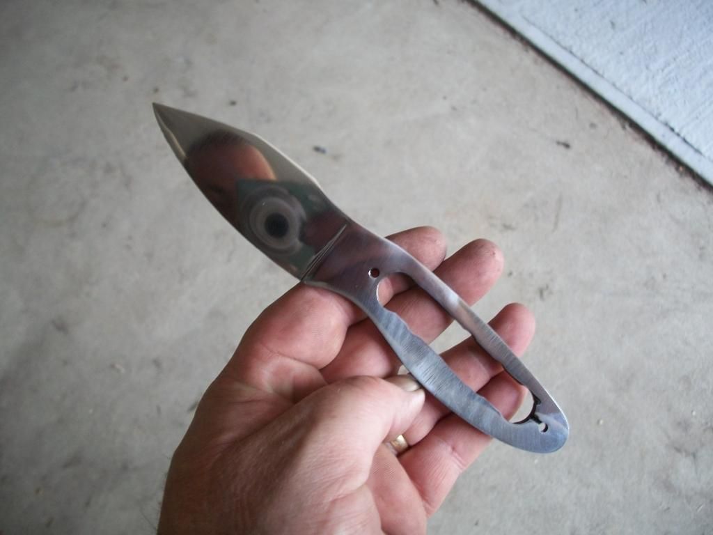

OUT OF THE TEMPER OVEN READY FOR ANOTHER SANDING UP TO 1500 GRIT AND A MIRROR POLISH THEN INTO THE ACID FOR A BATH,THEN OUT AND START SANDING AGAIN,THE BLADE SHOW THE ATTENTION TO DETAIL,GUYS THIS ISNT EASY !!HRS OF SANDING INVOLVED

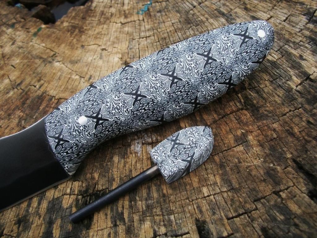

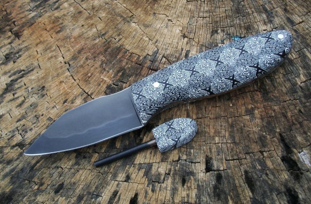

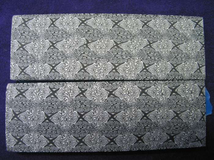

FINALLY ITS TIME FOR SCALES,HERE THEY ARE,PRETTY DAMN WICKED HUH!! VERY SOFT AND COMFY ASWELL AS GRIPPY IN THE HAND,THEY WILL BE HERE TUES THE KNIFE WILL BE FINNISHED AND READY FOR A SHEATH
:D
THE KNIFE ENDED UP WEIGHING 3.4 OZ AFTER ITS COMPLETE, I WENT AND REFINNISHED THE BLADE TO A REAL DARK ETCHED BLADE TO CONTRAST BETTER WITH THE SCALES, MARC WILL BE POSTING MORE PICS LATER THIS EVE

I'm really glad the pictures turned out well. I thought I was gonna have to request "hazardous duty" pay with all the fire, smoke, and sparks flyin' around the shop :D Hopefully the scales will arrive on Tuesday.
I've always had the view of a necker as a tool that may just save your butt if you end up, for whatever reason, losing the rest of your gear/equipment. With that in mind, I always liked the idea of a comfy thumb rest in case one has to do chores/tasks with the blade for an extended time. Also, as Bill has mentioned, the squared spine section can be used to place the index finger for more controlled/precision use of the blade, or even to baton smaller pieces of wood if needed.
I can hear the orders for the Backwoods and KFU neckers coming in now. LOL. Great work Bill,
it may be outside your "norm" but it's looking good to me. What are the scales made of, don't think
I've seen that material before. Great job on the pics Riverwarrior.
