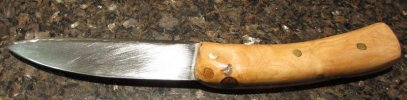

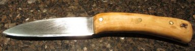

Today I finished a 115mm (~4.5") 1mm thick fixed blade. Olive wood handle (yep, a small curve branch I trimmed 18mos ago) with 2 coats of tung oil. Sharpened around 30* inclusive angle. It served kitchen choppery duty this evening. Hacked vegies and 2 game hens into 0.5" pieces through bones for a salty ginger dish. It stays sharp & no dings from bones. Took these pictures after dinner.
