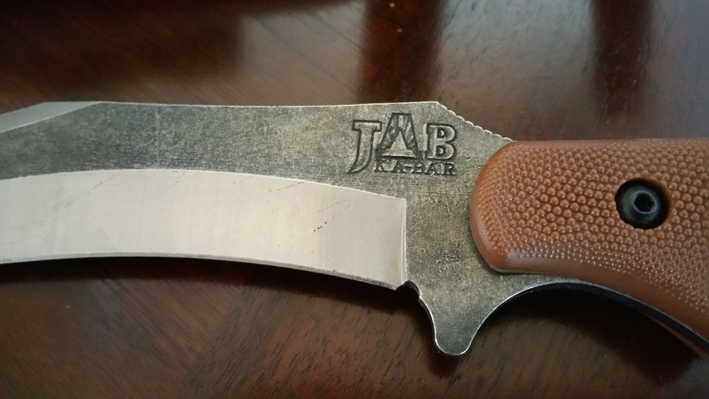

So this weekend I pulled the scales on my Baconmaker and sprayed it down with the aerosol version of Citristrip. I sprayed it about 7:30 last night and this morning about 8:00am I checked on it. All the coating was bubbled up and came off in a sheet. All I had to do was rinse it and use a dental pick to clean the lettering out a bit.
The interesting thing was that where they had ground the concave of the blade at the factory the stripper chemicals didn't form a patina leaving a nice two tone look. All I've done for these pics is wipe it down really.
What do you think?

When I stripped my ZK Famine, it did a pretty similar two-tone look:
I think it's just because the unground part has a more "pours" surface which takes the patina more since the solution settles into the little pockmarks and other "imperfections" easier.
Anyways, I personally really like the look. It makes the blade appear more "gritty".
Orezona, that's a good looking famine. I agree with your analysis of why the patina only takes in some areas. :thumbup:
