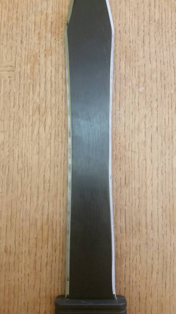

I received a Gladius machete over a month ago with a horrible grind. The edge is extremely dull and uneven. I sent the pictures to Cold Steels customer service right after I received it and have yet to get an answer back from them about what they plan to do to fix this problem. What has your guys experience been with the grinds on Cold Steels machetes? Share your experiences with Cold Steels customer service.
Check out the right side edge
Yikes that's bad! Looks like someone was farting around in the garage with a lawnmower blade.
I've never had a machete come with a decent edge.

Alao, I agree that bevel is off, and I might consider sending it back. Or I might just finish it up on my belt sander and use it like the $25 beater it is.
To the poster somewhere up above, i never said you needed a belt sander to fix the edge, i just happen to already own one so thats what i used. Before i had the belt sander i just used a file to fix these kind of problems. A file is a slower but it gets the job done at no great expense. :)

I just don't get why you're so unhappy with Cold Steel for this. Machetes around the world are sold unsharpened, with only a very few exceptions like Condor or Ka-bar(both of which will cost you 2-3x as much as a CS machete) or customs(which will cost you a lot more than a Condor/Ka-bar will). It's not like you're gonna get a sharper machete buying Imacasa, Tramontina, Hansa, Ontario, Bellotto... I mean, I could understand the unhappiness if most machete companies sharpened their machetes, but, traditionally, machetes aren't sold sharpened, which means from most companies, you're going to get a dull machete.
^ its the marketing. it tricks many people. we expect companies to be honest and take one right off the line and do their testing. what they don't show us is all the time they spent putting the edge on and resharpening between tasks,etc. before filming slashing and chopping, etc. while their marketing sells more steel, it backfires when one isn't familiar with decades of use and various makes and models of machetes and understands that the somewhat low dollars paid means you have to finish the edge yourself to match the work needed. although in fairness cold steel ain't exactly cheap compared to imacasa , tram, etc. maybe cheaper than finished product like condor, but still......

This is certainly not normal and it is not acceptable.
Our machetes are hand-sharpened right here at CS HQ, and it looks like something slipped through our QC
Please accept our sincere apologies. Send me a PM with your contact info and I'll send you a replacement straight away.

I have already been in contact with customer service and a replacement is on its way. I have to tell you though, I love your company for what it produces. Everything I've bought from your company has been top notch EXPECT for the grinds on the machetes. You should look in to what is going on with the grinding and maybe give some extra training there. It seems like I'm not the only one experiencing the same problem. It's as if it's expected when you order a Cold Steel Machete it's going to have a bad grind, and I know that's not what your company wants to put out.

I got the replacement in today and I must say this will be the last time I purchase a Cold Steel machete. The grinds are straighter this time but the edge is no where near finished. Massive burrs and not the same thickness throughout. I will put my own edge on this one, but I'm will not spend other dime on another until I hear their quality has improved.
