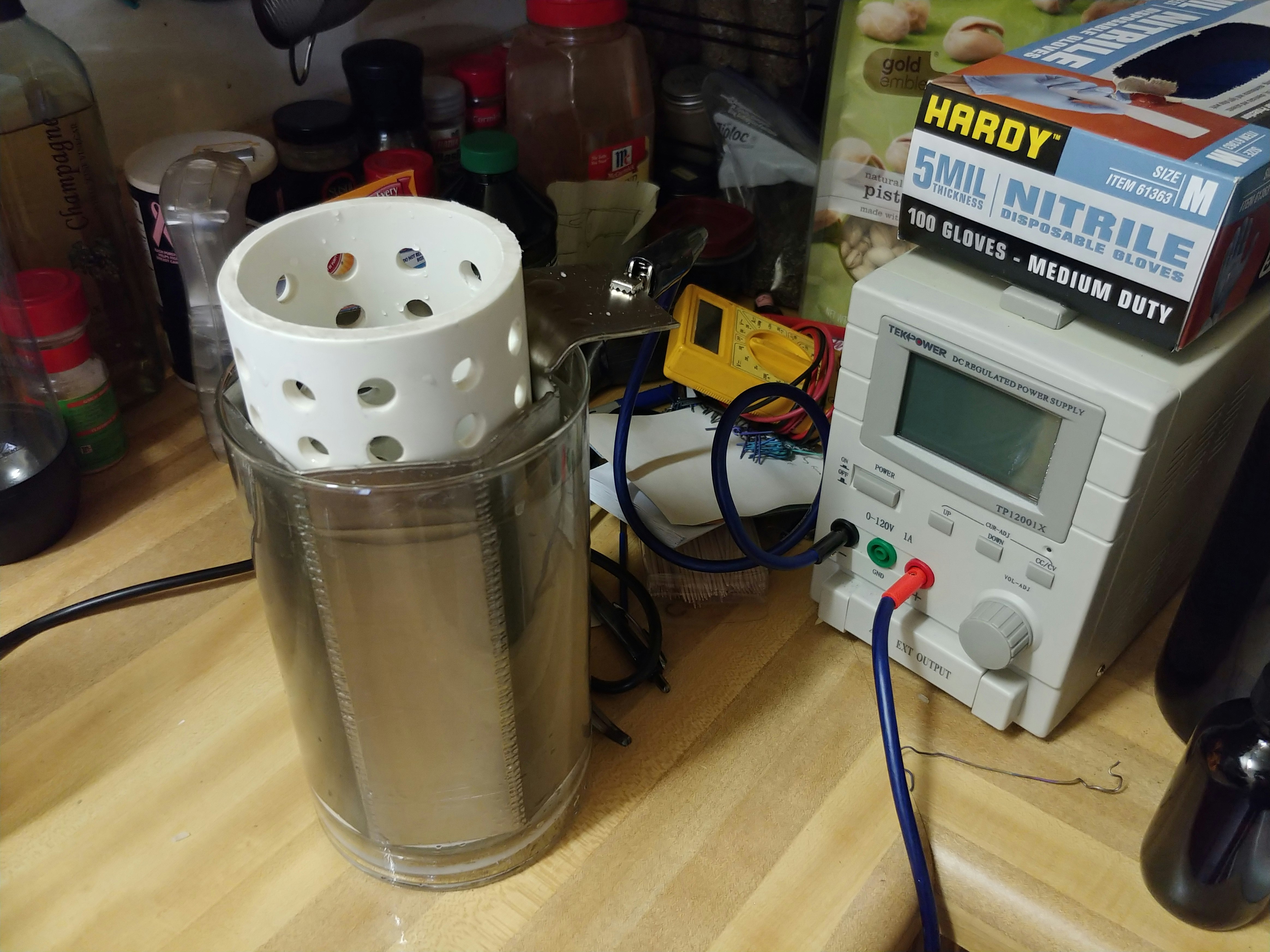

He is using the steel bowl as the cathode. Very similar to my setup. Can work pretty well. I think the only thing better would be a large titanium plate, but not needed for a basic hobby setup.
There is a guy over on the Drop forum that created a tank with a solid Titanium plate. Bent into a hex shape, placed into a glass enclosure, with a heavy perforated pipe for separation. He has been doing some very interesting work. And continuously experimenting with application/texture/finishes, etc.

I bought a second power supply to test out, if my power supply is the problem. It is the same power supply that you see in the photos from the Drop Forum (120V, 1A). Today I started testing and I did not see a difference. So the power supply should not be the problem.
