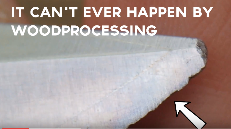

She really thinned the edge out?! That would explain the crazy damage...
I missed the poster you quoted earlier...
When did she say she thinned out the edge? She talked a lot about the edge geometry but I don't think she touched the edge ever, which was part of the problem...

That is what I thought. It is important when we are being critical of a review we get the basic facts correct.
Like I said in the other thread on this subject, she should have sharpened it a couple times to get past the factory edge. It may not have chipped so bad. This is a well known thing with falk can be true for other brands.
I was thinking about that too (sharpening away the factory edge, a la Mora, etc.). Hopefully she'll sharpen away the damage and give it another try in the future. :thumbsup:

This is more than microchipping IMO. I've personally beat the hell out of my A1, batoning all sorts of wood without a singe tiny chip.
Giving the knife a "bad review" because it didn't held up being smacked against rocks just isn't fair at all.
Problem is that she used the factory edge. She should have known that a few sharpenings are required before any reasonable assessment can be made on edge performance. But I like her. Her accent is cute.
Nah, she used it like a cold chisel then complained about the edge??
That's not how that works
Watch her island video, she batoned it with rocks, scraped the edge on the fire steel and used the edge to scrap food off rocks buried the edge into the dirt. Of course it's going to chip.
In here cold steel SRK video she doesn't abuse it like this.
